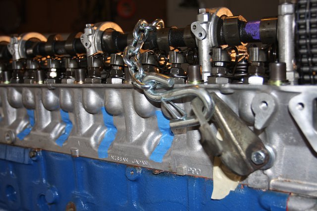

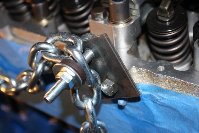

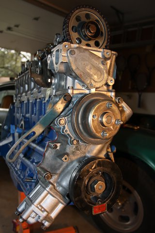

  8. Making some progress. I've installed the front cover, water pump, damper and turbo oil pump. Since the Damper has the timing marks on the opposite side I filed down my own TDC mark. I had one engine lift hook and fab'd a second one. Took some pretty thick steel I had laying around, drilled one hole for mounting to the head and another to run a M10 bolt through for lifting. Tony D provided great direction regarding using eye bolts but Granger was closed on Sunday and proceeded this direction. Next up is the Centerforce clutch. Took the flywheel to the machine shop and checked out fine.

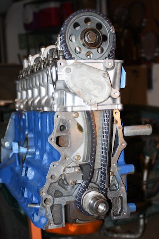

  12. I'm installing a new timing gear set even though my old one still looked good. The "How to Rebuild.." book mentions a gasket for the chain tensioning housing which was not in my gasket set so I made one from cork. No big deal. Next up is the front cover and Damper.

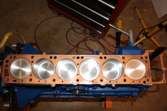

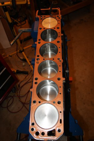

  13. After getting the damper issue straight I sprayed the .8mm metal head gasket with Copper Coat, let it get tacky, installed the head dowels and bolted up!!

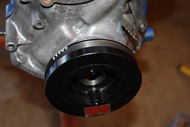

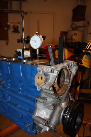

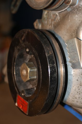

  14. Well the Holiday's offered up additional time to work on the project. I confirmed TDC with a dial indicator since I was installing a new Damper. Like some people have experienced, the damper is a bit tight. .001" of clearance. Jeez...I spent plenty of time sanding the damper bore down. Not to mention the timing marks are set on the opposite side. I believe the L4 engines have timing on that side but you would think MSA would have both styles.
  15. I have a two row Damper you can have for shipping cost. steve
  16. Yeah, I got it on about 75% and marked the damper for TDC. I lightly sanded the damper bore with 300 grit...FWIW... then used a block of wood and rubber mallet to get to 75% so I could mark the damper and then remove with too much drama.
  17. I bought the Powerforce Dampner from MSA. It states the following: Special Note: For 240Z & 260Z, since they have non-adjustable timing pointers, the timing markings on this pulley will be shifted. You will need to match and note the relation of the pulley marks to your original pulley when you remove it. Do the 280z and or ZX have the timing marks on the left side of the front cover? Or just the ZX? The front cover I'm using is from a 280... pic here. Also, it is very tight. Normal to use a rubber mallet to fully seat? I'm measuring just .003" larger than the crank.

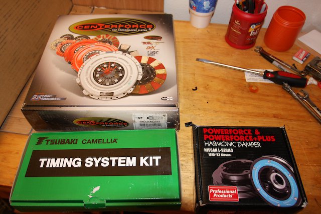

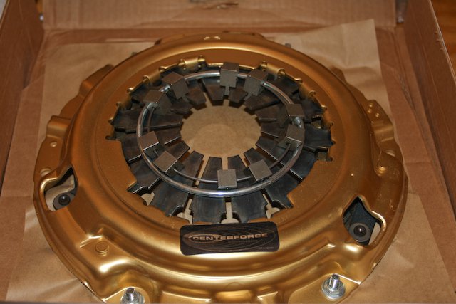

  20. After buying a bunch of parts from MSA...Among others I'll be installing a Centerforce Clutch, single row damper and new timing gear (Cool Japanese box btw).

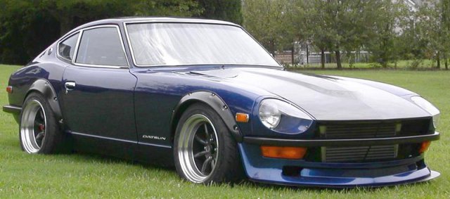

  22. After the engine work is done, my end result which I'm shooting for is something like this: Love this stance.... I'd buy this car if I could. Or the Green one. Love the chrome.

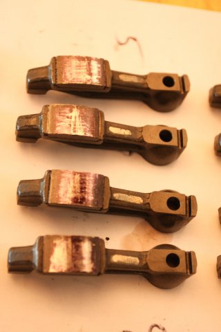

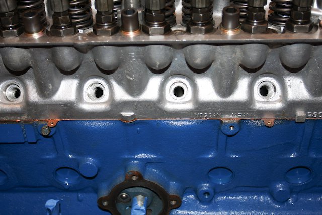

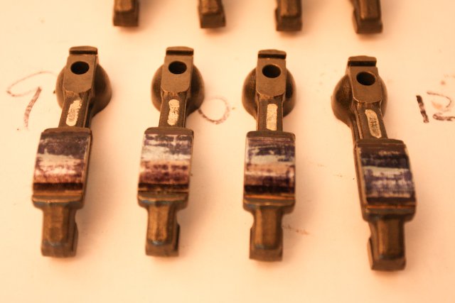

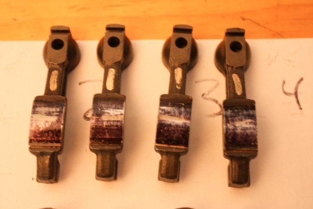

  23. After getting the head back I checked the wipe pattern on all lash pads. All are centered. Not all are 100% the same but 9 are nearly identical and 3 vary slightly...Not much. Instead of perfectly centered they are about 55/45.
