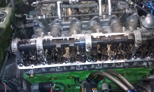

duragg Posted May 30, 2012 Author Share Posted May 30, 2012 (edited) Started a pre-hibernation inspection today. Too darn hot to drive this thing in summer. Pulled plugs; Just don't think I could ask for better than this from Triple Webers. Pulled cover and the cam looks the same as when I installed. Valves were right where I left them last time. Finally decided on the last few things I want to do to the car. Pull motor, replace rear main seal that drips a tiny bit, Install Arizona Zcar superlight flywheel. FInd a Vo7 crank and do that whole diddy Get a really stupid cam like I wanted to begin with Fix that thing I will never admit to with the front pulley Get MS3 with GSXR750 ITBs running. Open tranny and have a heart to heart with my rebuild Fix D/S leak Get R/T front diffy mount and melt down that horrendous ArizonaZcar solid mount. 280z 27 spline stubs Coilovers with Tokico Adjustables. Toyota fronts / Maxima rears GroupBuy wheels painted flat black with 275 rear Chop and stab ZGs Carpet inside Wire hour meter Fix Wideband Wake up. Edited May 30, 2012 by duragg Quote Link to comment Share on other sites More sharing options...
