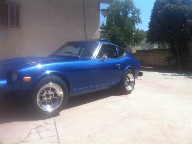

stony Posted September 17, 2012 Share Posted September 17, 2012 Pretty sure i know and that it has already been posted but please post the specs on your wheels and tires ;> Quote Link to comment Share on other sites More sharing options...
pleadingbark Posted September 17, 2012 Share Posted September 17, 2012 Pretty sure i know and that it has already been posted but please post the specs on your wheels and tires ;> 15x9 0 offset 205/50/15 Quote Link to comment Share on other sites More sharing options...
SUNNY Z Posted September 17, 2012 Share Posted September 17, 2012 15x9 0 offset 205/50/15 You couldn't stretch anything smaller? Quote Link to comment Share on other sites More sharing options...
pleadingbark Posted September 17, 2012 Share Posted September 17, 2012 You couldn't stretch anything smaller? I could have, but I didnt see a reason to. Quote Link to comment Share on other sites More sharing options...

miky360 Posted October 14, 2012 Share Posted October 14, 2012 Here's the fitment with a 205 and a 20mm spacer in the rear. From up top... Would you say the spacers are needed or I could grab a set of Hayashis 15x9-18 and get close to the same fitment? Quote Link to comment Share on other sites More sharing options...
tapioka Posted November 19, 2012 Share Posted November 19, 2012 (edited) finally got them. here you go. 15x9 all around. had to roll fenders a bit Edited November 19, 2012 by tapioka Quote Link to comment Share on other sites More sharing options...
lowrider Posted November 19, 2012 Share Posted November 19, 2012 finally got them. here you go. 15x9 all around. had to roll fenders a bit What size tire and what suspension are you running? I plan on purchasing these wheels come tax time! Quote Link to comment Share on other sites More sharing options...
tapioka Posted November 19, 2012 Share Posted November 19, 2012 they are 225/60/15. If you do get them, make sure you get a 5mm or higher spacers in the front because the base that the spring sit on literally shaved the inside of the tire. Quote Link to comment Share on other sites More sharing options...
lowrider Posted November 19, 2012 Share Posted November 19, 2012 So your running the stock spring perches? Quote Link to comment Share on other sites More sharing options...
tapioka Posted November 20, 2012 Share Posted November 20, 2012 Sorry, I thought I typed down. Yes I'm on stock suspension . Maybe planning to get blues with eibach springs. Quote Link to comment Share on other sites More sharing options...
EnthZ Posted December 5, 2012 Share Posted December 5, 2012 Sorry, I thought I typed down. Yes I'm on stock suspension . Maybe planning to get blues with eibach springs. Ok, So just confirming it all to see If I can go this route You are running completely stock suspension and you have now 225/60/15 on 15x9 +0 All that is required is rolling/pulling all 4 fenders and then adding +5 or higher spacers to the front? Do you have any rubbing after this? Thanks Quote Link to comment Share on other sites More sharing options...
