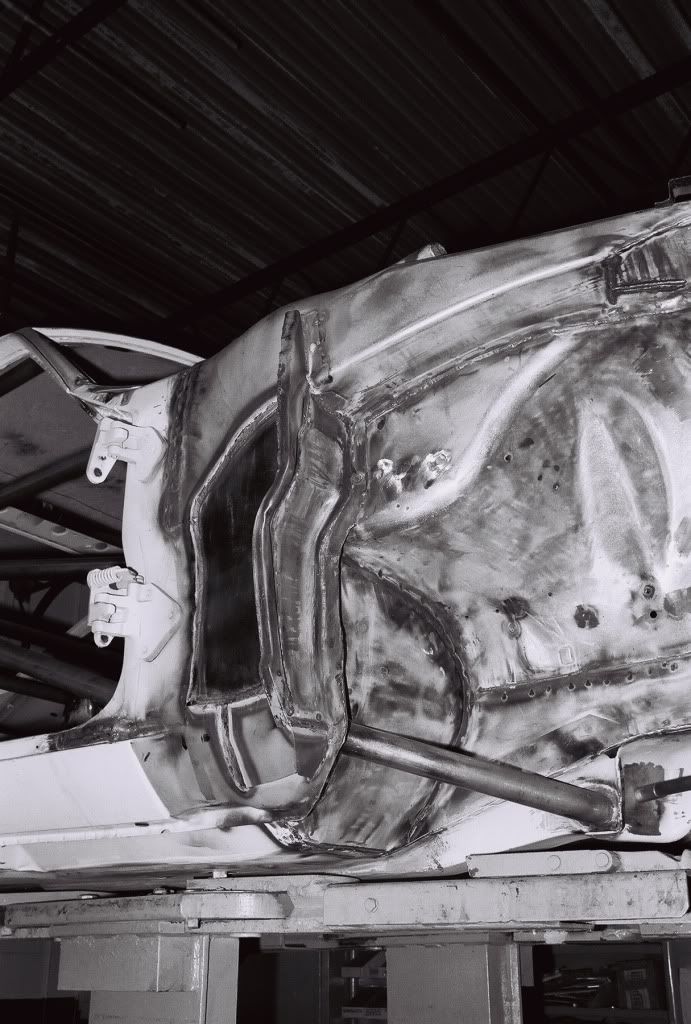

RB240zDET Posted November 7, 2011 Share Posted November 7, 2011 On 10/31/2011 at 3:30 PM, zero said: I was reading one of the project builds on MotoIQ today, and one of products they installed on their project s2000 caught my eye. It is an upper front subframe brace. Bolting to thick metal of the door mounts and reaching forward to the strut towers, I'd imagine something like this could add some substantial stiffness to our cars, especially if tied into the rockers and used in conjunction with something like the rocker to TC brace pictured below. If done well, I think this could resist some of the 'hinge' action of the rocker to firewall connection, allowing the rockers to do their job a bit better Anyone have thoughts on this? Like this? Quote Link to comment Share on other sites More sharing options...
zero Posted November 7, 2011 Share Posted November 7, 2011 Exactly! How much of a bend did you have to do there? Quote Link to comment Share on other sites More sharing options...
RB240zDET Posted November 7, 2011 Share Posted November 7, 2011 About 5-10 degrees. Check my build thread for other pictures... Quote Link to comment Share on other sites More sharing options...
bjhines Posted November 8, 2011 Share Posted November 8, 2011 Yes.. Like that.. But I put the tube into the firewall sheet metal and I used a wrap around plate on the upper frame horns. The cage makes a continuous brace from front to rear strut towers. Quote Link to comment Share on other sites More sharing options...

RB240zDET Posted November 21, 2011 Share Posted November 21, 2011 I went away with the stock frame and all the internal metal and made all new frames and trans tunnel. I went from each inside of the front rocker and rear rockers and tied each side to each other.....I will let the pictures do the talking... Quote Link to comment Share on other sites More sharing options...
zero Posted November 21, 2011 Share Posted November 21, 2011 Well that might be just a little stiffer than stock, haha. Awesome work, though that's a bit closer to fabricating a chassis rather than reinforcing one. Quote Link to comment Share on other sites More sharing options...
