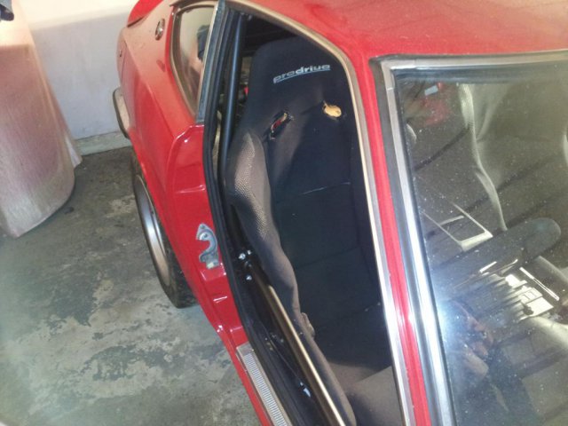

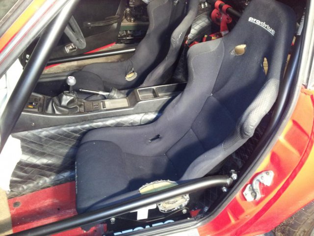

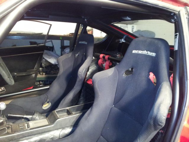

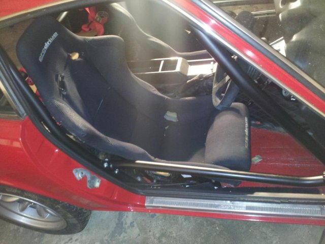

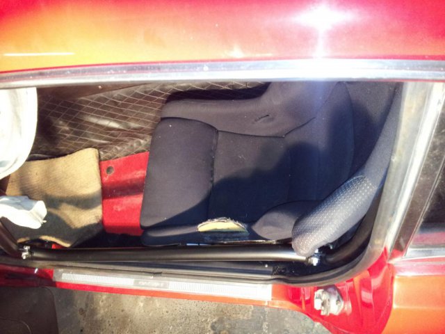

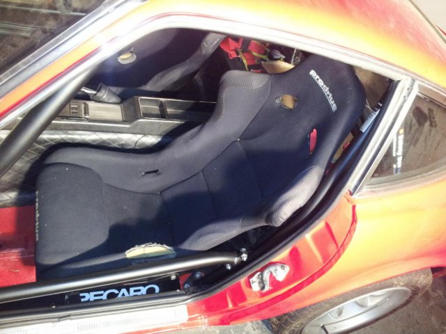

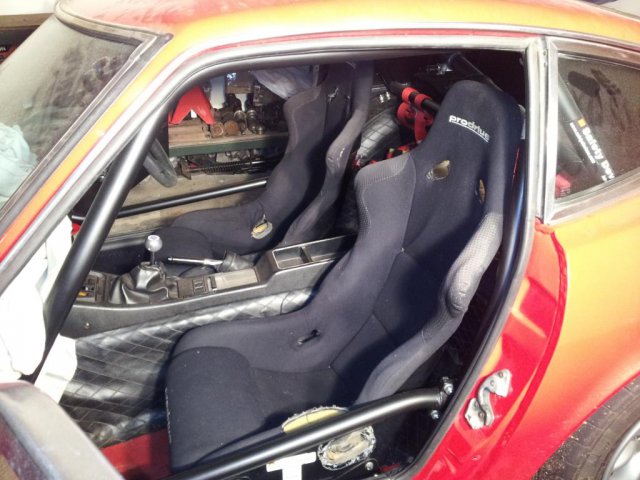

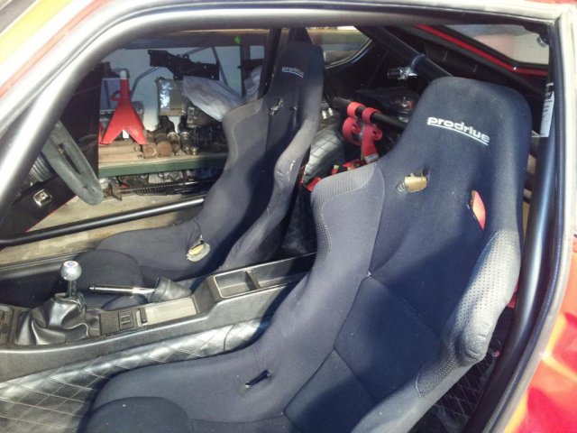

zbloke Posted December 29, 2013 Share Posted December 29, 2013 Firstly, apologies for dragging an old thread back up. But I can confirm that Recaro Profi SPG, normal width...not the 35mm wider version, will fit in a 240Z I've modded the OEM seat mounts to sit them lower in the car and used the Recaro side mount frames Happy to post pics if anyone is interested Quote Link to comment Share on other sites More sharing options...
Nelsonian Posted December 29, 2013 Share Posted December 29, 2013 Let's have a look then. Quote Link to comment Share on other sites More sharing options...

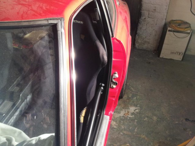

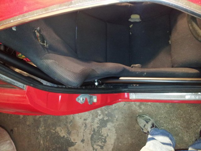

zbloke Posted January 1, 2014 Share Posted January 1, 2014 Let's have a look then. Here ya go.... In an effort to get the drivers seat as central as possible to the steering wheel the outer shoulder bolster does rub on the door card, if this becomes an issue I might move the seat mounts to the left a little, even so I'm much happier as my head is now 2" further away from the roll cage........passenger side outer shoulder bolster just clears the door card When I'm finished I've got some new seat covers to go on the shells I'll get pics of the modded seat mounts over the weekend, basically all that's been done is cut the rear ones down and make U shaped dropped sections in the front mounts Quote Link to comment Share on other sites More sharing options...
Leon Posted January 1, 2014 Share Posted January 1, 2014 Very nice, looks like they sit nice and low in the car. Looking forward to pics of seat mount modifications. Quote Link to comment Share on other sites More sharing options...
surfer.tech Posted January 4, 2014 Share Posted January 4, 2014 Here ya go.... 20140101_170509.jpg20140101_170453.jpg20140101_170519.jpg20140101_170526.jpg20140101_170536.jpg20140101_170546.jpg20140101_170654.jpg20140101_170716.jpg20140101_170827.jpg20140101_170838.jpg In an effort to get the drivers seat as central as possible to the steering wheel the outer shoulder bolster does rub on the door card, if this becomes an issue I might move the seat mounts to the left a little, even so I'm much happier as my head is now 2" further away from the roll cage........passenger side outer shoulder bolster just clears the door card When I'm finished I've got some new seat covers to go on the shells I'll get pics of the modded seat mounts over the weekend, basically all that's been done is cut the rear ones down and make U shaped dropped sections in the front mounts nice prodrive seats! You can also use Bride seat rails. That should solve the offset of the seat. Quote Link to comment Share on other sites More sharing options...

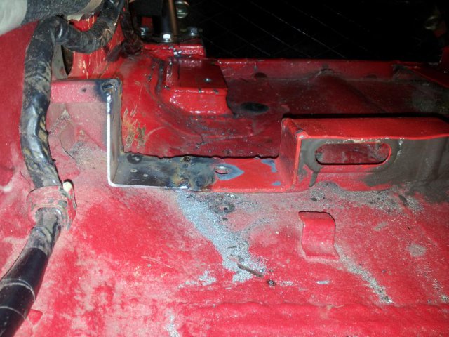

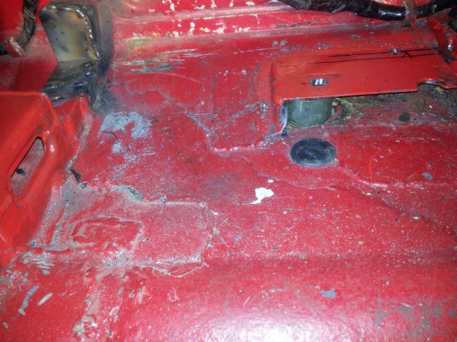

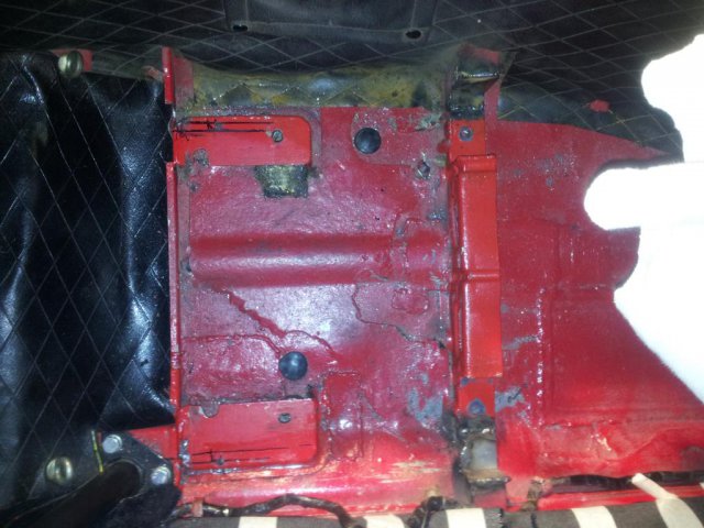

zbloke Posted January 12, 2014 Share Posted January 12, 2014 Right then, better late than never........modded seat mounts, not pretty but effective, I cut them down when I had the previous seats fitted and needed to widen the U shaped dropped section in the front mount to accommodate the Recaro side mounts Quote Link to comment Share on other sites More sharing options...
zbloke Posted February 1, 2014 Share Posted February 1, 2014 A little update re. the drivers seat and its bolster rubbing on the door card I slotted the rear bolt hole for the outer seat mount inward by approx 1/8 of an inch and then squared the seat mount to the inner sill before drilling the front bolt hole in the extended dropped U section Repositioned the inner seat mount square to the outer one and drilled the front bolt hole for it, fitted the seat....and the outer bolster now just clears the door card, like the passenger one, and the steering wheel feels and looks just as centred, possibly better than before too, to the seat Happy days Quote Link to comment Share on other sites More sharing options...
