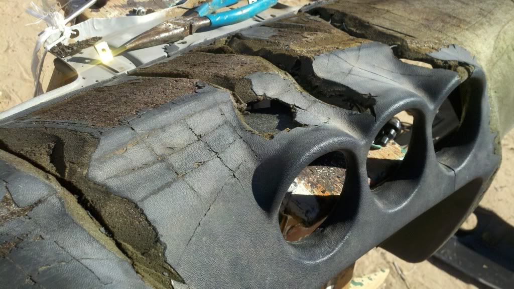

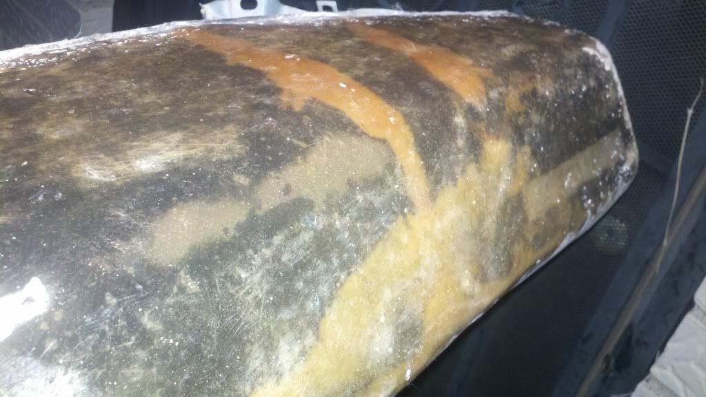

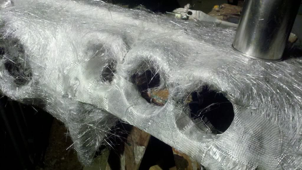

LanceVance Posted October 15, 2011 Share Posted October 15, 2011 +1 for the fiberglass. Dash after stripping stock plastic vinyl and wiring curled foam base back into shape: After filling cracks and various stock holes with foam (A/C vents, cig lighter, glovebox deleted): Using combo of fiber cloth and matting I was able to achieve very smooth and constant contours despite the poor condition of the dash was in originally: It's worth noting that using more or less layers allowed for flexibility in key places and sturdiness in others. I've considered making a recess for a small fire extinguisher where the glovebox originally was. I plan on having the dash flocked locally which will run around $100-$120.00 with quality black nylon fibers. It's stainproof, reduces glare and is simple to clean. Couple this with some modern gauges and you have a very modern and sporty looking dash. HERES a link to a guys build thread showing his flocked 240z dash, pretty dang sharp looking. Quote Link to comment Share on other sites More sharing options...
