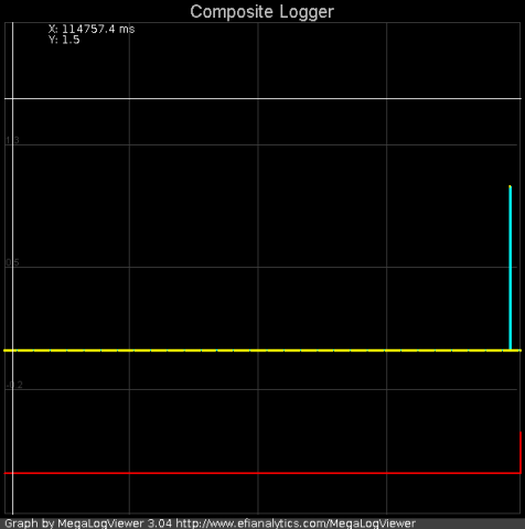

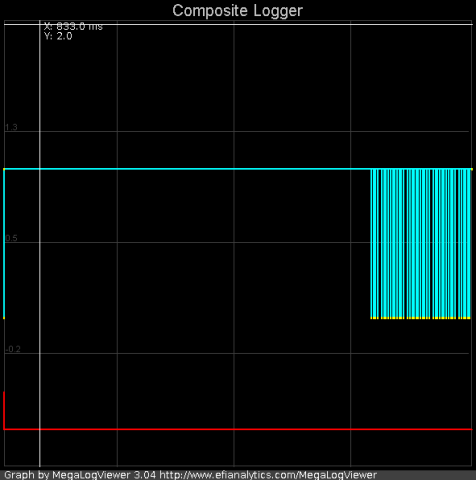

BLOZ UP Posted February 16, 2012 Share Posted February 16, 2012 (edited) I'm having sync loss with the new wheel. VG30ET MS2 v3.0 + MS2-Extra 3.2.1 Single trigger w/DIY wheel single coil, distributed spark From my logs, it appears to be only between 2100-2400 RPM. The majority of sync loss reasons are #2 (missing tooth at wrong time), but there's also a few #5s (1st tooth failed test). Here are my wheel settings: Here's a couple screenshots: Attached is the log. You'll have to get rid of the .txt extension, unless MegaLogViewer is smart. datalog.msl.txtFetching info... Watch out it's huge. An hour or so of driving. About 30 sync losses. I checked most of them, they were between the RPMs I listed. Diagnostics: I have it wired according the DIY article. I've got solid grounding and power to MS. However, my CAS wires do go near my plug wires. The plug wires are in good condition. The CAS wires are covered with loom (whatever EMI resistance that has, if any). I've tried routing them as well as I can. I have completely forgotten the wheel logger. I'll report back when I run it... Edited February 16, 2012 by BLOZ UP Quote Link to comment Share on other sites More sharing options...
BLOZ UP Posted February 16, 2012 Share Posted February 16, 2012 Also Sam280Z posted on the MSExtra forums about a similar issue: http://msextra.com/forums/viewtopic.php?f=131&t=43936 Quote Link to comment Share on other sites More sharing options...
BLOZ UP Posted February 16, 2012 Share Posted February 16, 2012 (edited) Tooth logger looked fine to me. Couldn't get it to mis-sync while logging, of course. But I should have thought to try noise filtering and report back. Edited February 16, 2012 by BLOZ UP Quote Link to comment Share on other sites More sharing options...
Sam280Z Posted February 17, 2012 Share Posted February 17, 2012 Use the sync loss logger. You can datalog at the same time. It only records a tooth log when a sync loss occurs. Quote Link to comment Share on other sites More sharing options...
BLOZ UP Posted February 17, 2012 Share Posted February 17, 2012 I'm hoping the noise filtering will work. But what I meant was that the car ran fine when I tried it, no actual lost syncs. I'll have to drive it longer tomorrow. Quote Link to comment Share on other sites More sharing options...
BLOZ UP Posted February 17, 2012 Share Posted February 17, 2012 (edited) I've tried the sync loss logger, I have two logs... I can't seem to get anything useful from them... I know I had multiple sync losses when logging. The screen changed, but I'm not sure what I'm looking at. I also tried the tach period rejection with liberal settings without much luck. Still got the sync losses. #2s and a #5 here and there. It looks like the #5s happen at various RPMs now, where the #2 is just in that 2200-2400 window. I've tried rerouting the CAS signal away from the plug wires. It now rests against the fuel rail and is closer to the injectors. sync2.csv.txtFetching info... sync1.csv.txtFetching info... syncloss.msl.txtFetching info... Edited February 17, 2012 by BLOZ UP Quote Link to comment Share on other sites More sharing options...
BLOZ UP Posted February 17, 2012 Share Posted February 17, 2012 (edited) That was a 30 minute drive or so. Since then, I've enabled interrupt masking, and I think that has improved it. I also added some loom around the CAS harness. 20 minute drive produced no sync problems. But I will test some more to be sure. Now if I could only figure out my high req_fuel value, I'd be set. But "I digress..." Sorry about the messy thread, I thought it was related at first. Edited February 17, 2012 by BLOZ UP Quote Link to comment Share on other sites More sharing options...
