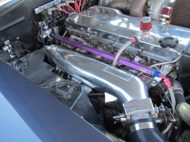

wrcbonk Posted December 10, 2011 Share Posted December 10, 2011 I finally got my RB25 to start, even idle. It was a comedy of errors between coolant and fuel leaks, but its running. Check out the videos. The first one is the actual second start from yesterday (with substantial help from Rejracer) and the second video I made this morning. Still have lots to do cleaning up electrical, finding an exhaust solution, generally putting the car back together. Bonk Quote Link to comment Share on other sites More sharing options...

rayaapp2 Posted December 13, 2011 Share Posted December 13, 2011 (edited) Sanjeev aka GTZ has a roller on the end of his manifold for the cable. I mentioned that he should have done a double roller, one with a convex wheel and one with a flat wheel to tension and retain it into position. He hasnt gotten around to doing that and I think he is still unsure about that idea, but his cable pops off every so often. I copied RS-Speed's cable install on my own, but that puts the cable on the bottom of the manifold. I used the manifold studs to secure a bracket for the cable underneath, but it leaves very little room to adjust the alternator belt. The smoke will subside as long as you do not have an oil leak or gasket leak. Id bet you have residual oil on the manifold itself that is burning off. Even if you touch it with clean hands it seems you get oils on the manifold that burn off. Also most of these engines get the armorall treatment when they come over here so that also has to burn off. Good chance that the smoke is no biggy and the first real test drive that gets the temps above 800* will burn all that off. Your timing is in Base mode at the moment as well without the TPS plugged in. Questions, So what exactly was involved with that harness and what did it cost you. It appears that you sent them what you had left and they repaired it and built in your ECU connections? Is that correct? Or did they make it with a pig tail harness to connect the ECU harness into? Edited December 13, 2011 by rayaapp2 Quote Link to comment Share on other sites More sharing options...
