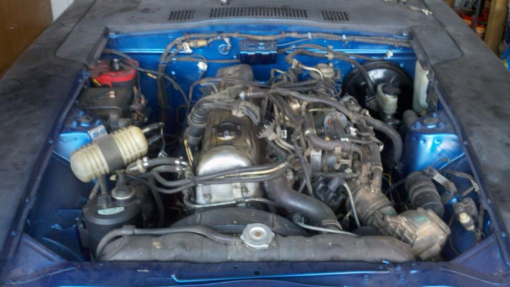

RoCa Posted January 20, 2012 Share Posted January 20, 2012 1976 S30 with 1983 280zx engine. Everything is mounted but stumbled on wiring issue. Here's what is done so far: -Connected power to the ECU by running power direct from battery with an o-ring. -Bypassed fuel pump relay and have turn key power to the fuel pump. -Coil is hot, have good spark. Problem is that the fuel injectors are not firing. Any help, links, comments is greatly appreciated. Quote Link to comment Share on other sites More sharing options...
