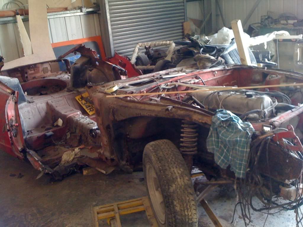

So you buy one of these......
Strip all the parts you need and recon them, then bolt them on to this.....
Over here the cars are rare and good condition ones even more hard to find.
What we do have is an abundance of L series motors and mechanicals with no car left for them to go in due to rot!
If you can source a scrap z then your'e good to go. Try not to think of it as a 'kit car'. I think of a kit car as a vw beetle for example that someone sticks a fiberglass version of a Porshe on top. These are actual cars, just made from a different material.

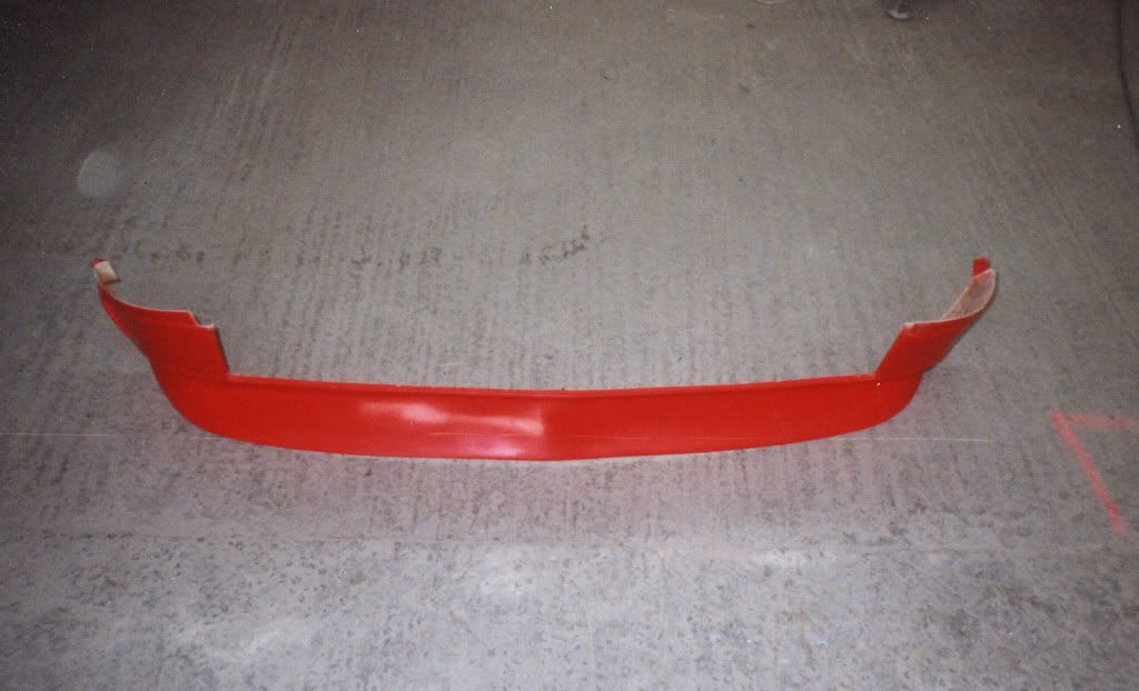

On another note I have been asked for pics of the front spoilers we do.
We make 3 types at the minute...........

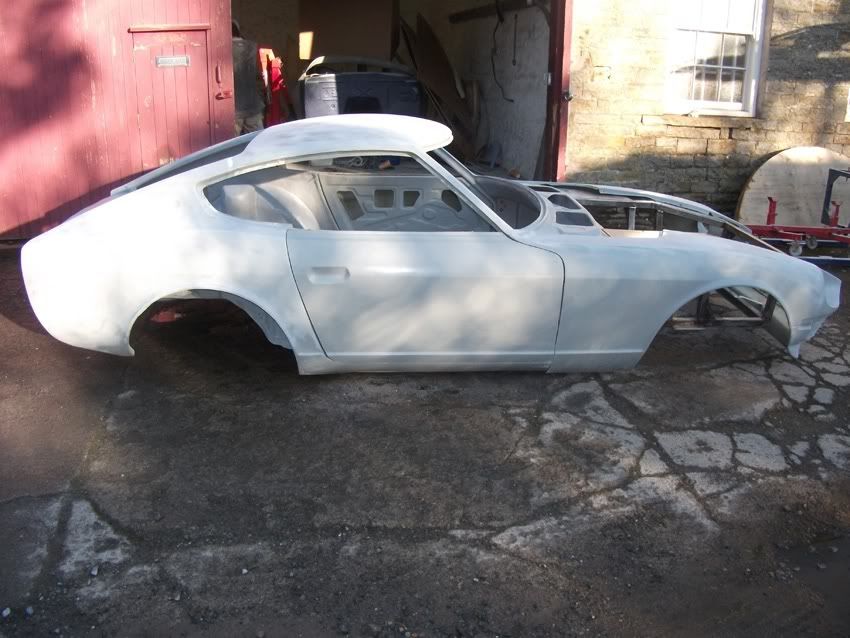

Hi Trevor, that photo is of the 1st proto to see if the idea would work,
Picture below is what we make now.

Now, on Trevor's comment: While your design has been gusseted from the prototype it still is basicly a series of boxes. A few, even relatively small section, tubes triangulating those boxes would add a great deal of resistance to bending to the entire sub-structure. This would be a small weight penalty in exchange for much greater strength.

Thanks for the nice comments Dan, you are right of course with regard to the subframe, although we as the builders have to decide at what point we 'stop'. Our idea was to build the subframe to a level that is geometrically correct (or as close as we can) that a reasonably competent customer could then modify to suit his or her application. The problem we have is everyone seems to want something different.
