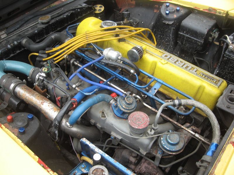

Others have done it. It will depend on your experience reading wiring diagrams from the three different cars involved. Can you take a picture of your distributor and coil? That will settle the question about CAS (crank angle sensor). You will most likely be better off getting an 82 or 83 turbo harness and following the guides on this site. Check the FAQ's section for how to do the swap. Also a word of caution, you might want to do basic troubleshooting on why it runs bad before assuming the harness is the problem. Also in you posts please be specific, which stock ecu, which afm, ect. Some people have done some pretty crazy things to cars over the years. Knowing what you are starting with will help others help you.

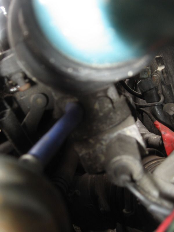

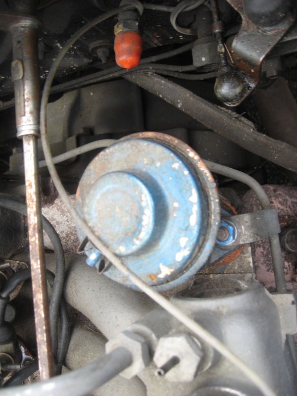

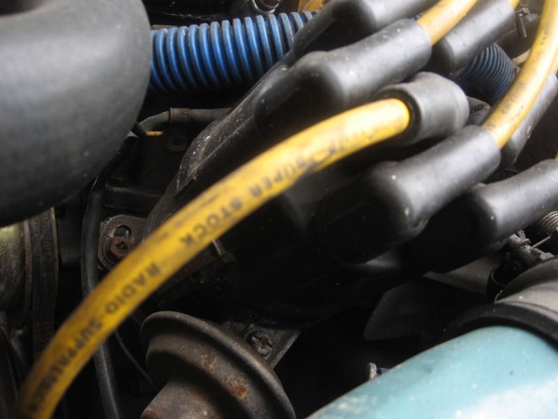

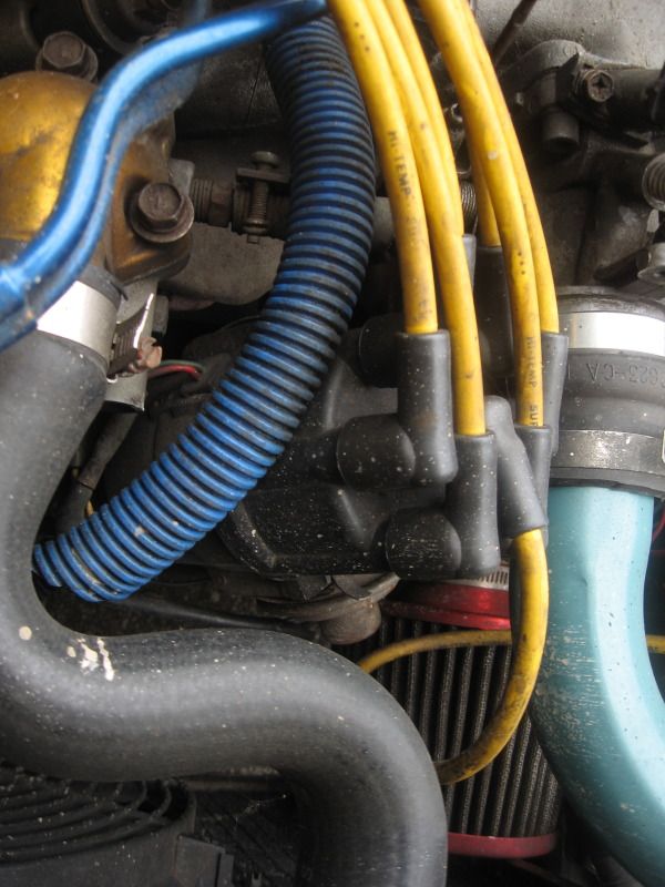

So my distributor is not going to cut it. Can you tell if this is the right distributor that came with the engine or is it the dizzy from the old na l28? Cant i just source out an 82-83 dizzy with the CAS and use that? Thanks
Rick
Your current distributor looks like the one from the 78. You can swp to the 83 distributor, but you need to change the distributor drive shaft as well. Search on the l28ET swaps and they will describe how to do it. You will need to pull the oil pump.
I dont understand why I cannot just find the right distributor for the motor. Why the need to drop the oil pump? For example if the motor is an 83 then an 83 dizzy should bolt up no issues right. I gues Im missing something here. Is my motor a frankenstein (l28 bottom l28et head)? I searched lotsa swaps but found no info specific to my issue. So if my motor is running a 78 2850z dizzy then what does that mean? Does it mean the bottom end is indeed a na L28? Thanks very much.
Rick
The block model number is cast in to the side of the block, just behind and below the driver's side motor mount. Yours should be an F54 block, but could be an N42. Even if it's an F54 though, you could have flat top pistons, not factory issue for the turbo motors.

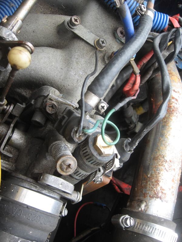

The head number is between the 1 and 2 spark plug holes, on the bottom edge of the head. With the CHTS shown in one of your pictures, yours will probably be a P79, P90 or P90A. Those two numbers will tell you something. Apparently the turbo distributor has a different drive "gear" that's why you have to change the "quill" (? - I think that's the right word) from the oil pump.

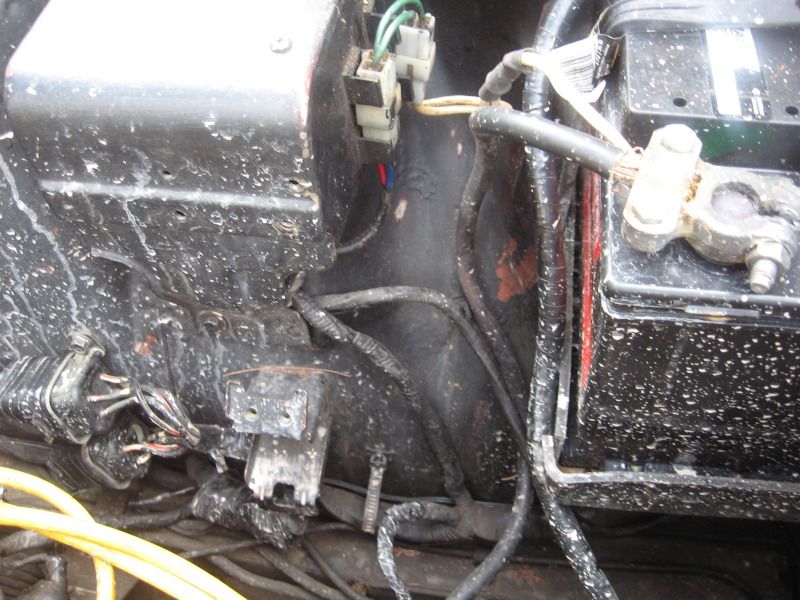

Your pictures do show some hackiness so you could have a mix of parts. A fun puzzle.

OK, so picture #1 shows an NA distributor, an NA distributor drive (quill) and the oil pump. Reference the FSM for how this positions in the motor.
