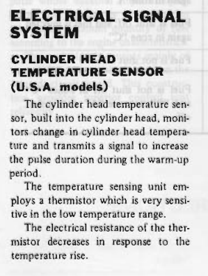

Eric2015 Posted March 13, 2015 Share Posted March 13, 2015 Sorry to revive an old thread but I have a question. Does the CHTS measure coolant temp? I figured it should but I pulled mine and no coolant came out? So does it just measure air temp in the head? Or should there be coolant there? Also, on the thermostat housing there's two sensors. One's for gauge and one is the Engine Coolant Temperature correct? Quote Link to comment Share on other sites More sharing options...
NewZed Posted March 13, 2015 Share Posted March 13, 2015 Pretty well described in the FSM. Can't go wrong looking through that, it's like a school book. Quote Link to comment Share on other sites More sharing options...
Eric2015 Posted March 13, 2015 Share Posted March 13, 2015 Ok according to the FSM the CHTS does read coolant temp. So the next question is why don't I have coolant at the CHTS? Even if the water pump was shot there should still be coolant in the engine....? Any ideas? Quote Link to comment Share on other sites More sharing options...
SleeperZ Posted March 13, 2015 Share Posted March 13, 2015 It measures head temperature, it is a dry sensor. Quote Link to comment Share on other sites More sharing options...
BLOZ UP Posted March 13, 2015 Share Posted March 13, 2015 Ok according to the FSM the CHTS does read coolant temp. So the next question is why don't I have coolant at the CHTS? Even if the water pump was shot there should still be coolant in the engine....? Any ideas? Read it again. CHTS stands for "Cylinder Head Temperature Sensor". Quote Link to comment Share on other sites More sharing options...
NewZed Posted March 13, 2015 Share Posted March 13, 2015 Faking to try to get his answers? We all used to do that when we were kids. Or it could be a reading issue. Quote Link to comment Share on other sites More sharing options...
Eric2015 Posted March 13, 2015 Share Posted March 13, 2015 Lol don't get so butt hurt NewZed. I read it. It that section it doesn't clarify if it's a dry or wet sensor. And then if you refer to EF&EC-88 you dip the sensor in water to test it's resistance. So beings the you tested it in water I assumed it read coolant temp. Thanks SleeperZ, that was all I needed to know. Quote Link to comment Share on other sites More sharing options...
