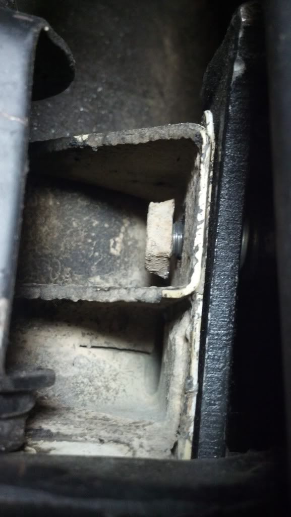

SUNNY Z Posted May 20, 2013 Author Share Posted May 20, 2013 Sure would be nice to get that summary of a parts list you used. Holy crap! Its been three weeks already!?!? I apologize. I made the list in excel, but i couldn't upload it. Send me your email and I'll get it headed your way until i figure out how to host it. He's to busy enjoying the new setup! FACT. I've put 1100 miles on the car since the rear swap so far. I beat on it pretty hard this weekend at KC2K13. It started to develop a clunk when I would get on it. Threw it in the air to investigate today, and found this: Other side Its a good thing I Loctite'd them as well as using lock washers! Those are the back two bolts. I'm not 100% sure how I'm going to remedy this yet. Probably beef up the area, and re-weld some nuts in there. Quote Link to comment Share on other sites More sharing options...
RebekahsZ Posted May 20, 2013 Share Posted May 20, 2013 Is that the RT mount area? I need to check that area myself. I still have a bang on slow turns that I have been blaming on the LSD. I may send my next set of axles to DSS. It may be from rebuilt but worn CVs. I think it was ZFan that put that idea in my head. ETs???? Quote Link to comment Share on other sites More sharing options...
SUNNY Z Posted May 20, 2013 Author Share Posted May 20, 2013 Is that the RT mount area? I need to check that area myself. I still have a bang on slow turns that I have been blaming on the LSD. I may send my next set of axles to DSS. It may be from rebuilt but worn CVs. I think it was ZFan that put that idea in my head. ETs???? Yes, these are the back two of the 4 bolts. I imagine that since the diff sits further back, it is acting like a lever on that mount, and putting more torque to the rear bolts. Quote Link to comment Share on other sites More sharing options...
