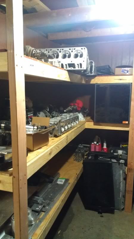

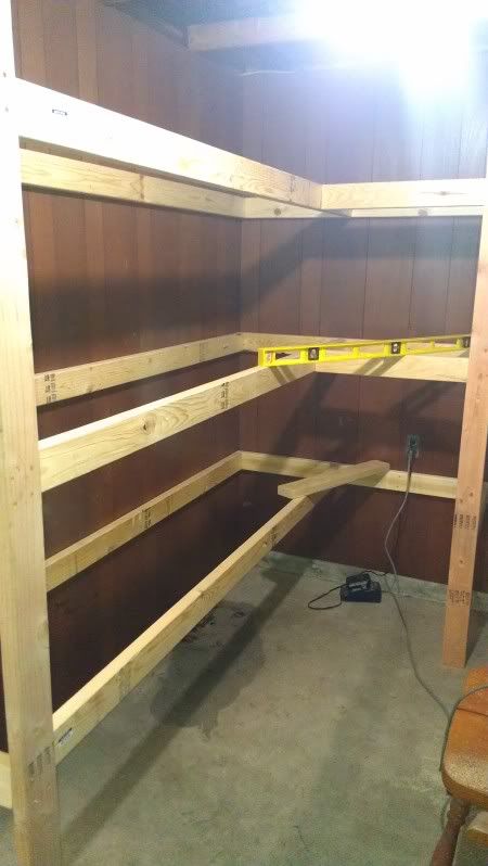

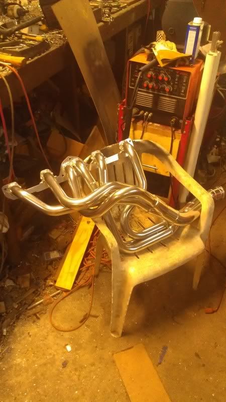

Xnke Posted August 22, 2013 Author Share Posted August 22, 2013 Finally got the head back on the car, and the manifolds and new water line installed. Took a vacation, went to Montana and had my header ceramic coated while I was gone. Built some new shelves, collected a few new parts, built some new parts for the supercharger, did a little studying on throttling and MAF sensors. Also started painting a bike for my little brother...All while the Z sits, neglected, in the driveway. I've had about enough of that, so it's time to get back on the game and get this thing rollin'. New shelves...this area was previously unusable space, full of garbage and accumulated crap. Still full of accumulated crap...and a good fridge! Header was coated at Nitroplate in Nashville, TN. Cost me 200$, flat, and it's the first inline-six header they've done. They do big V8 drag headers, mostly...and almost all the ceramic coating for Ford exhaust parts. Been around a long time, but only been doing custom coatings for a few years. Quote Link to comment Share on other sites More sharing options...
