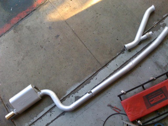

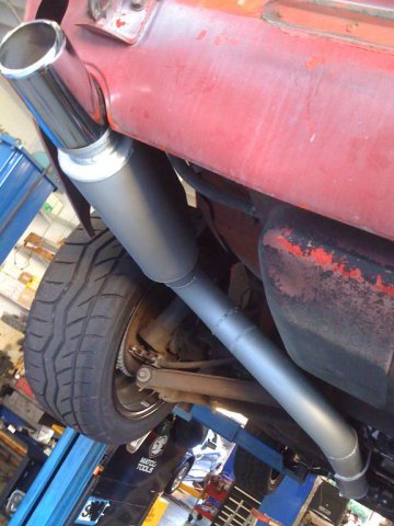

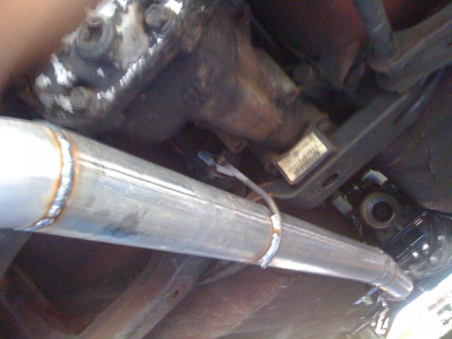

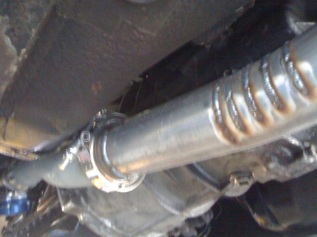

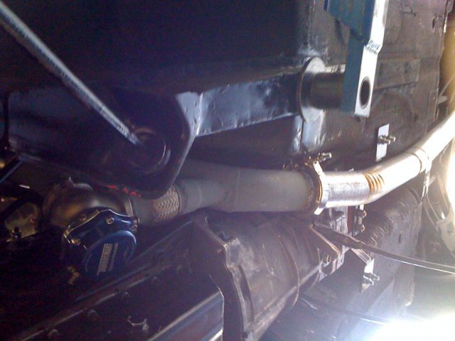

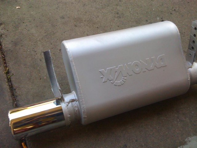

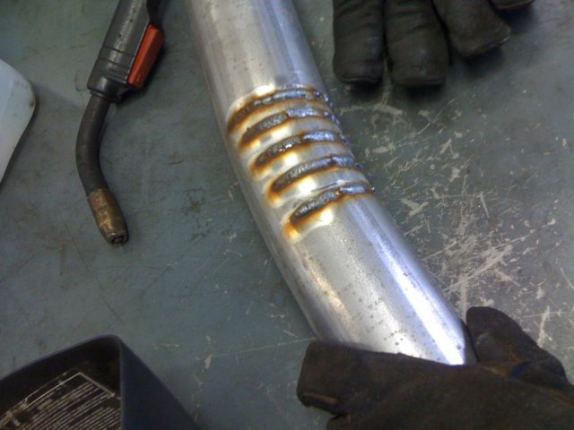

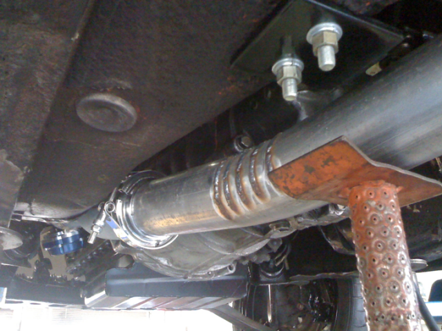

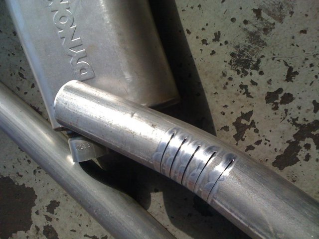

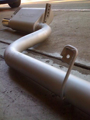

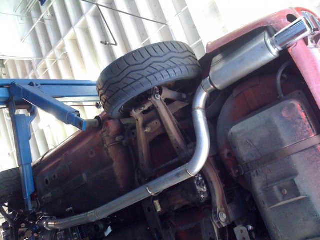

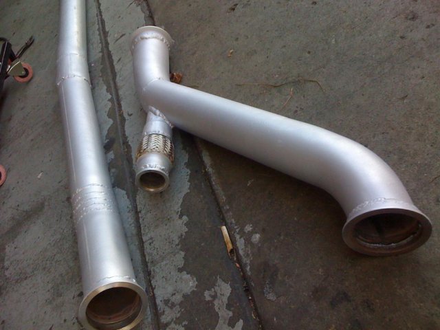

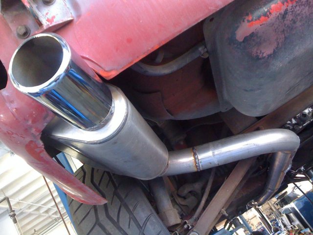

subtle_driver Posted May 28, 2013 Share Posted May 28, 2013 Here is something I made to extend out from my custom made downpipe with recurculated wastegate, when installing an rb26det into a 260z at work. it sounds amazing, and looks subtle. full 3" turbo back system with dynomax strait-through muffler. takes just one minute to install or remove, full v-band mounting etc. Quote Link to comment Share on other sites More sharing options...

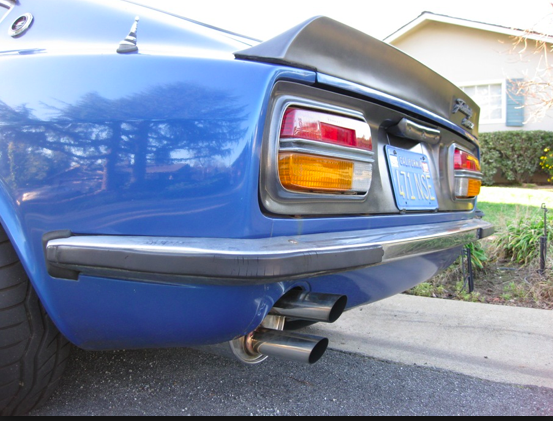

Timecode Posted May 29, 2013 Author Share Posted May 29, 2013 (edited) Thanks for the response guys. I'm leaning toward stuff like this. I like the twin tip but want to see how bigger tips would like on the 240z. #2 is a S2000 but the pipe size is right. Examples: Edited May 29, 2013 by Timecode Quote Link to comment Share on other sites More sharing options...
