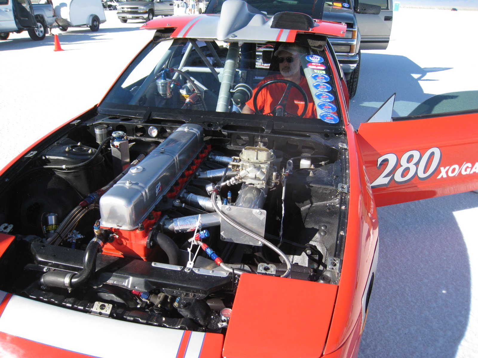

Chaparral2f Posted January 9, 2013 Share Posted January 9, 2013 Why did they do that? That straight eight is heavier than the Queen Mary, at best only displaced 320ci at best, but most likley 263ci. They only madeabout 150/170 hp and that was wound clear up to 3600rpm. After all that being said, I always loved those engines, and I think this really cool!! Quote Link to comment Share on other sites More sharing options...
NewZed Posted January 9, 2013 Share Posted January 9, 2013 (edited) Looks salty. There must be some kind of reason. Four intake runners feeding six ports seems a little weird. I like the custom bracket for the nylon zip tie. Probably a weight saving measure. Edited January 9, 2013 by NewZed Quote Link to comment Share on other sites More sharing options...
kiwi303 Posted January 9, 2013 Share Posted January 9, 2013 Might make very little HP, but whats the torque down low? Stump puller motor with way out rear diff gear ratio and gearbox should get the power down easy. Straight 8, not 6. if you look carefully at the pic each of the intakes is flanked by an exhaust on each side, E-I-I-E E-I-I-E E-I-I-E E-I-I-E style. On 1/9/2013 at 4:08 AM, NewZed said: Four intake runners feeding six ports seems a little weird. Quote Link to comment Share on other sites More sharing options...
Tony D Posted January 10, 2013 Share Posted January 10, 2013 (edited) The reason they did it is clearly written on the side of the car: "XO" It's a vintage class. We competed against an XO Ford Pinto running a methanol injected, blown flathead... What would you want to do: run for top speed in a brick of a 36 Buick, Or run that same engine in a nice, aero-slick S13? That's why they did it! (EDIT) as to the engine "only" displacing this-or-that, remember the classes are by body style and DISPLACEMENT. You can run a 50cc Streamliner, or four synchronised 640CID Donovan Hemis in your Streamliner. One record expectation will be slightly higher than the other. At Bonneville, the "just stuff a big engine in it" crowd usually gets a rude awakening (and curiously finds smaller cars and engines just might be less hairy to learn in!) Edited January 10, 2013 by Tony D Quote Link to comment Share on other sites More sharing options...
johnc Posted January 12, 2013 Share Posted January 12, 2013 Let me count the things wrong in that engine bay:1. Braided lines rubbing against each other. 2. Braided lined held in place on the core support with low temp wire ties. 3. Braided lines rubbing on intake manifold plate. 4. Unsupported wires running across the engine brace. 5. Braided steel fuel line to fuel rail and then rubber hose with triple hose clamps to carb. 6. Fuel pressure gauge pointing down at the engine. Looks like they brought their 1950s tech along with the engine. Quote Link to comment Share on other sites More sharing options...
