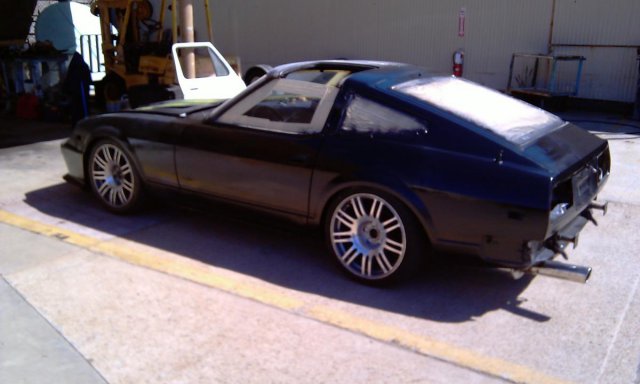

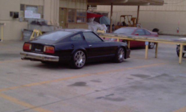

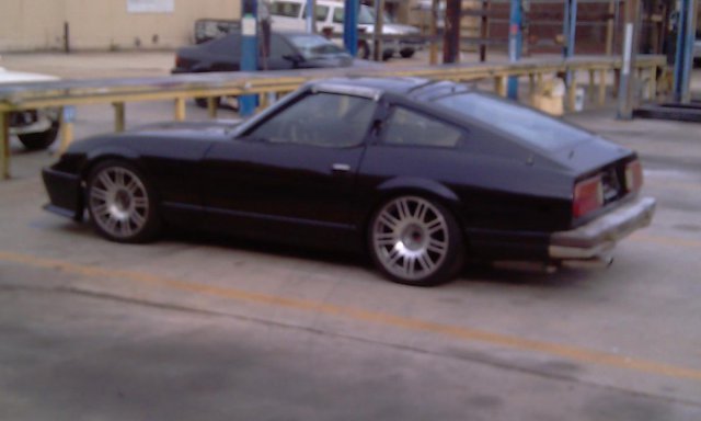

vert88 Posted January 25, 2013 Share Posted January 25, 2013 So ive been in Japan for a couple months now and slowly learning to get around, well last week a friend of mine took me to Up Garage and i fell in love, hell i think i would live in the shop if they let me, parts galore all over the place, now the reason that i am posting, Prior to leaving for my 2 year stint in Japan as i am i the Navy i bought a 1983 280zxt with the intentions of dropping an RB26 into it and getting as much l28 parts that i can find for a decent price to add to my collection. I plan on keeping my L28 along with the borg warner tranny but what i cant seem to find is if there is another clutch setup that would be compatable with the 5 speed because i would like to get an OS giken clutch for it. Maybe i am getting ahead of myself here but I just bought a tubular turbo manifold for the L28 and now i have my eyes on this twin turbo setup so yes i know i have a problem so dont judge me, ive tried curing myself but it just seems to come back. Here is a pic of my car they are taken with an iphone so they are grainy. So far ive don the 5 lug conversion which is very easy i might add and the 300zx 4 piston brakes with s13 coilovers, i plan on getting g-nose setup from here and ship it back and run it with the rest of the aero 2 sides and rear skirt. Quote Link to comment Share on other sites More sharing options...
