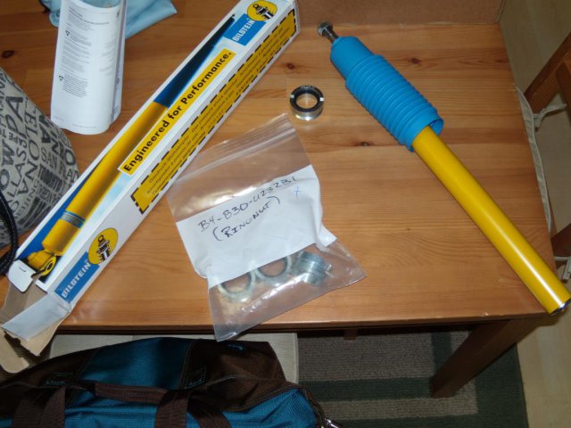

Leon Posted July 15, 2014 Author Share Posted July 15, 2014 (edited) The shocks have arrived! I made sure to test-fit the gland nut onto a strut housing to make sure it's correct. I got the part number from John Coffey, thanks again John. Got the whole setup from AJUSA, who were fantastic to deal with! Edited July 15, 2014 by Leon Quote Link to comment Share on other sites More sharing options...

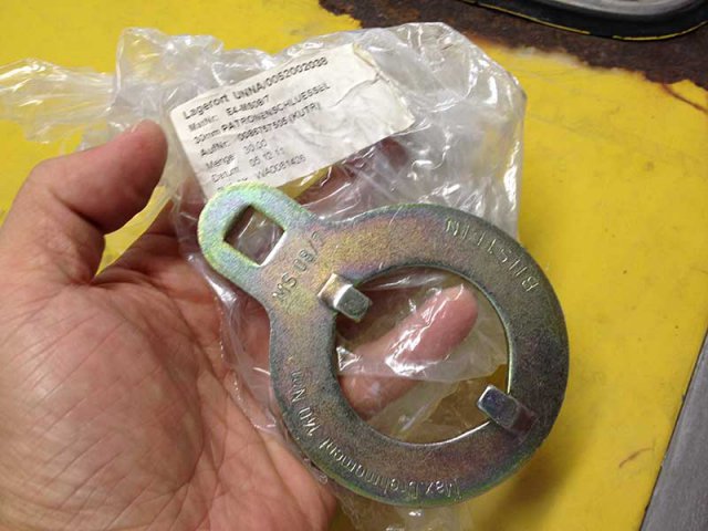

tamo3 Posted July 15, 2014 Share Posted July 15, 2014 Nice! Did you get this tool? I had hard time to find this before. Quote Link to comment Share on other sites More sharing options...
Leon Posted July 15, 2014 Author Share Posted July 15, 2014 On 7/15/2014 at 6:13 AM, tamo3 said: Nice! Did you get this tool? arrived_0.jpg I had hard time to find this before. Ah, I forgot to ask for it! I was planning on stopping by a shock shop by my work to see if they have it or can source one. Where did you get yours? Quote Link to comment Share on other sites More sharing options...
tamo3 Posted July 15, 2014 Share Posted July 15, 2014 I forgot where I purchased it from. I can let you borrow it:-) Quote Link to comment Share on other sites More sharing options...
Leon Posted July 15, 2014 Author Share Posted July 15, 2014 On 7/15/2014 at 6:57 AM, tamo3 said: I forgot where I purchased it from. I can let you borrow it:-) Thanks Takashi! I'll let you know if I need it. Quote Link to comment Share on other sites More sharing options...

Leon Posted July 17, 2014 Author Share Posted July 17, 2014 Hey Jim, good to hear from you! The Bilsteins are easy to source as they're designed for the Mk1 VW Rabbit and readily available, unlike the Z-specific ones. It's the gland nuts that are hard to find. The gland nuts make it essentially a plug-and-play deal. The car has some sort of old-school coilovers with unknown spring rates. The plan is to remove the springs and measure stiffness, and then dyno the shocks to establish a baseline as well as to see if they'll need revalving to match the car. Lucky for me, there's a great shock shop right by my work that can revalve Bilsteins! We also have a home-made shock dyno at our shop in case I want to go crazy. Quote Link to comment Share on other sites More sharing options...

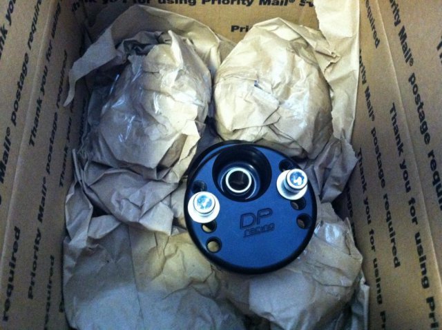

Leon Posted July 28, 2014 Author Share Posted July 28, 2014 Got a set of camber plates from DP Racing to top it all off. Pun intended. Quote Link to comment Share on other sites More sharing options...
seattlejester Posted July 28, 2014 Share Posted July 28, 2014 Lots of work being done, that is the style that just replaces the stock top hat, no slotting or welding required correct? Please tell me how they turn out! Quote Link to comment Share on other sites More sharing options...
Leon Posted July 29, 2014 Author Share Posted July 29, 2014 On 7/28/2014 at 11:41 PM, seattlejester said: Lots of work being done, that is the style that just replaces the stock top hat, no slotting or welding required correct? Please tell me how they turn out! Correct, no cutting or welding required, straight bolt-in. That's why I went with the DPs! They're very nice pieces, pricey but worth it. FWIW, they aren't direct replacements for the stock upper strut mount. You need coilovers to use them as the spring seat is for a 2.5" spring. Quote Link to comment Share on other sites More sharing options...
