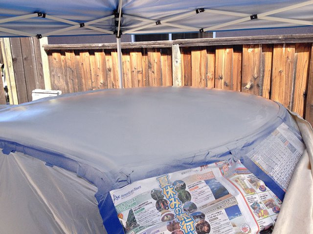

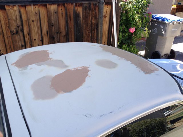

tamo3 Posted July 1, 2014 Author Share Posted July 1, 2014 Thanks Seattlejester, terse, I used PPG products. For Epoxy primer, PPG ESU 470. http://www.nedsautobodysupply.com/PPG_ESU470_Epoxy_Primer.pdf For basecoat, PPG Shopline JBX 3.5 VOC For clear, PPG Shopline JC7200 2.1 VOC HS European Clearcoat. However, it was my first attempt, I did not satisfy result. Waterbase paint is so thin and so easy to get chip off just a little scratch. Painting car is so difficult. I recommend to shop around paint shop in your local area. I will re-paint over the July 4th weekend with Urethan paint. Since I decided to redo painting, I also decided to fix a roof a bit. So hot Summer time! Quote Link to comment Share on other sites More sharing options...

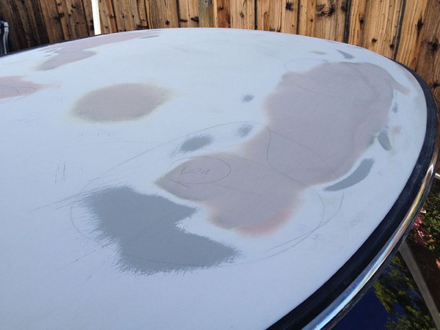

tamo3 Posted July 4, 2014 Author Share Posted July 4, 2014 (edited) Update. Apply bondo, Sanding, primer, keep repeating 5,6 times. Masking and Epoxy Primer. Before After Primed... Edited July 4, 2014 by tamo3 Quote Link to comment Share on other sites More sharing options...

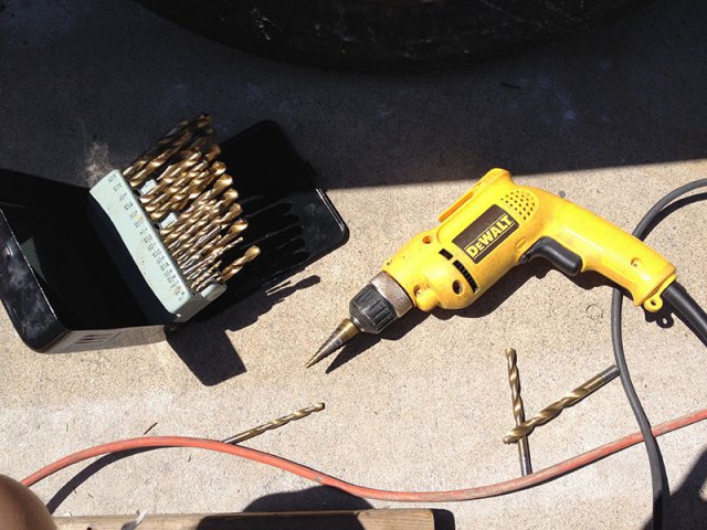

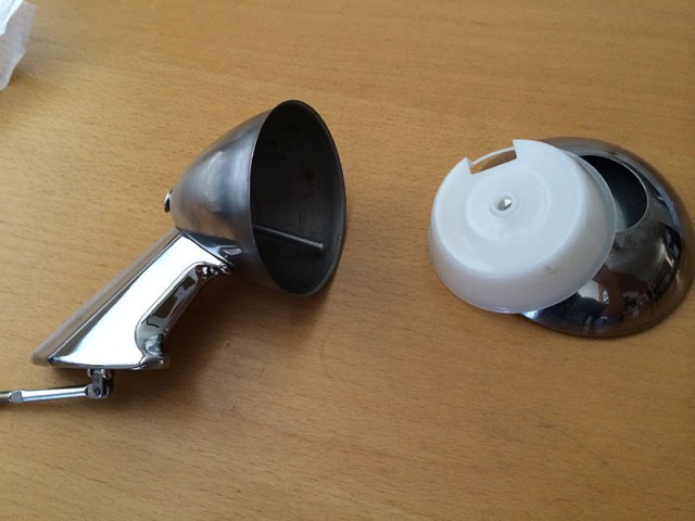

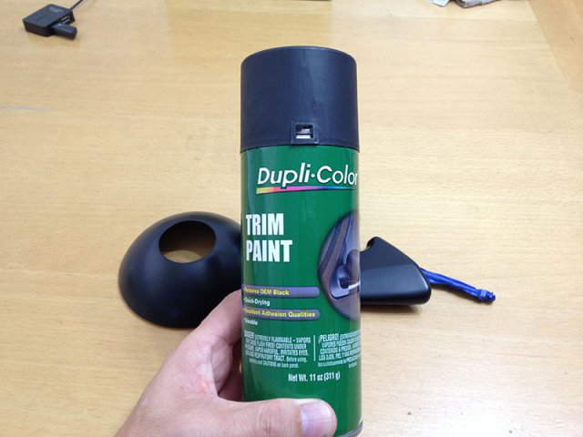

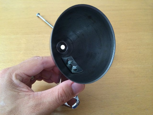

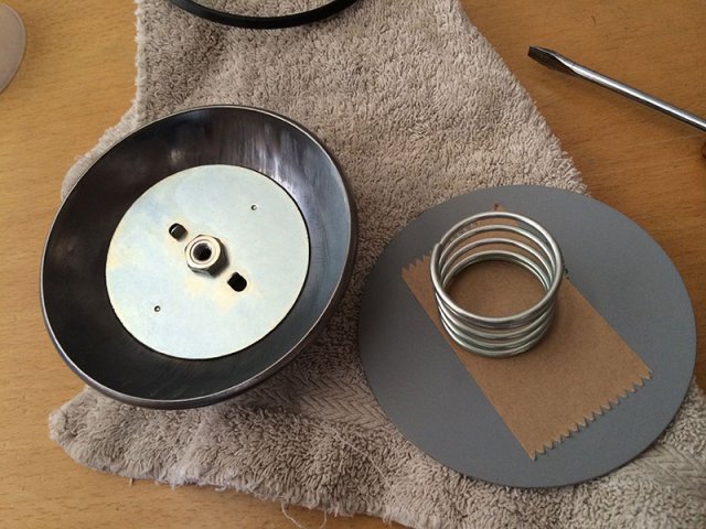

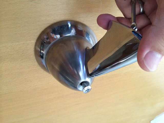

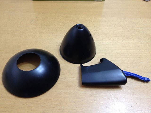

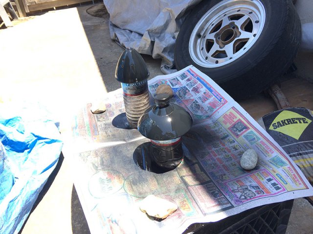

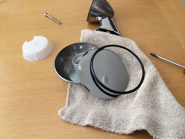

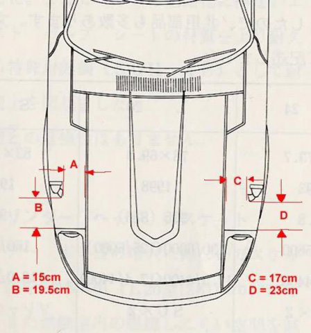

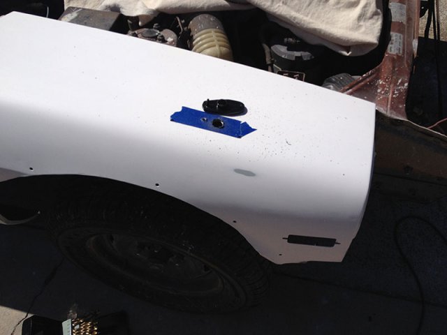

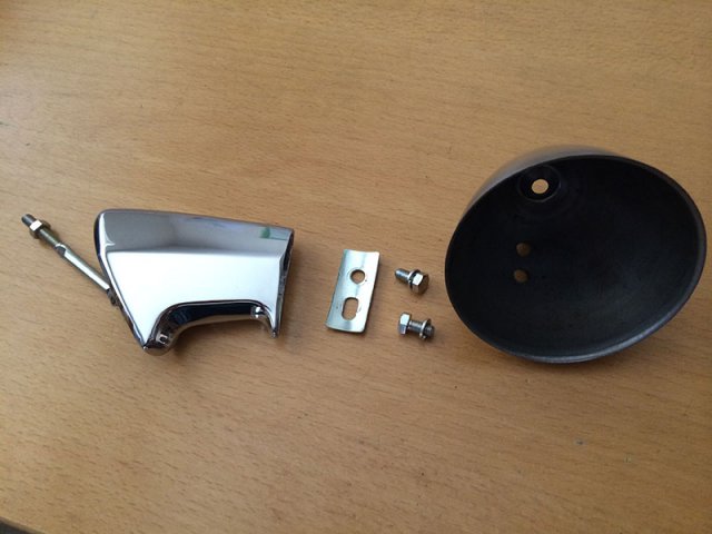

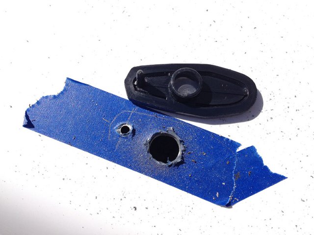

tamo3 Posted July 4, 2014 Author Share Posted July 4, 2014 (edited) While Watching FIFA World Cup Germany vs France, update my progress. I work for Germany company, but my manager is French. Which side should I be... I got Hakosuka NOS fender mirror via Yahoo! Japan Auction. Need to paint in black. Assemble mirror. Use hair dryer to soften the plastic black ring to remove mirror. I use Duplicolor Trim Black paint this time. Thanks Alan T., aka HS30-H. for sharing information. I follow his instruction to drill holes. http://forums.hybridz.org/topic/50023-fender-mirror-install/?p=549483 The big hole is up to 11/16" Edited July 4, 2014 by tamo3 Quote Link to comment Share on other sites More sharing options...

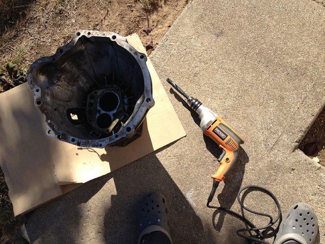

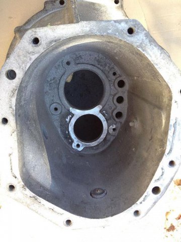

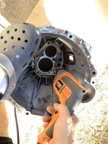

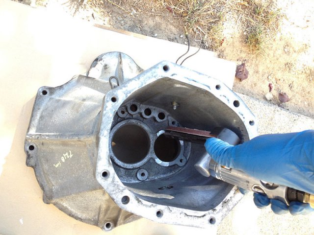

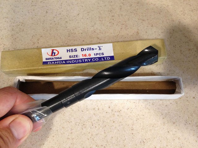

tamo3 Posted July 17, 2014 Author Share Posted July 17, 2014 Working on bellhouse mod for FS5W71C to 280z. I just follow this instruction. http://zhome.com/ZCMnL/tech/240SX5spd/Transmission2.htm Use hand belt sander to grind inside. not good enough, need to try more. Got 16mm drill bit @ ebay Need bigger drill. Just drilled from front side. Quote Link to comment Share on other sites More sharing options...

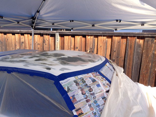

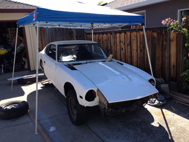

tamo3 Posted August 23, 2014 Author Share Posted August 23, 2014 Thanks Christine. I'm fascinating your craftmanship on your Kuro S30! OK, here is some update. I decided to paint again. Since I painted during Fall-Winter, it was kind of failed. Clear coating wasn't good. With wet sanding of 1000G, all the clear coating is gone So, this time, I decided to use Urethane paint from eBay. http://www.ebay.com/itm/Winter-White-Gallon-Kit-Low-VOC-URETHANE-BASECOAT-CLEAR-Car-Auto-Paint-Kit/141368670516?_trksid=p2047675.c100011.m1850&_trkparms=aid%3D222007%26algo%3DSIC.MBE%26ao%3D1%26asc%3D20140602152332%26meid%3D067f6b1902a546dfa8aa4d70979b64cd%26pid%3D100011%26prg%3D20140602152332%26rk%3D6%26rkt%3D10%26sd%3D191205088646 Looks like it similar to TOYOTA Super White 040. Paint arrived and prepared. This time, I created paint booth using $59 HFT canopy. Make sure to have 10 minutes interval between coating. So far, so good with base coat. Clear coating is so stink! After apply 2nd time, I escape to backyard to take a deep breath and I heard some broken sound..... OMG! Paint booth collapse by wind! Painting was failed.... I wasted so much clear coating. But, biggest failure is... the color is not white, It's light blue Lol This paint is good for VW Beatle.... Quote Link to comment Share on other sites More sharing options...

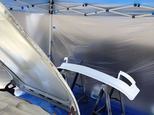

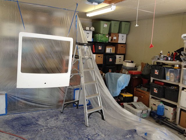

tamo3 Posted August 24, 2014 Author Share Posted August 24, 2014 (edited) Hi Perfect240z, I thought about it. Since I'd like to DIY as much as possible for this project, I will paint by myself. I'm pretty sure, I will ask pro for the next project. I order Toyota Super White 040 this time. Also, I use my garage for the paint booth this time. Make sure to use 3M masking tape. Don't use HDX one. It does not stick long enough. Make sure to tape all the corner. Start painting doors. Succeed! Edited August 24, 2014 by tamo3 Quote Link to comment Share on other sites More sharing options...

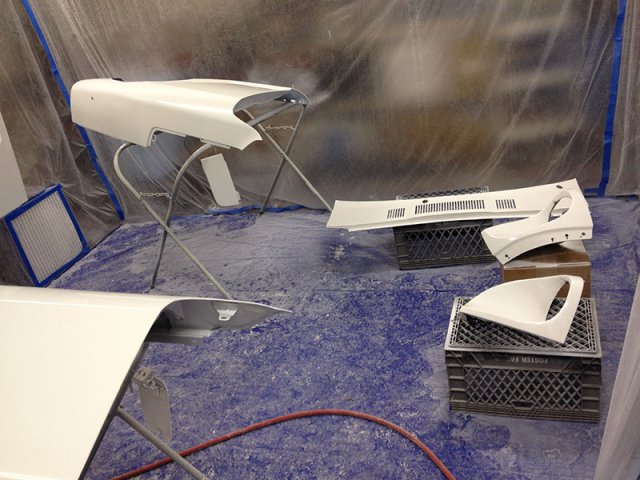

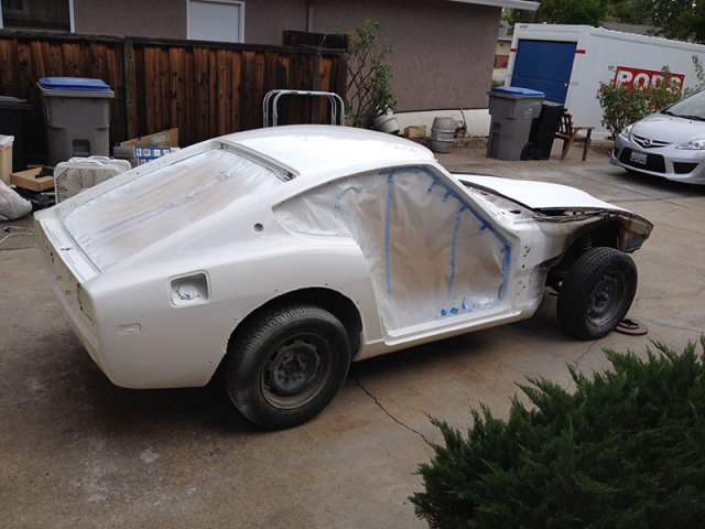

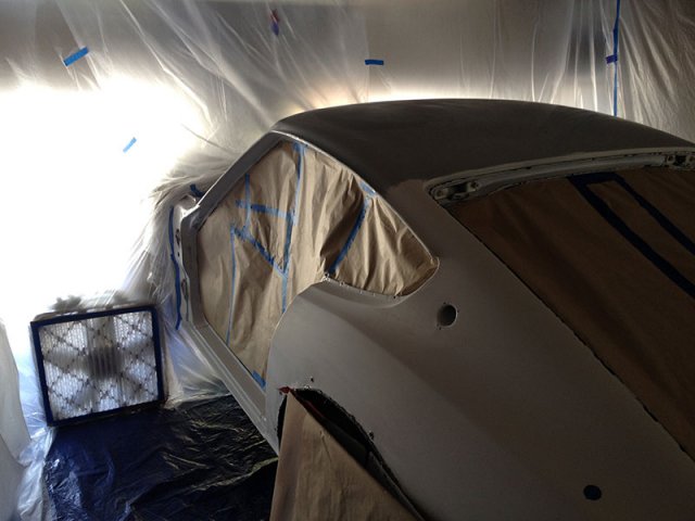

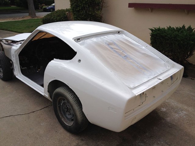

tamo3 Posted August 25, 2014 Author Share Posted August 25, 2014 (edited) Thanks Leon, terse, LegnaZetr0, Here is the update for body painting. When I try to paint, multiple parts, I made a lot of mistake. So, I just concentrated on body only. Masking takes so long time. Not bat?? Edited September 25, 2014 by tamo3 Quote Link to comment Share on other sites More sharing options...
Nigel Posted August 25, 2014 Share Posted August 25, 2014 On 7/4/2014 at 4:55 PM, tamo3 said: Thanks Alan T., aka HS30-H. for sharing information. I follow his instruction to drill holes. http://forums.hybridz.org/topic/50023-fender-mirror-install/?p=549483 install.jpg I hope you reversed the dimensions in that picture for a left hand drive Z? Here's a left hand drive picture: Also, if you want more in-depth info on the FS5W71C swap, here's a link to my very detailed write-up: http://www.motortopia.com/cars/1973-datsun-240z-11118/car-pictures/240sx-transmission-swap-14041 Good luck! Nigel Quote Link to comment Share on other sites More sharing options...

tamo3 Posted August 25, 2014 Author Share Posted August 25, 2014 Thanks Leon! Thanks Nigel! I saw your site from ClassicZ. Once body is done, I will move forward 71C adaption. For the mirror, I use LHD version. Somehow I had RHD version image here. Quote Link to comment Share on other sites More sharing options...

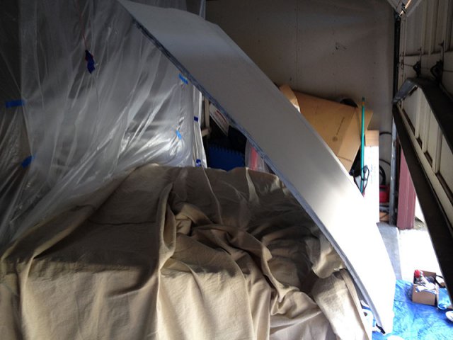

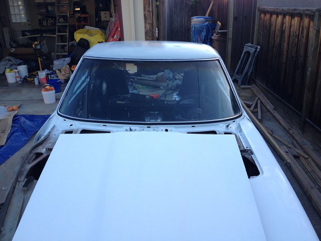

tamo3 Posted August 25, 2014 Author Share Posted August 25, 2014 (edited) Here is more update. Rest of the parts. Hood and front airdam is painted in canopy. Edited September 25, 2014 by tamo3 Quote Link to comment Share on other sites More sharing options...

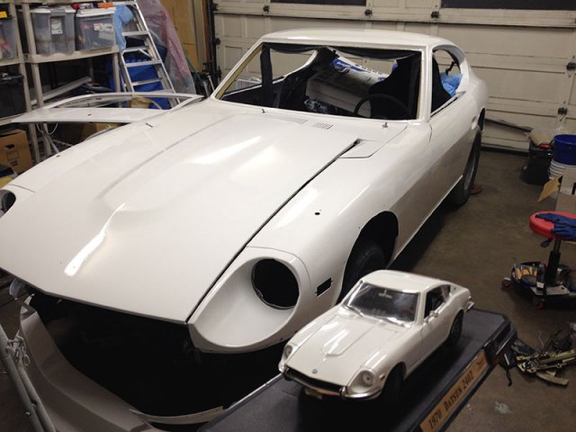

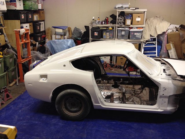

tamo3 Posted August 26, 2014 Author Share Posted August 26, 2014 (edited) All the painting is done! Getting closer to the model Edited September 25, 2014 by tamo3 Quote Link to comment Share on other sites More sharing options...
Nigel Posted August 26, 2014 Share Posted August 26, 2014 On 8/25/2014 at 11:51 PM, tamo3 said: For the mirror, I use LHD version. Somehow I had RHD version image here. That's a relief! Looking really good! That's the same white I used on my Z. Nigel Quote Link to comment Share on other sites More sharing options...
