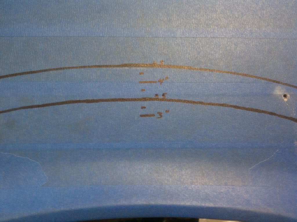

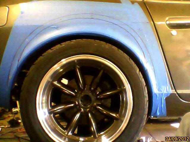

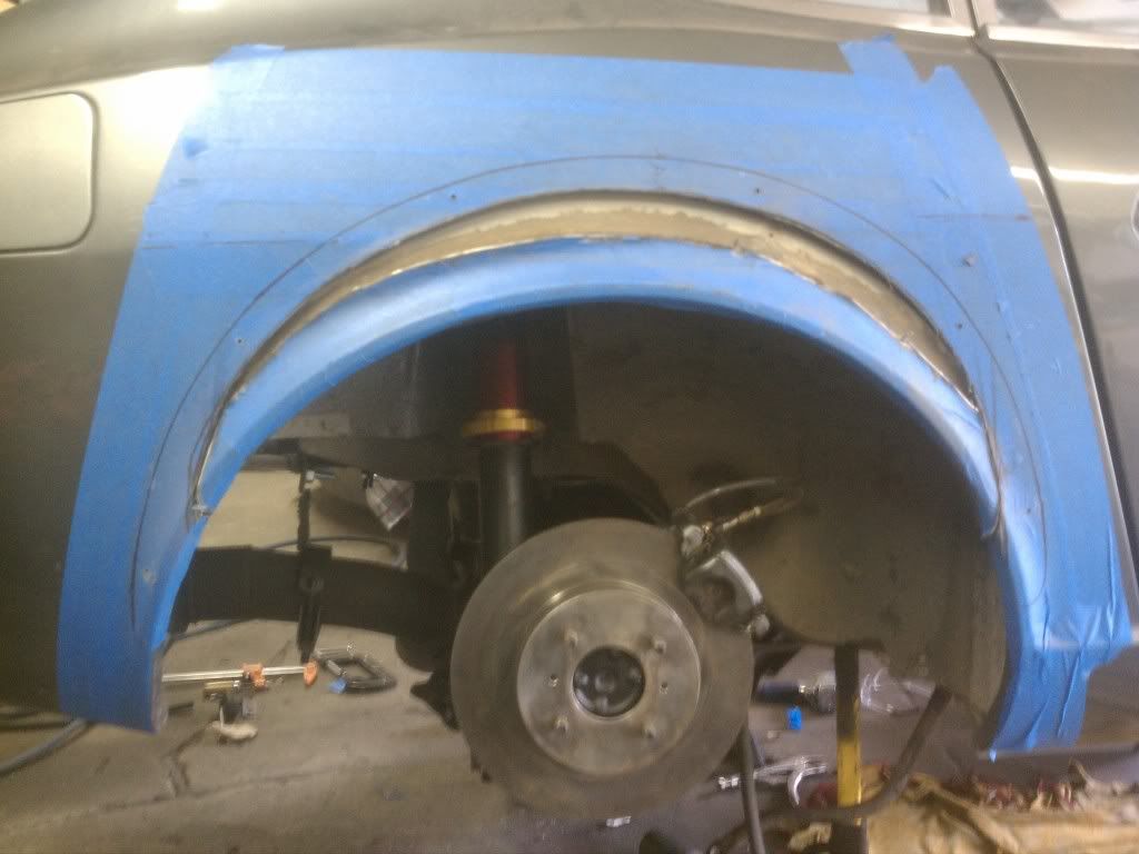

SUNNY Z Posted March 16, 2013 Share Posted March 16, 2013 (edited) I cried a little inside when I cut my rears. I took 3.5" out at the center of the wheel well. 26" tires here. If you want a "tucked" look, I wouldn't recommend cutting as much as I did. The top of my tire is still visible under the flare (from side view) at ride height. If i had it to do over again, I would have mounted my flares lower, and given it a more tucked look. But hey, live and learn! I will also add that I had to cut some more out of the front from what is shown. This is assuming stock geometry suspension. Edited March 16, 2013 by SUNNY Z Quote Link to comment Share on other sites More sharing options...
