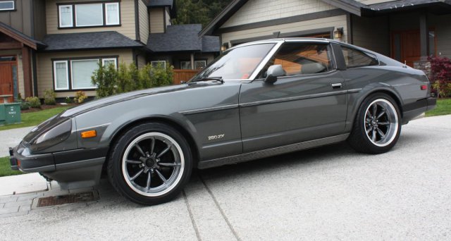

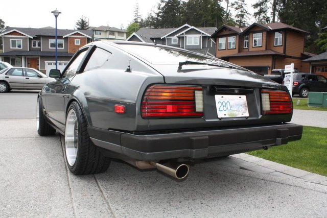

Anyway here is my old 260z with 15x7 0 offset wheels and 205/50/15. Only suspension was tokico illuminas and tokico springs
Doesn't look that bad in my opinion

Nice Z!  No those look good.  I would still want to fit a little more tire in there for my personal taste tho.
Seems there is a good selection of 215/60-15 sized tires still.  According to a calculator this would give me 25.2" x 8.46" x 15.  My set up right now is 24.7" x 7.68" x 14.  Maybe I can get those 15x7 Shakotan's and put these on it.
