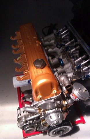

PMC raceengines Posted May 3, 2013 Share Posted May 3, 2013 I have done away with disys now , to get a good chatter free setup i made this Quote Link to comment Share on other sites More sharing options...

Tony D Posted May 4, 2013 Share Posted May 4, 2013 P5030262.JPG I have done away with disys now , to get a good chatter free setup i made this Heh heh heh, "Dodge Style"! Like gluing hall magnets in the flywheel... Remember guys, "the bigger the disc, the better the resolution"! Higher you go in rpms, big discs pay dividends. It's nice to have a big disc. Sometimes at higher rpms a smaller disc just won't do (TEC2, for instance.) Disc reduction is an abomination! Quote Link to comment Share on other sites More sharing options...
GrayZee Posted May 7, 2013 Share Posted May 7, 2013 I have a z32 cas installed into a turbo L distributor. I think they're the same or very similar. Have to drill a few holes and install a sleeve inside the z32 cas to keep it snug on the shaft. I think you are mistaken, it is a VE cas, the z32 has a larger sqaure-ish plug like a old AFM plug. IMO the VE cas is a easier mod because the plug is smaller and requires less cutting of the L28et dizzy housing. The cas wheel is identical to to a z32 and provides the same signal. I have one that is similar and is copied from looking at Bernard's.. LOL Mine is slightly different, but works the same. I have 350z coils with a aluminum bracket that bolts to the valve cover and allows for a mounting point to hold the coils up. I think it is a pretty clean looking setup. Quote Link to comment Share on other sites More sharing options...
280zex Posted May 8, 2013 Share Posted May 8, 2013 P5030262.JPG I have done away with disys now , to get a good chatter free setup i made this um DROOL!! sorry to thread jack... Quote Link to comment Share on other sites More sharing options...
