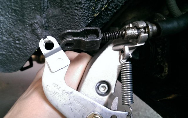

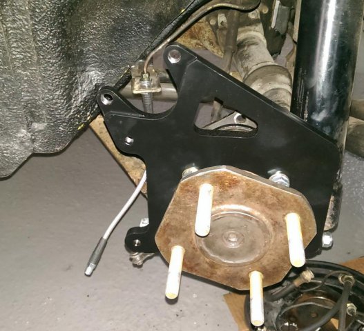

Ereschkigal Posted May 6, 2017 Share Posted May 6, 2017 (edited) I am in the middle of installing the kit with the not completely unexpected problems with the hand brake cable end. I got the same problem you posted a while ago: Not exactly sure how to solve this problem but my OEM cable worked for the other part and is long enough. It's a 12/72 build US 73 model. Edited May 6, 2017 by Ereschkigal Quote Link to comment Share on other sites More sharing options...
