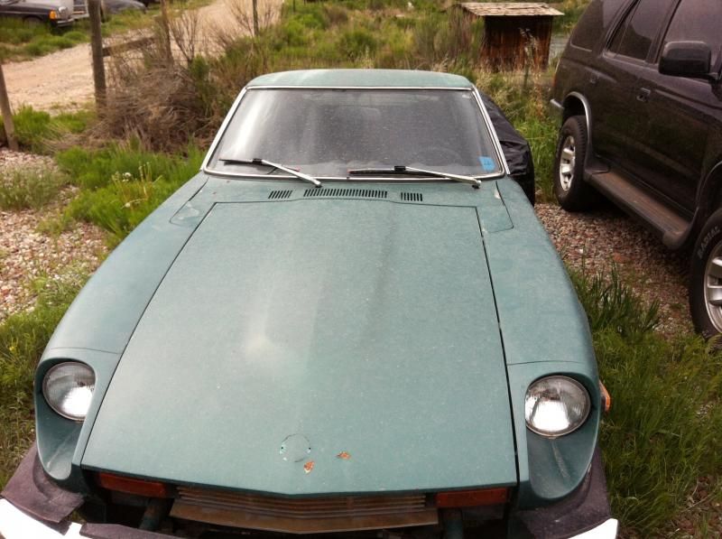

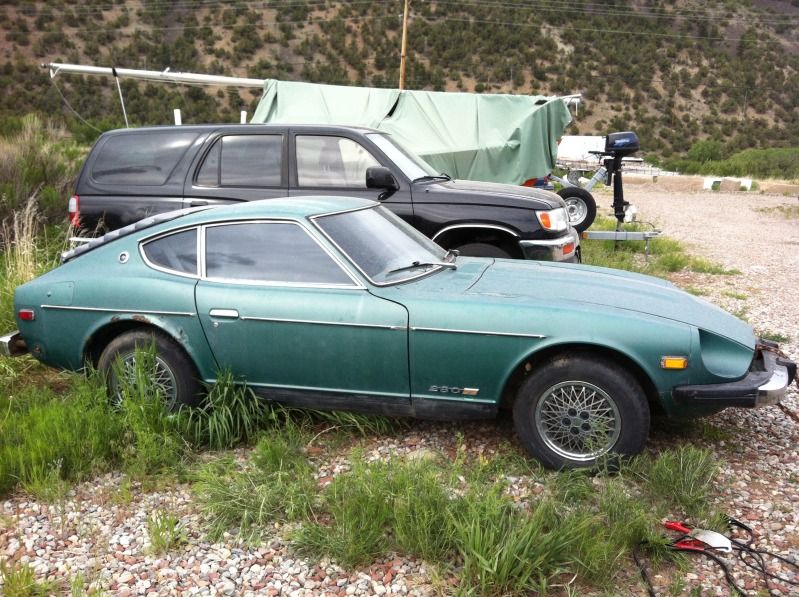

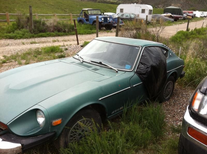

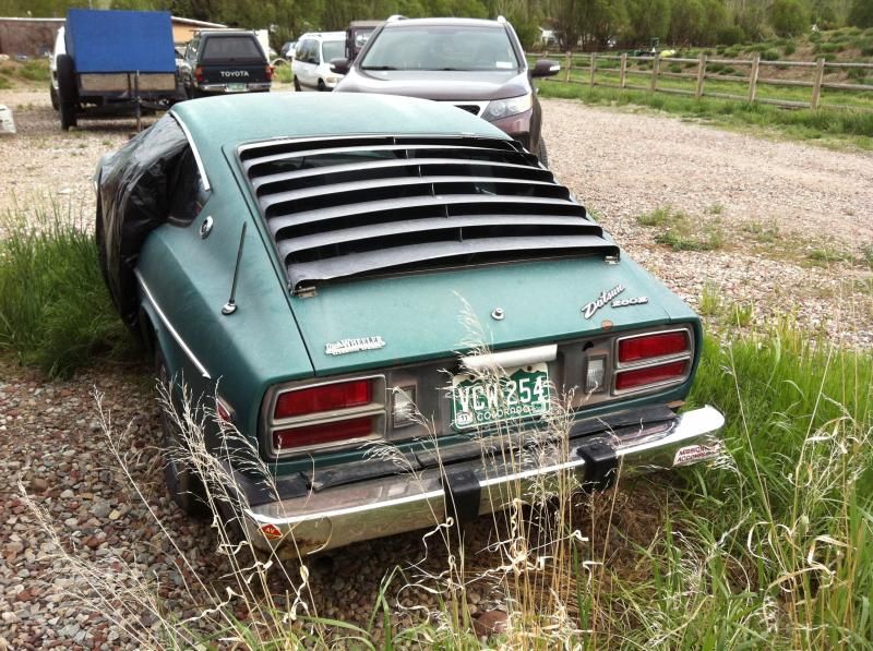

boomnn Posted July 10, 2013 Author Share Posted July 10, 2013 This is the 75 I will do pic's of the 73 tomorrow Quote Link to comment Share on other sites More sharing options...
PLATA Posted July 10, 2013 Share Posted July 10, 2013 (edited) Not bad for freebeeZ, good luck on your adventure, get that wallet ready Edited July 10, 2013 by PLATA Quote Link to comment Share on other sites More sharing options...

Pharaohabq Posted July 12, 2013 Share Posted July 12, 2013 (edited) Well, I see the 280Z pictures, it doesnt' look too bad, BUT there is some rust. Rust isn't good, but almost all these cars have some. The rear arches look to have a good amount. I'd expect there's rust in other locations. You'll need to read up on where it's common. Mainly though, you want to be sure the frame rails are intact, floor pans, rear deck, tirewell, and especially the inner fenders in the front tirewells need to be checked. It all can be fixed. Panels are availible to repair most of it from Tabco.com. Now the 73' is there a lot more rust on that body as compared to this? Again, What is your goal, What do you want to do with the cars? You'll really need to figure that out before you take on these projects. Figure what you want and we can help you get there, it's just a matter of how much you want to spend doing it. Are you just looking for a daily driver? Without seeing picts of the 240, I'm recommending the 280 at this point. How long have these cars sat? you could have some bad gas/jellied gas issues which can be a seriously pain in the * to fix. oooh post 1500 for me Edited July 12, 2013 by Pharaohabq Quote Link to comment Share on other sites More sharing options...

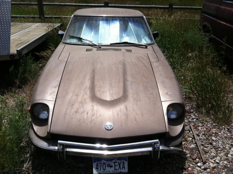

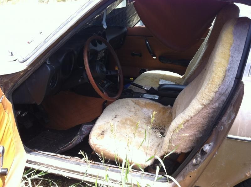

boomnn Posted July 13, 2013 Author Share Posted July 13, 2013 (edited) Ok so here are a few of the 73 i have not seen the car in a couple years as it has been covered. When i uncovered it it looks in worse shape than i remembered!! uggghhh!! the engine bay is pretty clean, the inside is not in such great shape, i noticed a little rust in the inside door jamb at the floor seam, my green one doesnt have near the rust!! floors have no rust and battery has no rust i can waork on the surface rust i dont want to become a metal fabricator! I think what im gonna do is swap around parts to make the best car i can, then i will have to figure out what to do with the 73?? maybe trade it for a motor if anyone has a spare?? lots of choices now. Edited July 13, 2013 by boomnn Quote Link to comment Share on other sites More sharing options...

Pharaohabq Posted July 18, 2013 Share Posted July 18, 2013 (edited) You think that 240Z is bad??? Wow really??? I've seen some that are WAY worse than that. Especially if you say the floor pans are still good. That 240 needs rear arches over the rear tires and some 3M hitemp glue for the headliner. otherwise it doesn't look so bad. I'm sure you could easilly get $1000 bucks for it if you filled up the tires and put in a battery. more probably if you washed and waxed it. you'd have to unbend that front bumper, but that's not hard to do. It really looks like it's pretty intact. If you take any parts off you'll immediately drop it's value by easilly half, when you go from complete roller to parts car. You could take that $1000 bucks and buy a 280ZX turbo engine and 5 speed tranny to drop in the 280Z. That 280Z needs arches too, so I think you're in the same boat with both. But the 280 looks like it needs less body work, but do either of them turn over? If I had $1000 handy I might consider driving the 600 miles to Denver Aspen to buy that 240. Interior parts you can get cheap off Ebay or through your local Zclub/dismantler/hybridZ buddies on here Edited July 18, 2013 by Pharaohabq Quote Link to comment Share on other sites More sharing options...
