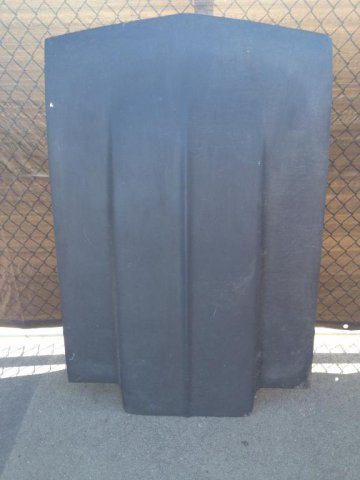

Atozone Tonine Posted October 15, 2013 Share Posted October 15, 2013 Well.. I went and did it. I got a Hartman fiberglass hood used.. extremely cheap. It sure is ugly, but the weight difference is amazing, and I'm hoping it will allow the hot air to escape the engine compartment, when going low speed (which is all i do really). It has had a minor repair on the underside and one of the brackets is loose, but I I think I can fix it, and make it look much better. I will be installing it this weekend. Quote Link to comment Share on other sites More sharing options...

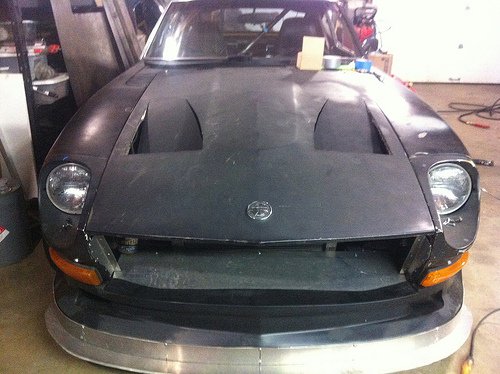

Atozone Tonine Posted October 15, 2013 Share Posted October 15, 2013 This is what I was thinking for the GT40 style vents ... looks like it would be great for air flow through the radiator. I cant remember where I got this image. But I just realized, that what I REALLY want is the competition hood, in one piece fiberglass. I think that would sell well, because A) it was an OEM option (though dealer installed), it maintains the Z car bulge shape, and C) having it in one piece would certainly be much better than the way the originals were installed. There was some chatter about ZForce producing some here: http://forums.hybridz.org/topic/97410-datsun-competition-hood-scoop/ Quote Link to comment Share on other sites More sharing options...

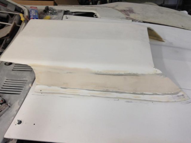

Poundz9oh9 Posted July 24, 2014 Share Posted July 24, 2014 Bought the scoop here; http://www.racecomposites.com/ss.htm Then had a body shop cut the hood and mold it on. Fiberglass to steel = no bueno. Only lasted about a year before the outside of the scoop started showing some shadowing where it was attached to the steel hood. Too many hot/cold cycles at different rates caused it. If you want to do something like this I would HIGHLY recommend starting out with a fiberglass hood. Once that hood started showing those signs of shadowing, I sent the hood off to have a mold made for a true single piece carbon fiber hood. That was in like December 2002 ish and I'm still waiting for it to be completed. The last pics I got of the project (in the not too distant past) looked great and it's still in the works, albeit a little slow, but I'm still holding on to hope The original was sold on ebay, never to be seen again within the first six months or so of me sending it off. Sorry this was late, I stopped getting notifications on threads I've commented on for some reason, BUT I see that you figured something out. Maybe this will help somebody else in the future. Quote Link to comment Share on other sites More sharing options...

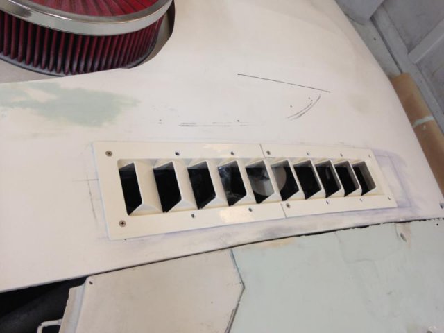

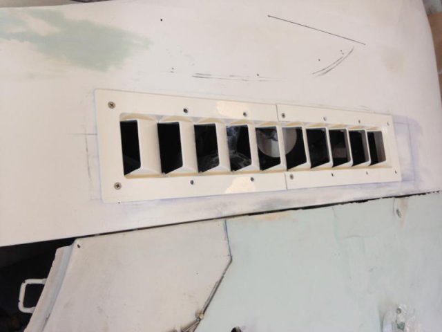

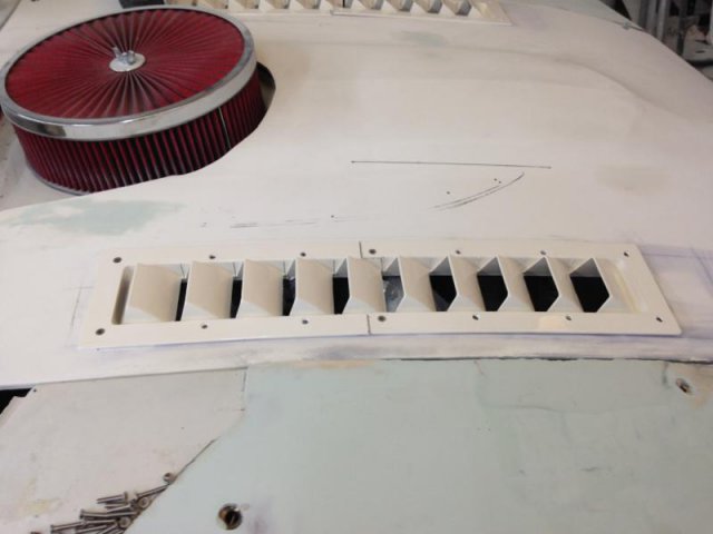

JMortensen Posted June 28, 2015 Share Posted June 28, 2015 (edited) I am working on a cowl and ram hood L88 scoop with vents for my autox car. It has a 5.3 with carb, so the scoop is functional, and the reason I wanted one open in both directions is that I had heard that a front facing scoop can cause issues with the secondaries on the carb. Had to modify it to clear the air cleaner. It was way too short out of the box. Vents to exhaust air had to be narrow and kinda side mounted so they don't feed hot air to the carb. They are modified boat bilge exhaust louvers. If I ever go FI I'd like to get rid of the scoop, and if it's allowed then, make a radiator duct to the hood. Only problem with the central rad exhaust is that it feeds hot air to the wing, which means less downforce. The car with the nostrils a couple posts up is Peter's, and he's a member here, FWIW. Edited June 28, 2015 by JMortensen Quote Link to comment Share on other sites More sharing options...

JohnH Posted June 28, 2015 Share Posted June 28, 2015 (edited) They are modified boat bilge exhaust louvers. How wide is the mounting base on the bilge louvers? I was looking at those on Ebay. However, they appear to be a little bit too narrow (5.25" wide) for what I need them for. The previous owner had put 79 280ZX vents on the hood of 240Z I have. Which aren't doing squat for heat venting as my triples are getting heat soaked in traffic. So I need to cover a hole of 7" - 8" wide. I'm also seriously considering putting on the 82 - 83 280ZX vents with the NACA ducts & hopefully with the placement of the old vent holes I can land the NACA intake just infront of the first Weber horn. Edited June 28, 2015 by JohnH Quote Link to comment Share on other sites More sharing options...
JMortensen Posted June 28, 2015 Share Posted June 28, 2015 They are the ones that you saw, 5.25" wide on the flange. You might have a look at these: http://www.hoodlouvers.com/. They come in a bunch of sizes. The holes in the louvers aren't very big, but they're definitely big enough to cover the 8" wide hole. Kind of a sidetrack, but if you use carb insulators and don't run a metal fuel rail that's bolted to the head or the mechanical fuel pump, you should be alright. Quote Link to comment Share on other sites More sharing options...
