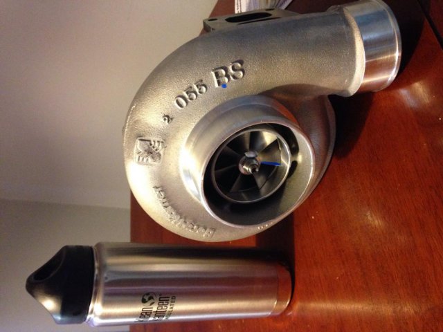

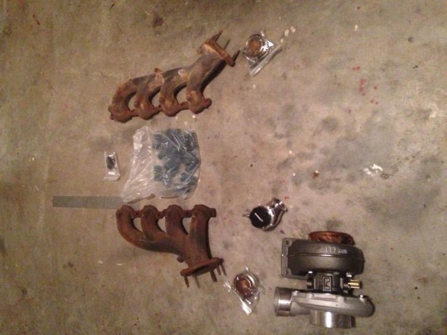

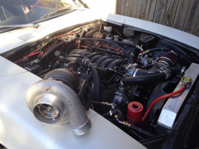

EastTnZ Posted October 16, 2015 Author Share Posted October 16, 2015 (edited) Well, due to peer pressure and mostly the need for speed, I will be jumping on the boost bandwagon within the next 6 months or so! After much deliberation I will be installing the following: -Borg Warner S366 .91 A/R Airwerks Turbo -down and forward truck non egr manifolds -2" hot side with a 44mm wastegate -3" cold side with a 50mm bov -10 lbs of boost and see where I'm at power wise -80 lb/hr ev1 injectors -dual walbro 255's -wideband O2 and boost gauges with a dual pillar pod mount -possible ls6 cam and springs -keep vintage air! I just could not have my Duramax faster than the Z! Edited October 21, 2015 by EastTnZ Quote Link to comment Share on other sites More sharing options...
crapforum Posted October 18, 2015 Share Posted October 18, 2015 What made you chose that turbo? I'll be following this one, your build helped me a lot when I did mine. Quote Link to comment Share on other sites More sharing options...
EastTnZ Posted October 19, 2015 Author Share Posted October 19, 2015 (edited) Thanks for the compliment! I'm glad somebody could get some use out of what I posted! I went with Borg Warner because they're one of the top 3 manufacturers of quality turbos (couldn't bring myself to go Chinese on the turbo), it's the largest s300 series turbo at 66mm, and ive seen a few single 5.3 s366 builds and they meet my 500-550 minimum rwhp goal at fairly low boost. The turbo is rated at 320-800 hp but it's not an s400 size package. I could always swap a t4-t6 adapter and put on s475 if I planned for its size now. Oh and it's cheap! Lol Most people do run dual s366's for BIG POWER but I don't have the room with an ac compressor on the drivers side. I have a feeling that 500+rwhp is enough for me in this tin can! I'm only at 274rwhp right now so it'll be a big boost! and I'll list all the specs as its completed in this thread so stay tuned! I'll probably have frost mail order tune it first for a startup tune to check for leaks. Unsure where to go for a dyno tune near me at this time though. **edit: Frost doesn't do mail order FI startup tunes anymore due to having to explain it 1,000+ times and it being a pita to keep retuning via mail because of so many variables, so I'm going to take it to be dyno tuned when it's ready.** Edited October 21, 2015 by EastTnZ Quote Link to comment Share on other sites More sharing options...

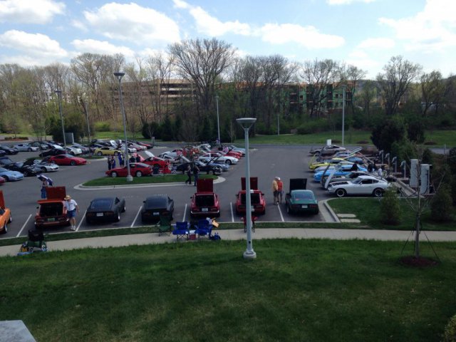

socorob Posted October 21, 2015 Share Posted October 21, 2015 What and where is Zattack? Quote Link to comment Share on other sites More sharing options...
EastTnZ Posted October 21, 2015 Author Share Posted October 21, 2015 (edited) ZAttack is the z show at Nissans U.S. Headquarters in Franklin, TN just south of Nashville, TN. It's every other year and 2016 is the next one. It's put on by the Middle TN Z Club. Oh and it's in April! Edited October 21, 2015 by EastTnZ Quote Link to comment Share on other sites More sharing options...
RebekahsZ Posted October 21, 2015 Share Posted October 21, 2015 How much money does that picture of parts represent? Quote Link to comment Share on other sites More sharing options...
