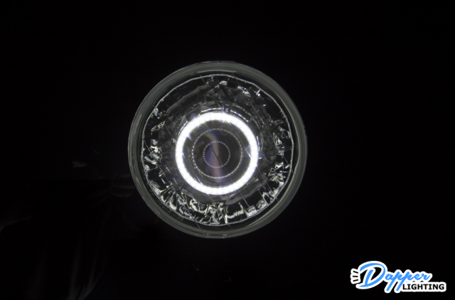

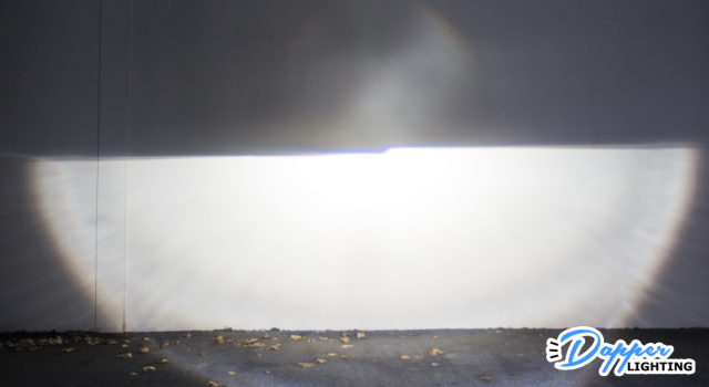

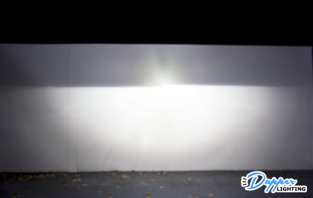

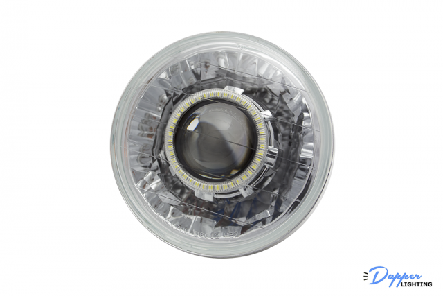

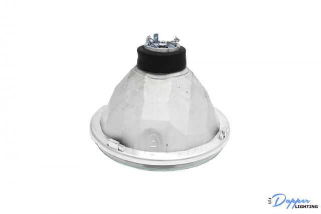

bens1088 12 Posted December 12, 2013 Share Posted December 12, 2013 (edited) All of our units are completely plug and play and come with a 5 year warranty. If you can source your own HID kits, you can get a kit from us with all the necessary wiring for $269. It's an extra $100 to add an HID kit but it also comes with a 5 year warranty. Most folks are running our 7" Classic Chrome and Black as well as our Modern Matte/Gloss. Here's a link to some pictures of the MSA Z Car show. Most of the images are s30s with Dapper Lighting headlights on them. http://www.dapperlighting.com/blogs/gallery PS. Our Classic V2 is out. Comes with a much larger projector and extremely bright LED halo. Stock: Classic V1: Classic V2: Edited December 12, 2013 by bens1088 Quote Link to post Share on other sites
