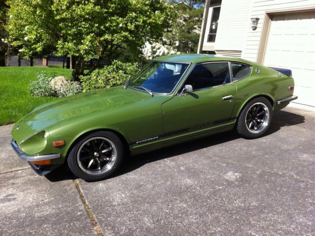

Xnke Posted January 24, 2014 Share Posted January 24, 2014 That's the whole reason I went to the 17x7 wheels I have on the car. I had 15x8's with 225/50/15's, but the tire selection wasn't there. Quote Link to comment Share on other sites More sharing options...
seattlejester Posted January 24, 2014 Share Posted January 24, 2014 I have 15x7+0's and I rub on my rolled fender with 225/50/15's on big dips on the rear (stock style suspension). I agree, the tire selection is pretty limited. If I wanted to go to a 9 inch with the 15 inch rim, I think the consensus was to run a wider then listed size, like a Toyo 888 and even that would be a stretch. I think I will be stepping up in the near future once I'm through my current sets. I kind of agree with the whole never too much tire statement, as even my modest L28 can break the tires loose in second, but I think there really is a balance. Too much tire, and the engine can feel a bit boggy. If a lightened flywheel makes a difference, just imagine what a thin, light wheel with thinner lighter tires would do for ya. And if you have a lot of power and a lot of tire, I think the halfshafts and stub axles may need to be looked at as the weak point in the assembly. Quote Link to comment Share on other sites More sharing options...
RebekahsZ Posted January 25, 2014 Share Posted January 25, 2014 Hey Xnke - with 17X7s, did you have to cut the airdam and front fender to clear the tire when turning? What size tire did you mount on that? Quote Link to comment Share on other sites More sharing options...
