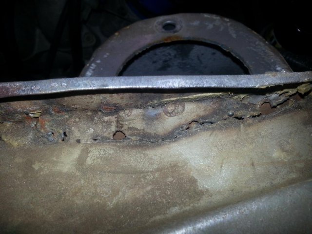

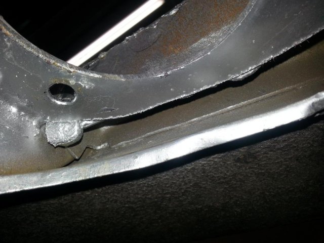

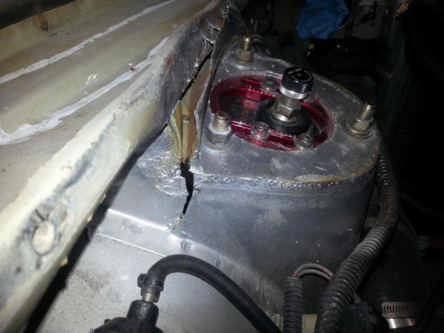

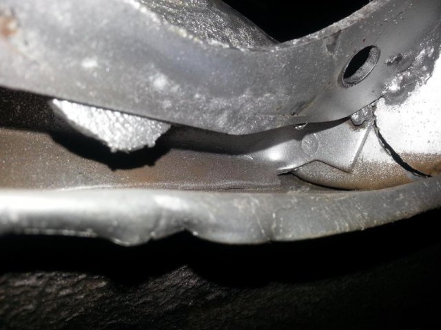

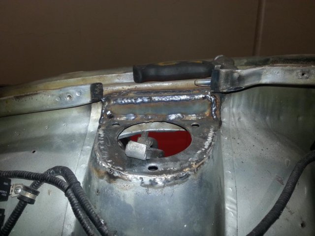

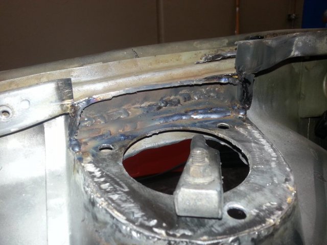

Tony D Posted February 8, 2014 Share Posted February 8, 2014 Poor fabrication work. All the strength was cut out of the strut tower. Post the name of the fabricator so we can all avoid the shop. They are going to kill someone some day. I agree with JC on this, the quality of the engineering work is not "workmanlike" which is the standard in CA. This IS NOT anything you need a lawyer to settle or litigate. The Steps: 1) return to shop and have them make it right. That means perform the modifications in a workman like manner. That means without the hideous monkey welds and properly radiused cuts that do not promote concentrated stresses that promote sheet metal tearing. They will eat this cost, if they deem parts are now required that cost sharing would be negotiated but lean heavily to it was what should have been done in the first place. Alternately, you take it to another shop (see JC's tag line) for estimates on PROPER installation/repair of the components. Present this to the original shop for consideration on payment. If they refuse...and refuse any refund of monies paid... 2) Spend the $40 in Small Claims Court, and go for the costs to make it right. Once you have a judgement, collecting is your problem, my personal favourite is to get with the Sheriff and show at the shop for confiscation of shop equipment or inventory for resale equivalent in (wholesale) costs to your judgement. The monies here and failure don't warrant anything above small claims court. Use your relatives to coach you on how to present and to prepare, but they can't use a lawyer there, either. It's easy and fairly quick. Quote Link to comment Share on other sites More sharing options...
Tony D Posted February 8, 2014 Share Posted February 8, 2014 And, as my lawyer once told me: "Truth is an absolute defence!" Listing the name of the shop in conjunction with the photos of the workmanship and failed components in a post soliciting opinions is far from being either libelous or slanderous. It merely informs people of your experiences. What people choose to do with that information afterwards is up to them Though likely a lawyer would say to not mention the shop until negotiations or litigation are complete to use as leverage to get concessions... Quote Link to comment Share on other sites More sharing options...

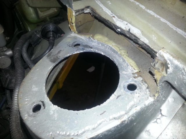

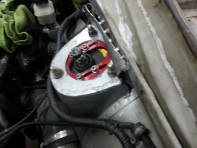

New-to-240z Posted May 12, 2014 Author Share Posted May 12, 2014 **Update 5/12/14** After talking with several officials and local welding shops I decided that the current company will no longer be allowed to touch my car. The work that they performed on my 1973 240Z was considered to be done by an unlicensed (or poorly, poorly, poorly trained) welder. On top of that, the work itself would not pass ANY inspection when taking my car to the track. How this company allowed my car to leave the shop in such a condition is beyond me. I spoke with Adrian over at Vildini MotorSports and was LUCKY enough to get my car in for him to give it a once over and re-do the work correctly. I just received word back from Adrian that the front end work has been completed, and I wanted to show you the completed work . . . Here is the work performed by the OTHER company . . . After all was said and done this is the work performed by Adrian . . . WORLDS better and done RIGHT! Thank you AGAIN Adrian for the quality work that you do. I will update everyone with the Original shop's name as soon as litigation is completed. I'm having Adrian also resolve the issues that I have been having in the rear of the car (also done by the other shop!!) once he has more time. Quote Link to comment Share on other sites More sharing options...
Nite_Grind Posted May 24, 2014 Share Posted May 24, 2014 Love the new bar! BEEFY! Sucks to see what happened. I'm local, and I never plan to let anyone touch my z that shouldn't. This is a perfect example as to why I will not. I'm blessed to know welders, and good ones. Also, in regards to the "OTHER COMPANY" I hope they are not the same welders that have welded the megan coils to your factory spindles? If so have that rechecked as well. GL w/ your race season when it begins. Joel Quote Link to comment Share on other sites More sharing options...
Tony D Posted May 24, 2014 Share Posted May 24, 2014 Good to see you got it repaired...and that it actually WAS repairable. I hope you don't get or let any non-disclosure clauses become involved in whatever financial settlement you work out, as this is someplace to steer clear of.... Quote Link to comment Share on other sites More sharing options...
ww Posted June 15, 2014 Share Posted June 15, 2014 That is an impressive repair. You can clearly see where Adrian beefed up the weak points and that strut bar is nicely done. Quote Link to comment Share on other sites More sharing options...
