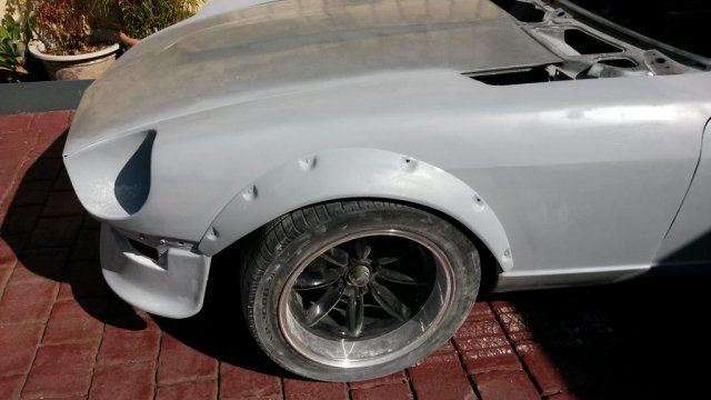

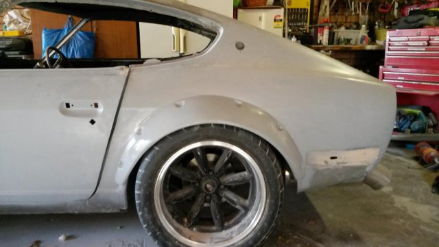

Retro Z Posted January 31, 2014 Share Posted January 31, 2014 I'm in Australia and purchased from Oscar at jdmflares.com based in the US. Very happy with the flares and service.Good quality and fit. Resonably priced at $300 and look almost the same as your first picture but with the front flares just as wide. Zforce productions never ever replied to my facebook posts, messages or emails so i wouldn't recommend them. Quote Link to comment Share on other sites More sharing options...

Retro Z Posted January 31, 2014 Share Posted January 31, 2014 Do you have any pictures of the jdmflares ones installed? Fits like a glove. A couple of them had a chip/blister/pinhole that i just smeared some bondo into but otherwise they are perfect. Its made from a fleece instead of matting which i think makes it less brittle aswell. Quote Link to comment Share on other sites More sharing options...

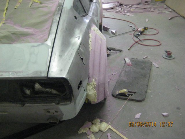

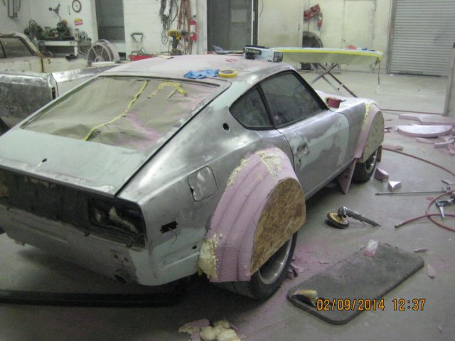

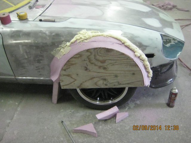

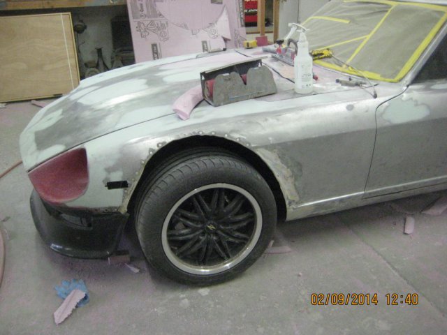

d-phlip Posted February 9, 2014 Share Posted February 9, 2014 You might just try building them yourself! I have a 72 240Z with 6 liter LS2 and T56 6 speed. After the engine/trans install (by Dave - (Viperredls1z), we did a 4 wheel Willwood disc brake setup from Arizona Z Car and while I was doing that, I opted for the package with 5 x 4.5" lugs which gave me the option for larger tires and wheels. I got a set of wheels (11x17 rear and 9x17 front) and mounted Michelin 335-35/17 rears and 275-40/17 fronts. The car originally had hand built flares, but they were poorly done and in any case did not cover the larger tires. This gave me the perfect opportunity to do some paint and bodywork that I have been putting off. The car is in Ralph Garza's Body shop in Roseburg, Oregon for complete body work and paint. Check my facebook page: Datsun V8Z. The first big project was fender flares. I made templates out of 1/2 inch plywood that would be the outside opening of the flares. The template radius is 1 1/2 inches larger than the tire radius. I located the center of the template 1" above the center of the wheels/tires, allowing for a bit more suspension travel. This weekend, Ralph and his buddy John from Portland (who has done SEMA class winners) started mocking up the flares. They are using rigid styrofoam blocks and spray foam to construct a workable surface, then filing and sanding down to a final shape. Hopefully this will be done this weekend, and the fiberglassing can begin. I have included a few pictures, and there are a lot more on the Datsun V8Z facebook page. Good luck! Quote Link to comment Share on other sites More sharing options...

d-phlip Posted February 13, 2014 Share Posted February 13, 2014 Please do. I am interested to see what they turn out like. It looks like you are keeping the Datsun lip on the fender that so many just put a rolled edge on. I talked to him today, and he didn't say he wouldn't do it, but he thinks (and I agree) that there is a pretty limited market for 240Z flares for 335/35-17 (or similar width) tires. If he decides he will consider it, I'll let you know and put you in touch with him. Quote Link to comment Share on other sites More sharing options...
