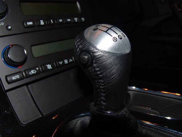

alainburon Posted February 4, 2014 Share Posted February 4, 2014 LG Motorsports makes this one, maybe not what you are looking for but still an option. Quote Link to comment Share on other sites More sharing options...

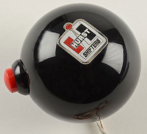

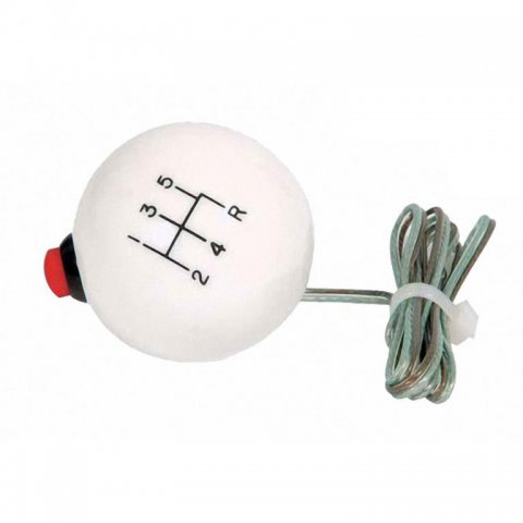

RebekahsZ Posted February 4, 2014 Share Posted February 4, 2014 (edited) It's not as pretty as that knob, but I use a Hurst Sidewinder knob. I have a white knob with a red button for my thumb. I use it as a line-lock/roll-control instantaneous switch for burn-out in the water box. I also use it at intersections like a e-brake to keep me from rolling backwards on a hill. Beware of the thread pitch. For my MGW T56 Camaro shifter, the thread pitch is the same as a Ford 5-speed. The GM T56 6-spd knob has wrong thread pitch for my stick. So, I have a 5-spd pattern on my 6-spd stick, but I'm pretty sharp for a country boy, so I can remember! The black knob doesn't have a pattern on it, but I like a white knob. If you go this way, again, be sure to check the thread pitch. And, yeah, $60 for a piece of plastic is insane. I don't know what you are referring to with "powering thru the lockout." I don't know if my programmer did anything special or not, but I have no problems with a reverse lockout-I just drive the car and it behaves like any manual shift car should. Edited February 4, 2014 by RebekahsZ Quote Link to comment Share on other sites More sharing options...

socorob Posted February 5, 2014 Author Share Posted February 5, 2014 The knob I posted is just a reverse lockout button for an automatic, not a switch. That LG knob may be a happy medium since the button doesn't jump out at you. Quote Link to comment Share on other sites More sharing options...
