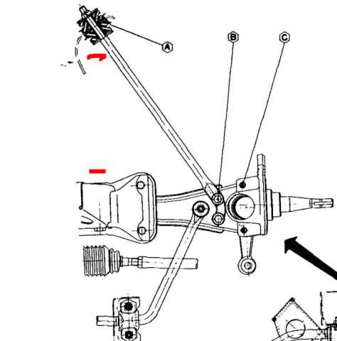

Chickenman Posted July 22, 2016 Share Posted July 22, 2016 The stock Z car toes-out under braking. Hmm... this could be an interesting Technical discsussion Interesting because the Z is a front steer ( Steering arms ahead of axle centerline ). Front steer cars normally have neutral or Toe-in under braking. Thrust forces under braking, push control arm rearwards as suspension bushing compressed. Steering Tie Rods are shortened in Arc, which pulls steering arms closer to each other . This adds Toe-in under braking to counter-act the natural Drag forces on the tire that is trying to add Toe out. Rear steer cars ( Steering arms behind axle center--line ) can be a bit more problematic. Deflection changes in the control arm tend to add Toe-Out unders braking ( and cornering ) There are a few examples of this type of discussion on FSAE forums, but Herb Adams mentioned some of the advantages of Front Steer in his book " Chassis Engineering " on page 58. Interesting reading: https://books.google.ca/books?id=rY2ujnNrhf0C&pg=PA58&lpg=PA58&dq=Effect+of+Front+steer+and+rear+steer&source=bl&ots=HgODf6wQ6C&sig=VD1jWdUzvn0i9OrrvmtN7ww1XXs&hl=en&sa=X&ved=0ahUKEwihk5mNwYfOAhVV92MKHXwGDFQQ6AEIJzAB#v=onepage&q=Effect%20of%20Front%20steer%20and%20rear%20steer&f=false Quote Link to comment Share on other sites More sharing options...

JMortensen Posted July 22, 2016 Share Posted July 22, 2016 It toes out under compression, which happens under braking. Stock TC and LCA bushings might allow more toe change than the bumpsteer creates, but who is running stock bushings??? Quote Link to comment Share on other sites More sharing options...
RebekahsZ Posted July 22, 2016 Share Posted July 22, 2016 I'm just stating facts as I observe them physically-I don't yet understand the "why" of it. Over the next month or two, I'm gonna be trying to adjust this tendency out if I can. When I autocross (really not more than a couple times a year) or a track day (once a year), I let other folks drive my car, sometimes with me in the car, sometimes I just let other folks take it. I get lots of compliments on how well it turns in (it's the only car I've ever driven hard), and I get suggestions on how to improve the car and my driving. Since the car toes-out on forward weight transfer, I don't think we need to run a lot of static toe. Just fly up to the corner and pile on the brakes, then turn before the front unloads. If you don't slow enough, you won't have enough traction to change directions-go too slow and you lose time and exit speed. Getting that little maneuver together is pretty hard in and of itself. But it's not the car so much as the driver. I DO think I'm running too much camber and it is hurting my straight line braking. I'd like to come from -3.5 to -2.5 but my bolt in camber plates limit precise adjustment. Quote Link to comment Share on other sites More sharing options...
NewZed Posted July 22, 2016 Share Posted July 22, 2016 Ignoring bumpsteer (I think I know what that means) you can see that the flexible components of the front suspension can lead to toe-out as the wheels get pushed back. The steering gear can remain static, while the bushings compress. Braking must put some extra strain/wear on the steering gear also since it ends up under a higher tensile load. Urethane or solid bushings at the T/C rod and control arm probably help it last longer, and reduce toe-out. Quote Link to comment Share on other sites More sharing options...

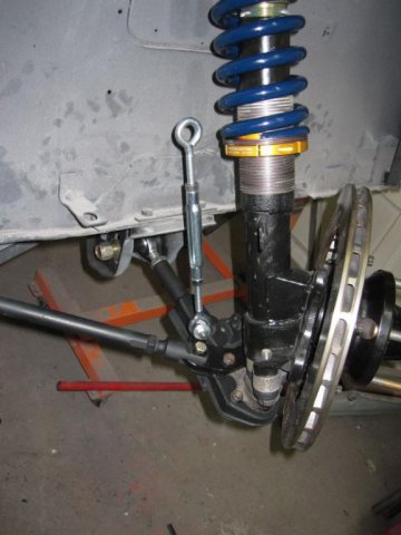

Chickenman Posted July 30, 2016 Share Posted July 30, 2016 (edited) Edit: Another product that is readily available now, is bump steer spacers. These correct the geometry of the A-Arm on lowered cars so it has a downwards slope again ( important for Camber gain during cornering, particularly on Mac struts ) and they also reduce Bump steer. It's a bit more elegant solution than moving the pivot location upwards. Relocating the pivot upwards corrects the Camber curve in roll, but does nothing to correct Bump steer. Something to consider. You can get software programs to analyze suspension movement. Price varies all over the map and depends on complexity. A little searching on Google will even find some Free programs. Usually Trial periods with limitations on function, but there are some Fully functional " Freeware" or Shareware programs that are fully functional. I personally haven't tried them though. Formula SAE sites are usually good. Student rates are also available. Here is one Free version that may be useful: http://suspensioncalculator.com/download.html There are also some basic " Real Time " models/calculators that you don't even have to download. This looks promising: Note: Logging in unlocks some more functions. http://www.racingaspirations.com/ And the Mac Strut calculator: http://www.racingaspirations.com/apps/macpherson-geometry-calculator Edited August 1, 2016 by Chickenman Quote Link to comment Share on other sites More sharing options...
