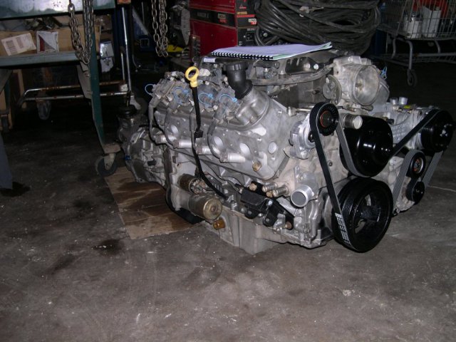

Kevin.pk Posted March 25, 2014 Share Posted March 25, 2014 i'm guessing this is specific to the A/C install. Is it for the Idler in this pic? (not my car. borrowed pic from old post by savage42) Quote Link to comment Share on other sites More sharing options...
socorob Posted March 25, 2014 Author Share Posted March 25, 2014 Yes its for that one. The bolt for the alternator goes through it. Quote Link to comment Share on other sites More sharing options...
alainburon Posted March 25, 2014 Share Posted March 25, 2014 On 3/24/2014 at 10:29 PM, socorob said: I've been making slow progress on mine. When I first put it in a few months ago, the part that relocates an idler pulley didn't fit. He calls it the spigot. Went to napa to see if they had a bearing with the same size OD as the one in the LS pulley with a smaller ID. The one he sent was too small. No go. I called John and he said machinist had a heart attack and is in hospital or something and went and checked and batch is made wrong. Of course I got the 1st from that batch. He sent me another bearing with a little piece of metal bent into a curve. It's supposed to take up the slack between the spigot and the bearing but its still not enough and I don't want to use it because its not even a bushing.It has about 1/32 of slop when it's installed. It's been a few months and he said he still hasn't been able to get the proper one. Anyone else has this problem? I don't want to do to a machinist to have this made, or borrow my friends lathe because I paid for the part and got sent the wrong one. I'm getting close to start time and can't even start the car with that piece. I had the same problem. I just had a machinist make me another one. By the way, the picture 280Zcar posted is not how the JCI A/C kit is supposed to be mounted. See picture for proper mounting (According to John). Quote Link to comment Share on other sites More sharing options...
socorob Posted March 25, 2014 Author Share Posted March 25, 2014 Yeah I think mine is more above as in the 2nd picture. I will double check. The 1st picture probably doesn't have enough belt to pulley contact. Quote Link to comment Share on other sites More sharing options...
