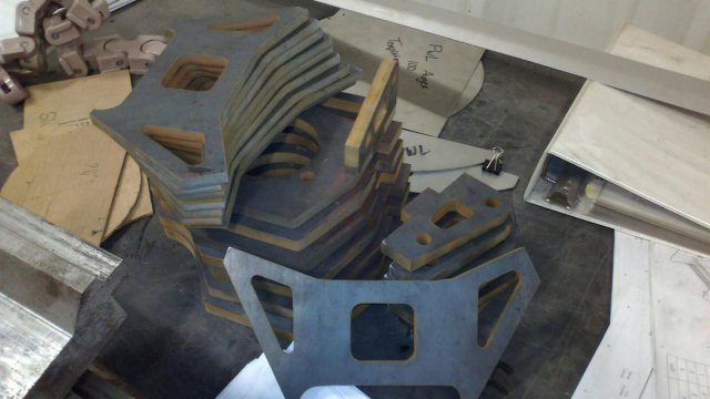

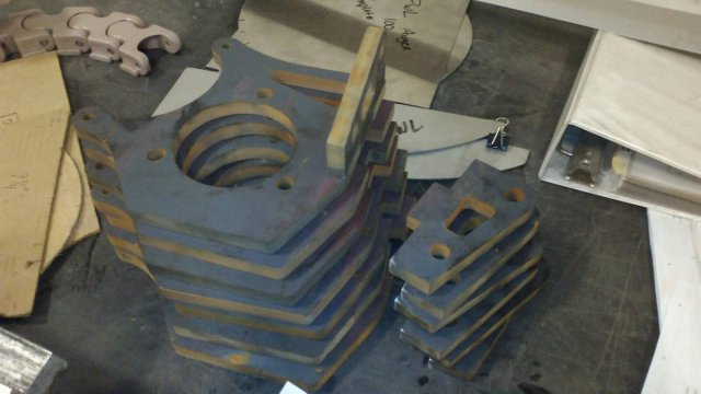

wfritts911 Posted October 3, 2014 Author Share Posted October 3, 2014 (edited) As far as the explorer housing goes: - It is easier to find/cheaper - It already comes with the stronger/better cover - I believe the housing is actually stronger than the cobra one - The mustache bar handles the forces that try to roll the diff over, the front diff mount only keeps it from pitching up or down. I think having two mounts in the front could be a bad thing especially if the rear diff mount became loose or something, the front mounts would try to take loads they were never designed for Those are just some thoughts, none of them really matter other than the easier to find/cheaper. Strength is not an issue with either differential. On another note, I'll just leave this here: Production has officially began! This is 7 of 10 "backing plates", will be getting the other 3 cut tomorrow and cutting all the 3/8s plate for the broke brackets to finish up the uprights. Will be mocking everything up this weekend so I can cut the front differential mounts, mustache bars, and everything else on Monday. I plan on getting everything powder coated black unless anyone objects. Will keep y'all posted as things progress, hopefully will start having uprights welded up monday as well. P.S. Sean, when are you going to pay me enough to quit my day job so I can just build cars/cool shit all week for you? -Will Edited October 3, 2014 by wfritts911 Quote Link to comment Share on other sites More sharing options...

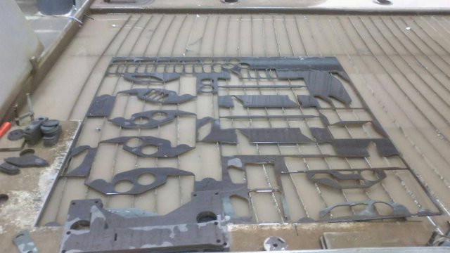

wfritts911 Posted October 13, 2014 Author Share Posted October 13, 2014 (edited) I'll just leave this here... There is 5 sets of front diff mounts, rear LCA dropdown, and some upright pieces. There are also some top secret BMW E30 LS1 motor mounts and trans mounts hidden in there(Hint hint for anyone interesed in doing an E30 swap hehe). -Will Edited October 13, 2014 by wfritts911 Quote Link to comment Share on other sites More sharing options...
