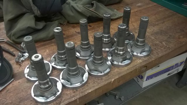

wfritts911 Posted November 6, 2014 Author Share Posted November 6, 2014 Got the stub axles ready to weld. Uprights just need one small portion tig welded. Strut tubes are pretty much the only thing left to fab. I'll get some more pictures of uprights and everything else tonight. Finally got a new phone Quote Link to comment Share on other sites More sharing options...

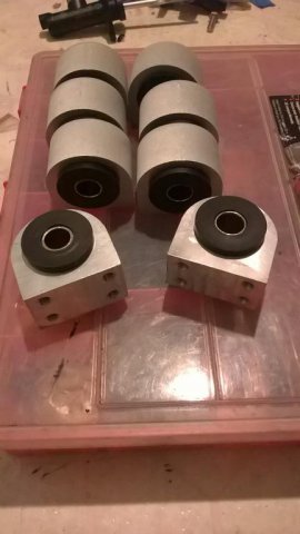

wfritts911 Posted November 6, 2014 Author Share Posted November 6, 2014 There's the left overs. Lots of chips from not that much metal Quote Link to comment Share on other sites More sharing options...

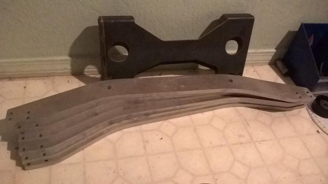

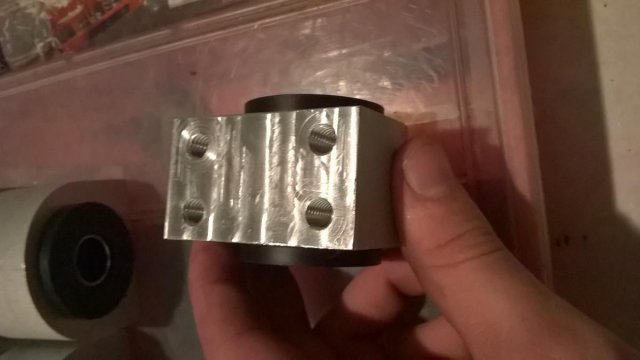

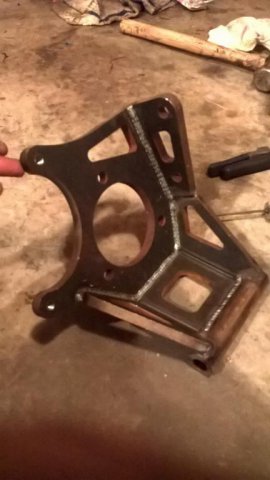

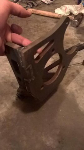

wfritts911 Posted November 7, 2014 Author Share Posted November 7, 2014 Some pictures Quote Link to comment Share on other sites More sharing options...

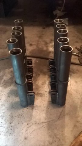

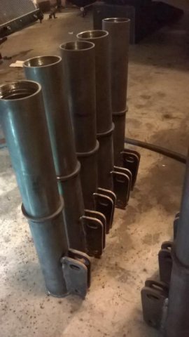

wfritts911 Posted November 10, 2014 Author Share Posted November 10, 2014 Ok so everything is pretty much done other than some finish welding on the axle flanges. My welder was going to finish tonight, but got held up with a last minute job at work so he is working pretty late tonight. Finished the strut tubes up Sunday night. Will be boring the rotor hats out tonight, had to get a new cutter insert that I couldn't get last night. Pretty much waiting on my welder to finish up which will hopefully be tomorrow, and I'll be dropping everything off at the powder coater. I will post some pictures shortly. -Will Quote Link to comment Share on other sites More sharing options...

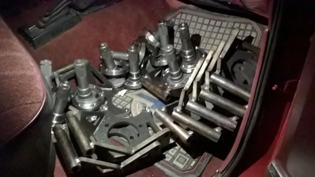

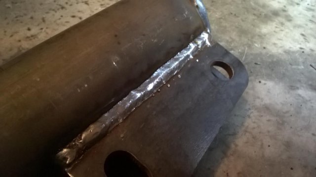

wfritts911 Posted November 10, 2014 Author Share Posted November 10, 2014 Pictures. Quote Link to comment Share on other sites More sharing options...
