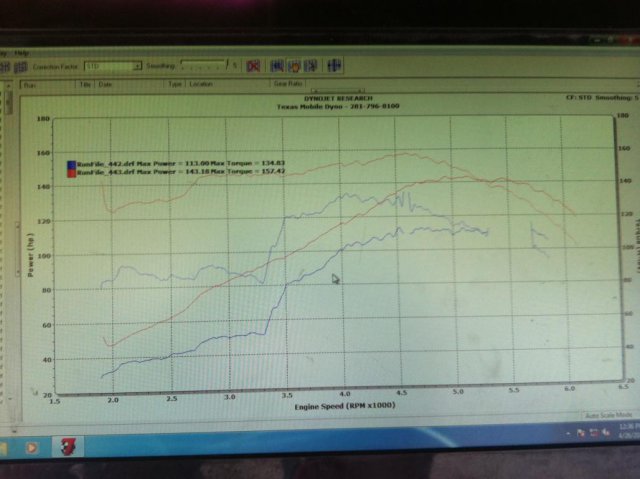

steve260z Posted April 29, 2014 Author Share Posted April 29, 2014 Well, with the video and the dyno graph what's your gut feeling regarding the motor cutting out past 5K? I'm going to double check all the connections on the Crane unit and try another distributor I have on hand. Steve Quote Link to comment Share on other sites More sharing options...

Xnke Posted May 1, 2014 Share Posted May 1, 2014 You are probably very rich past 4k, which is close to peak torque for a 35mm runner diameter. once past the torque peak, fueling demands start falling and if the carbs are too rich you see power falling off. I stand by what I said, however. Spending Money on the bottom end is not going to help horsepower until you've spent the money in the head. Quote Link to comment Share on other sites More sharing options...
steve260z Posted May 1, 2014 Author Share Posted May 1, 2014 Yeah, I didn't mean to be a dick. Its just that I wanted a stroker not a ported and polished 2.6L. I can still get head work done. Realized that before starting the project but wanted to get a baseline performance of the stroker and go from there if needed/wanted. What if anything do you make of the motor cutting out on my dyno video. Car was run to 6k on the video. Thanks steve Quote Link to comment Share on other sites More sharing options...
Xnke Posted May 1, 2014 Share Posted May 1, 2014 I would check plug gaps, and do some plug chops during the breakup to see what is happening in the chamber, since you don't have a wideband yet. Quote Link to comment Share on other sites More sharing options...

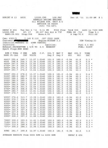

steve260z Posted May 4, 2014 Author Share Posted May 4, 2014 (edited) yeah, it was a mobile Dyno at the track. Wished they had one too. Either way I needed to get the wideband anyway. Trying to convince my neighbor to drag his welder unit into my garage today and get it hooked up. Here's a guy with a stroker, stage 3ish cam and 40s. Laid down 220 HP and Torque at 5,550rpm. Edited May 4, 2014 by steve260z Quote Link to comment Share on other sites More sharing options...
roger280zx Posted May 4, 2014 Share Posted May 4, 2014 zredbaron spun a dynojet to 264, a bit more compression (12:1), deduct about 3% for the reduction in compression and you have 256. This is what an optimized head/cam will do on a quality 3.1 with a very good header and theoretically too small 40mm carbs. The power is in the head, always has and always will be. Quote Link to comment Share on other sites More sharing options...
