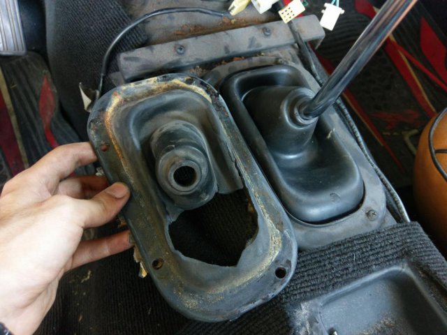

Zetsaz Posted July 9, 2017 Author Share Posted July 9, 2017 (edited) Minor project to keep me motivated recently. There was a ton of play in the shifter, so I went to an auto parts store and picked up an assorted pack of door hinge bushings. For those curious, the write-up is on Atlantic Z. Took less than half an hour and it feels much better! The order I do some of these random side projects is probably not the "right" way to got about a restomod, and maybe it slows down other things, but honestly if it keeps me motivated and stops the whole project from stagnating that's all I really care about. In my mind as a relative amateur, all progress is good progress. Best $5 I've spent. Had a friend that was going to let me borrow a mig welder, so we'll see if I can learn a thing or two in the next couple weeks on some of the portions of the car that aren't as critical and are out of site. Edited July 9, 2017 by Zetsaz Quote Link to comment Share on other sites More sharing options...

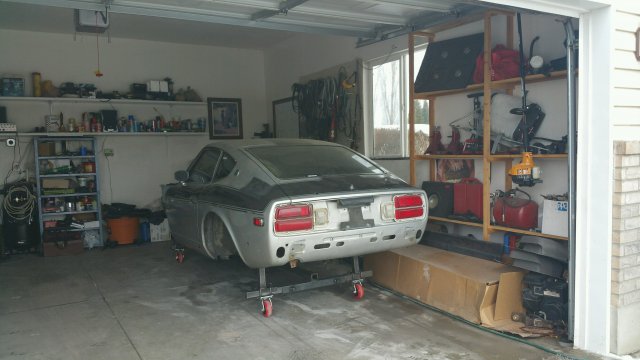

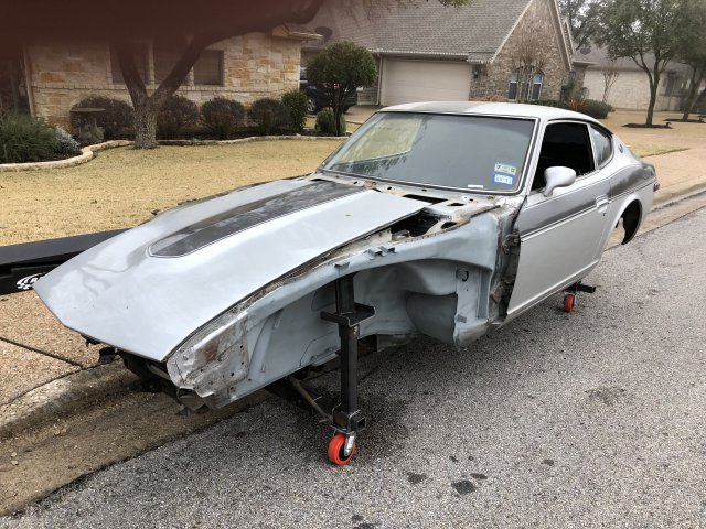

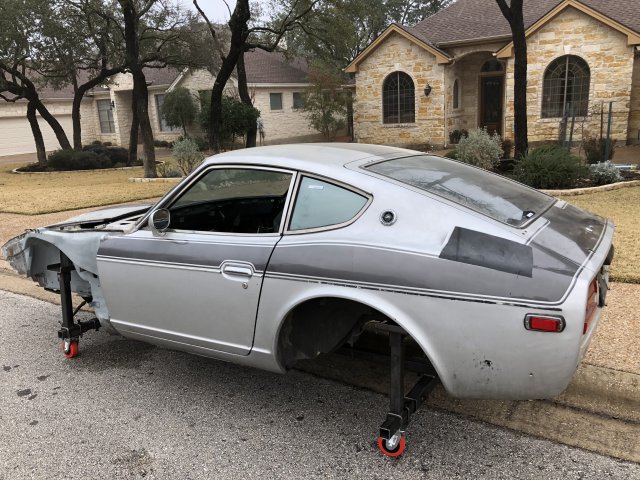

Zetsaz Posted February 27, 2018 Author Share Posted February 27, 2018 (edited) Update time: This is the new shell that is now safely at my house taking up more space in my dad's garage haha. (Fortunately my first car, the Celica that spun a bearing before I moved was scrapped over the holidays when I had a chance to get it there. The Maxima I moved to washington in is also in a junkyard somewhere now). It feels really satisfying to know this thing is comfortably stored now waiting for some work. User Madovic from here is who I purchased it form and honestly I wasn't expecting nearly as much stuff to come with it as I got. I also went for the freshly rebuilt R200 CLSD he had. He dropped the price on the LSD substantially since I was buying the shell and gave me a rock bottom price on the shell to get it out of his way for his new project. I'm not sure I could even properly redo the floors and rails on the other car for what I got the shell and LSD for, so I'm really happy to have done business with him. Genuinely one of the most honest private sellers I've ever dealt with for anything, but I digress.... I also got some other fun goodies.... I got a lot of fun goodies, the most expensive of which will be transferrable to other things I might want to use in the future, but in the meantime will help me learn a whole lot more about EFI tuning: MS3X 2 sets of harnesses required for MS3 and MS3X Coil on Plug setup using LS coils on a custom braket for the L series ZXT distributor with diyautotune optical trigger wheel ready to send signal to MS Fuel rail with modest 315cc injectors since I'm not going turbo (yet at least...) 60mm throttle body with 240sx TPS GM idle air controller and DIYautotune bypass block A few other things I'm probably forgetting. Some of my favorite cars recently have been the MZR roadsports Zs. Nothing outrageously different done as far as styling but much more modern tech running everything, which has always been my goal. In the future I might go a different direction with the engine down the road, but finding deals like this, especially when the most expensive portion of the stuff (MS3) is transferrable will allow me to learn more about engine tuning and let me enjoy my current engine even more while not making me feel totally tied down by the investment I've made. Some pictures of the MZR cars to get an idea of the style build I'd go wtih if I stick with the L series long term. Obviously some of this stuff is way above my budget and the engine "shaving" is on the extreme side but it's nice to find cars like this that are subtle and follow similar mindset to my own. Edited February 27, 2018 by Zetsaz Quote Link to comment Share on other sites More sharing options...
Jboogsthethug Posted February 27, 2018 Share Posted February 27, 2018 Dang man!! That's awesome! As soon as I saw it I knew it was familiar, I bought a few parts from him as well! That's rad you've got yourself a solid shell to work on! And those Zs below are dang clean! That shave is so dang perfect, I really don't know how they got it so clean. I've shaved and tucked mine and it doesn;t look nearly as good! either way, glad to see you're on the road towards progress again! Quote Link to comment Share on other sites More sharing options...
Zetsaz Posted February 27, 2018 Author Share Posted February 27, 2018 2 hours ago, Jboogsthethug said: Dang man!! That's awesome! As soon as I saw it I knew it was familiar, I bought a few parts from him as well! That's rad you've got yourself a solid shell to work on! And those Zs below are dang clean! That shave is so dang perfect, I really don't know how they got it so clean. I've shaved and tucked mine and it doesn;t look nearly as good! either way, glad to see you're on the road towards progress again! Yeah, a lot of it is just for show though and really isn't practical. I LOOKS easy to work with until you realize that a fair amount of stuff that could go bad is tucked away in hard to reach places. I wouldn't quite go to the extreme they've gone, but I think they're great modernizations of the Z in many ways. Quote Link to comment Share on other sites More sharing options...
