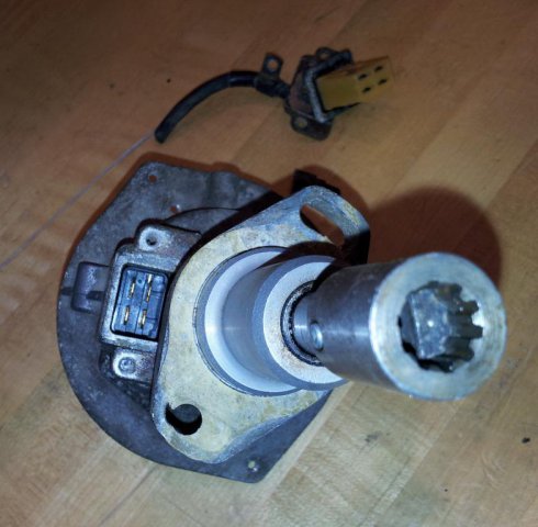

TheDeadZed Posted September 27, 2014 Author Share Posted September 27, 2014 So... stupid question... but im confused... pictures are what I have... have a strangle feeling i have the wrong dizzy... or that im retarded... dont know which Quote Link to comment Share on other sites More sharing options...
loy Posted September 27, 2014 Share Posted September 27, 2014 Pictured is the 280zxt 82-83 distributor. Did you get the 82-83 turbo distributor shaft? The one pictured is not. Quote Link to comment Share on other sites More sharing options...
cgsheen Posted September 27, 2014 Share Posted September 27, 2014 Correct. You can't just replace an '81 distributor with an '82-'83 distributor. You also need the distributor shaft from the '82-'83... Welcome to the wonderful world of dropping the oil pump and properly installing the shaft that drives the pump and distributor. Hint: know everything there is to know about this before you start. Installing the shaft improperly will cause you enormous headaches. Quote Link to comment Share on other sites More sharing options...

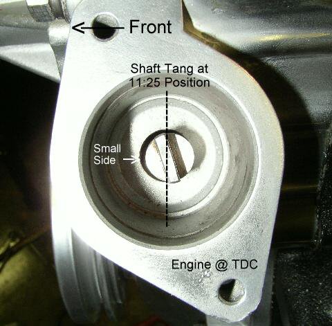

NewZed Posted September 27, 2014 Share Posted September 27, 2014 There's a useful picture on page EM-20. http://www.nicoclub.com/FSM/280z/ Quote Link to comment Share on other sites More sharing options...
