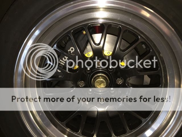

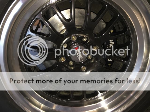

jschiff_g8 Posted April 4, 2016 Share Posted April 4, 2016 Alright so I installed the big brake kits front and rear from t3 and they fit and look beautiful!!! E-brake function works perfect! Only problem im having is that my pedal goes to the floor on the first push and then gets pressure on the second and so on. I think i still migh have air in the system, so i will rebleed the master and all four corners. When the brakes did grab they felt amazing haha. I have absolutely zero clearance issues. I took some pictures with the wheels on: These are xxr 531's 16x9 with 0 offset Quote Link to comment Share on other sites More sharing options...

jmhtx Posted April 4, 2016 Share Posted April 4, 2016 On 4/4/2016 at 6:19 PM, jschiff_g8 said: Alright so I installed the big brake kits front and rear from t3 and they fit and look beautiful!!! E-brake function works perfect! Only problem im having is that my pedal goes to the floor on the first push and then gets pressure on the second and so on. I think i still migh have air in the system, so i will rebleed the master and all four corners. When the brakes did grab they felt amazing haha. I have absolutely zero clearance issues. I took some pictures with the wheels on: These are xxr 531's 16x9 with 0 offset Out of curiosity what Master Cylinder are you using? What about the Brake Booster? Quote Link to comment Share on other sites More sharing options...
