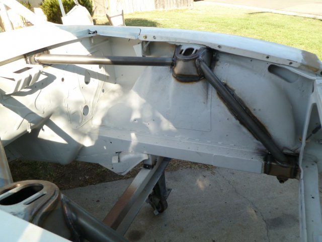

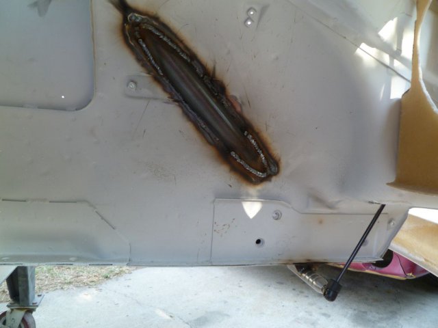

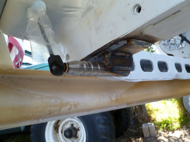

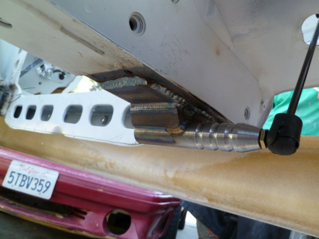

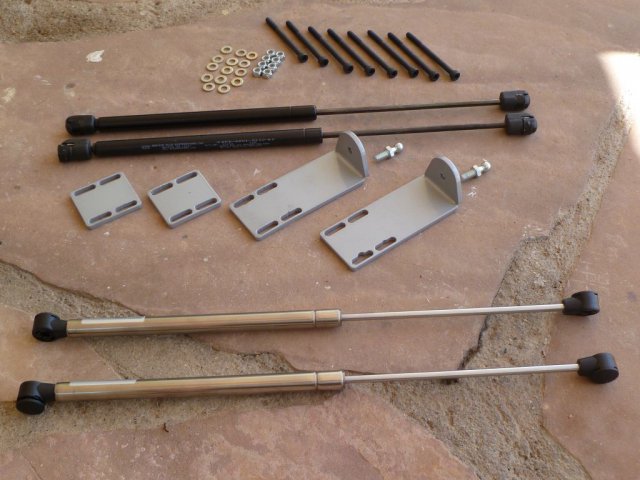

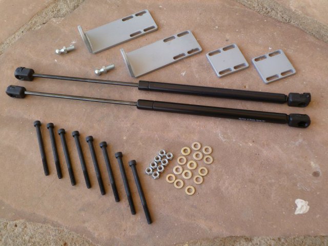

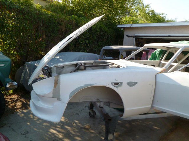

Nelsonian Posted December 27, 2014 Share Posted December 27, 2014 I'm not sure I am seeing this correctly, but if you are planning on removing the hood hinge spring I may have something that will help hold your heavy stock hood at any position without the use of the prop rod. I have the now defunct, Zrace Products, gas strut kit that I will not be using as I made a more of a weld on deal for my car. This kit sandwiches two plates on the front frame rails and uses two 60lb gas struts to hold the heavy hood at any position. This would require a little bit of modification to your car however, such as welding on small ball studs to the center of the hood hinges and cutting two small holes for the gas strut to fit through. Here are some pics of the kit and some of how I hard mounted mine to the bottom of the front frame rail. Quote Link to comment Share on other sites More sharing options...

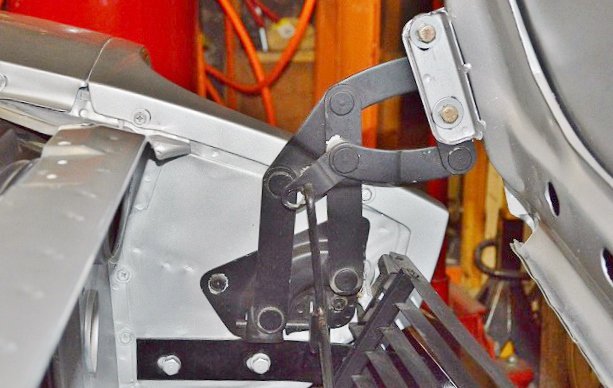

Miles Posted December 28, 2014 Share Posted December 28, 2014 Post some pictures of the hinges,and torsion bars, hood release and hood in the open and closed position (side and front angles). In the meantime don't grind or force anything. Quote Link to comment Share on other sites More sharing options...

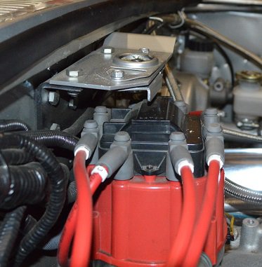

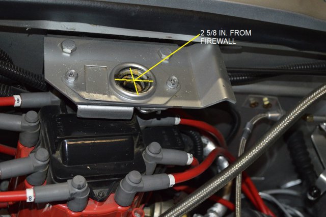

docjim Posted January 10, 2015 Author Share Posted January 10, 2015 OK. Here is the best picture I can get of my problem. As I said, the latch needs to be moved towards the rear of the car by 1 inch. The male part on the hand latch has to be pressed in order to get the barbed part into it's hole. if you do that, you can slam the hood and the spring part of the latch will pull into it's hole. the hood fits the way it should against the wiper cover. However, you have to pull very hard on the inside the car hood release and then fight with the hood's hand release in order to get it to release. Now in addition, a Nissan mechanic doing the wheel alignment tried to be helpful and make it easier to close by rotating the spring/hinge up and toward the rear. now, the front of the hood sits up above the fender by an inch. HELP! PLEASE! Quote Link to comment Share on other sites More sharing options...

Miles Posted January 11, 2015 Share Posted January 11, 2015 Need to show us photos of the hinges. Quote Link to comment Share on other sites More sharing options...
Phantom Posted January 11, 2015 Share Posted January 11, 2015 I'd be concerned about the long-term reliability of the catch plate mechanism too since they removed the support gusset under it to make room for the distributor. Is it possible your hood is coming down on top of the air cleaner and causing it to rise in the front? Quote Link to comment Share on other sites More sharing options...
Miles Posted January 12, 2015 Share Posted January 12, 2015 (edited) See atch hood latch pictures. Edited January 12, 2015 by Miles Quote Link to comment Share on other sites More sharing options...
morbias Posted January 12, 2015 Share Posted January 12, 2015 (edited) It looks like the hood is adjusted all the way forward at the hinge in that picture. And, it might just be me, but it looks like the tab that the bolts go through might have been removed and then re-welded to the hood, maybe it's not in the correct position? Also, as above, have you tried removing the air cleaner? Edited January 12, 2015 by morbias Quote Link to comment Share on other sites More sharing options...
docjim Posted January 12, 2015 Author Share Posted January 12, 2015 Miles, the pictures you provided look exactly like my setup. It did have to be moved to make clearance for the distributor. it's present position is 2 1/2 inches from the firewall. I'll try moving it another 1/8", but I am not too hopeful. Answers to questions and statements above: there is clearance between hood and air cleaner--not much, but there is clearance. also, when the hood is closed, the latch mechanism does pull the hood back into the correct position, but it a extremely difficult to open again. the long term reliability isn't an issue since this car will never be driven more than a couple of thousand miles a year. Quote Link to comment Share on other sites More sharing options...

Miles Posted January 12, 2015 Share Posted January 12, 2015 I just noticed that your latching plate is mounted the reverse of mine. My latch is on the top of the bracket that is bolted to the fire wall. Look at my picture of the latch. The way you have the latch mounted on the bracket shouldn't effect alignment, but it could allow the peg on the hood to strike the distributor cap when closing the hood. The legnth of the peg is adjustable. Quote Link to comment Share on other sites More sharing options...

Miles Posted January 23, 2015 Share Posted January 23, 2015 (edited) On 1/23/2015 at 5:56 PM, docjim said: OK, after 3 hours of loosening the hinge bolts, the bolts that join the hood to the hinges, removing the latch mechanism, and adjusting, tightening bolts, loosening bolts, tightening bolts, here are pictures showing the results. after I hold down the hood in the correct position, and tightening the bolts, the front of the hood would jump up about a half inch due to the spring. this is not a 1 person job. anyway, here is the front of the hood: and here is the resulting rear hood gap: Pictures of your hood hinges showing how they are mounted on the inner fender would be helpful. and here is the position of the cowl latch mechanism. as you can see it is only about 2 inches from the cowl. the plate the cowl mechanism is attached to is too short to allow me to move it forward. and yes, the pointed part of the hood latch does touch the wires of the distributor. That pin is adjustable and you will need to reinstall the latch mechanism so it sits on top of the firewall bracket (see my picture above) which will give more clearance between the latch pin and the top of the distributor. Note that if you adjust the latch pin shorter you will have to cut about three coils out of the spring. Where do I go from here? PS thanks for all your advice. I wouldn't have gotten this far without your help. Jim See: http://www.classiczcars.com/topic/42496-hood-alignment/ To bring the nose down flush with the fenders see post 7. Edited January 23, 2015 by Miles Quote Link to comment Share on other sites More sharing options...
