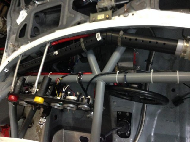

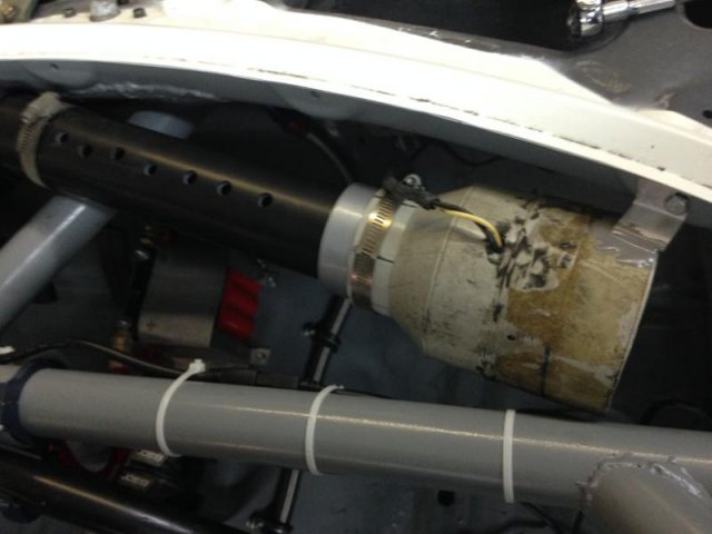

JMortensen Posted February 2, 2015 Share Posted February 2, 2015 Didn't want to run a heater core or the squirrel cage fan in this car, so I got a used NASCAR brake fan and some sprinkler pipe and made a crude defroster. I've got about $25 in the setup, weighs about 2 lbs and seems to blow pretty good. Thanks as always to tube80z for the idea. Quote Link to comment Share on other sites More sharing options...

tube80z Posted February 5, 2015 Share Posted February 5, 2015 Why not use the stock ducts and two truck-stop-special hair dryers? Might be even lighter... The advantage of this system is you can build it so one bolt holds it on. Then a quick disconnect on the fan motor and the entire unit can be removed. Cary Quote Link to comment Share on other sites More sharing options...
