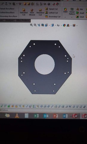

1969honda Posted June 19, 2017 Author Share Posted June 19, 2017 ...progress... Quote Link to comment Share on other sites More sharing options...

1969honda Posted January 19, 2018 Author Share Posted January 19, 2018 Not really, got side tracked with another project and life and military stuff. It's still a go, I've been working a little bit on some cad stuff with the transmission and bellhousing but nothing substantial. Quote Link to comment Share on other sites More sharing options...
