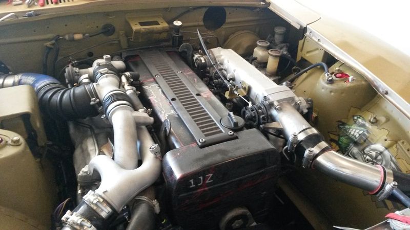

Geno750 Posted April 5, 2015 Author Share Posted April 5, 2015 where does the cx racing mounts place the motor? how low and how far back? how low is to low? I hope to have the answer to that question soon. I've been waiting on the 1JZ to 350z transmission adapter I ordered so I can place the engine in the car with the trans. Quote Link to comment Share on other sites More sharing options...
makaofox Posted April 7, 2015 Share Posted April 7, 2015 I don't have measurements but the cx racing doesn't set the motor as low or far back because it is using the stock mount locations. The lowest and furthest you could have brought was from beta motorsport. But cx racing isn't far off it wouldn't take much to push back and lower if you needed too. Quote Link to comment Share on other sites More sharing options...

Drift Boss Posted October 25, 2015 Share Posted October 25, 2015 I used cxracing. I just cut the own mount plates off the subframe, relocated them back where I wanted engine. Very simple. He is very right on the bolts. I currently have what I had in my garage thrown in. I need to run to ace hardware. As far as mounting to frame rail. I seen that go bad. Very bad. Quote Link to comment Share on other sites More sharing options...
