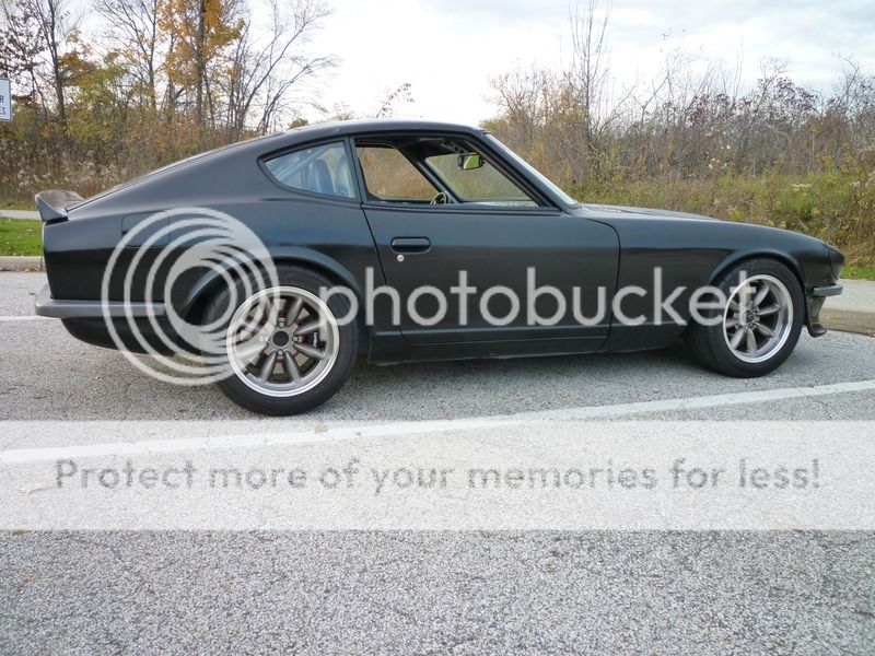

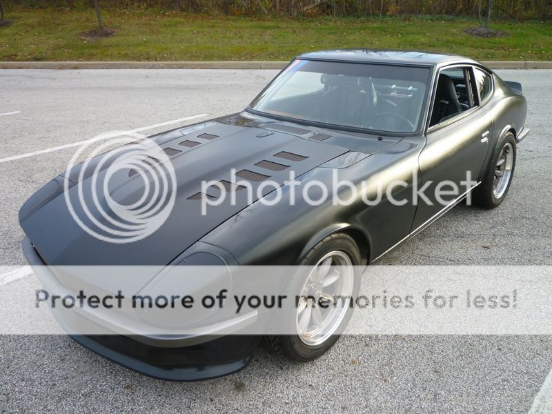

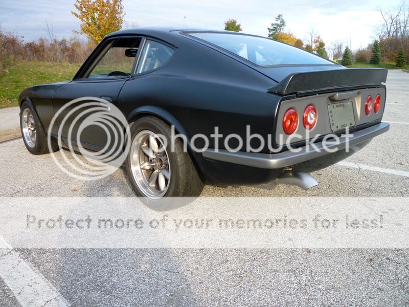

Zzeal Posted April 2, 2015 Share Posted April 2, 2015 Here's my 6+ year project, not finished, but finally on the road. It's a solid '73 from California, rattle canned black for now. I've been trying to decide on a paint, wrap, or "dipmycar" scheme. It has a stock LS2 and 6-spd. out of a GTO with a Speartech engine harness. I had a professional weld in an inconspicuous (as possible) full cage. I screwed around with the grill and tail lights, but otherwise it's a typical build, with JCI mounts / TTT suspension arms / Q45 diff. / Modern Motorsports axle stuff / Ariz. Z Car Wilwoods / Coilovers w/Bilstein's / 16 X 8 Rota RB-R's w/ 225/50 sticky Yoko's / Z28 Gas tank / Ron Francis wiring / Single 3" Burns Stainless muffler and Random Tech cats / Fire system… OK, those last two are not part of a typical build. All this stuff adds up to the most outrageously fun car I've ever owned. I knew 2400 pounds (1089 Kilo's) and 400 torques would be entertaining, but I underestimated the response, the thrust, the sound!…it's exhilarating!. I still climb out of the sucker with a big 'ol grin on my face. Please click on the link for many more photo's. http://s351.photobucket.com/user/oob-la-dee/library/1973%20Datsun%20Z?sort=6&page=1 The replacement grill was needed after doing some aero ducting to the rad. I blocked off air from under the bumper, behind the turn signals, and foamed the gap between the rad support and the bottom of the hood. I'm going to get into the taillight specifics in a separate "show your rear end" type thread. The ONLY way this successful build happened was because of this wonderful community- THANK YOU HYBRIDZ!!! Steve Quote Link to comment Share on other sites More sharing options...
