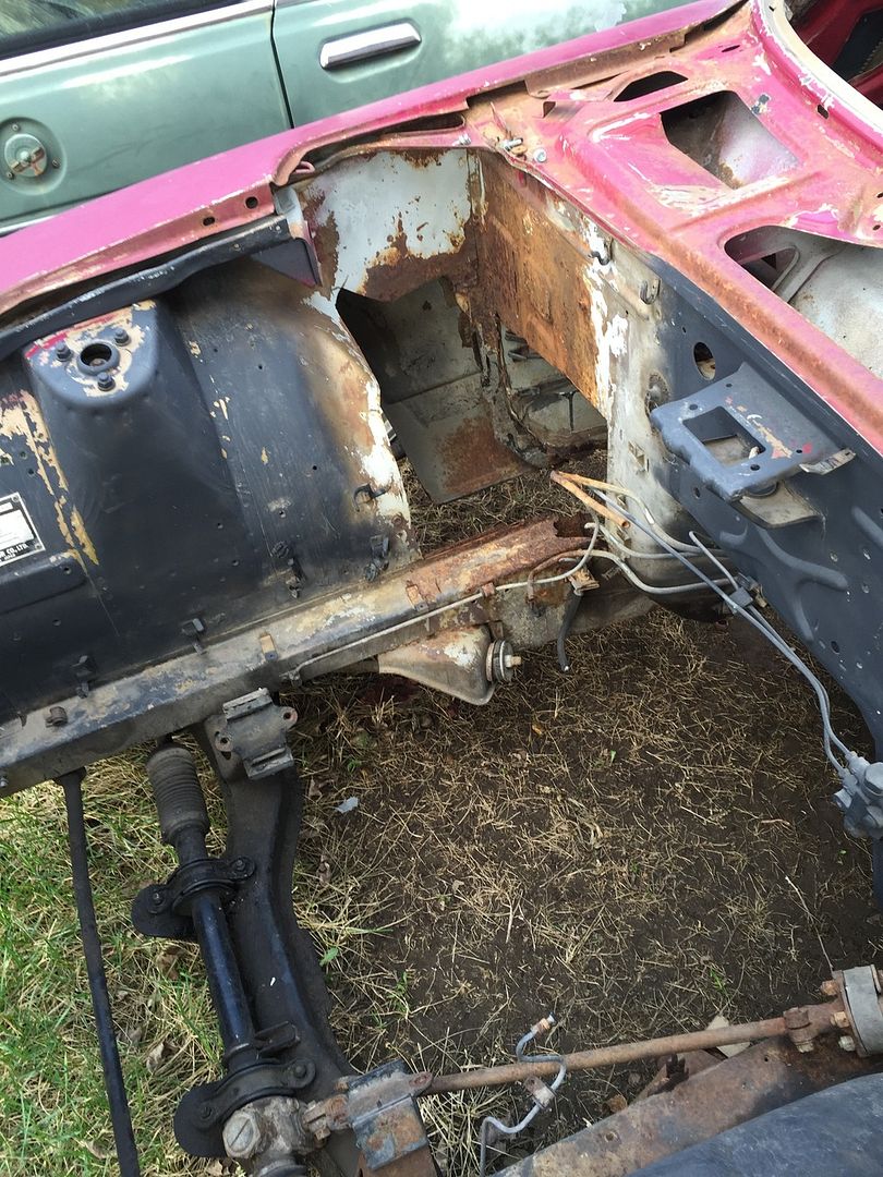

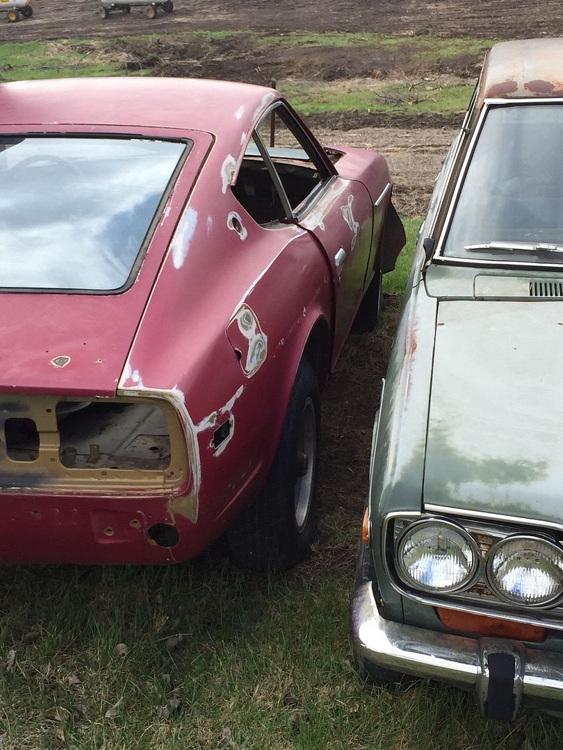

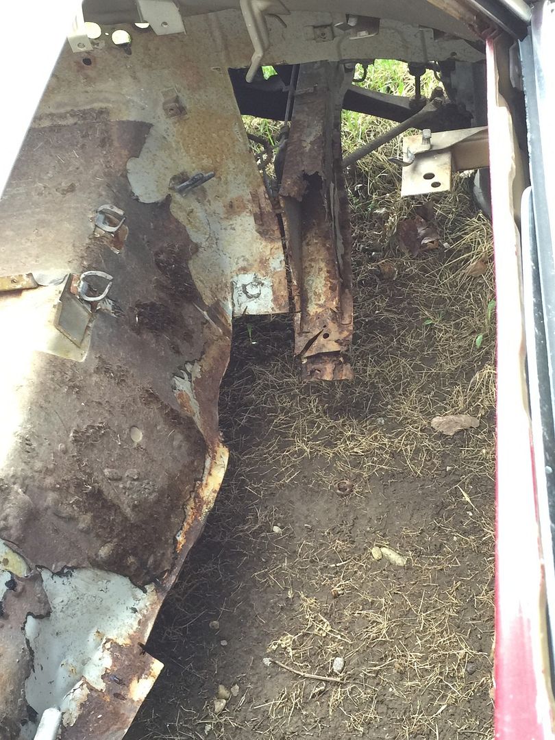

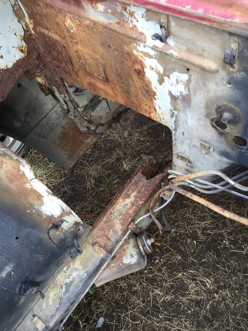

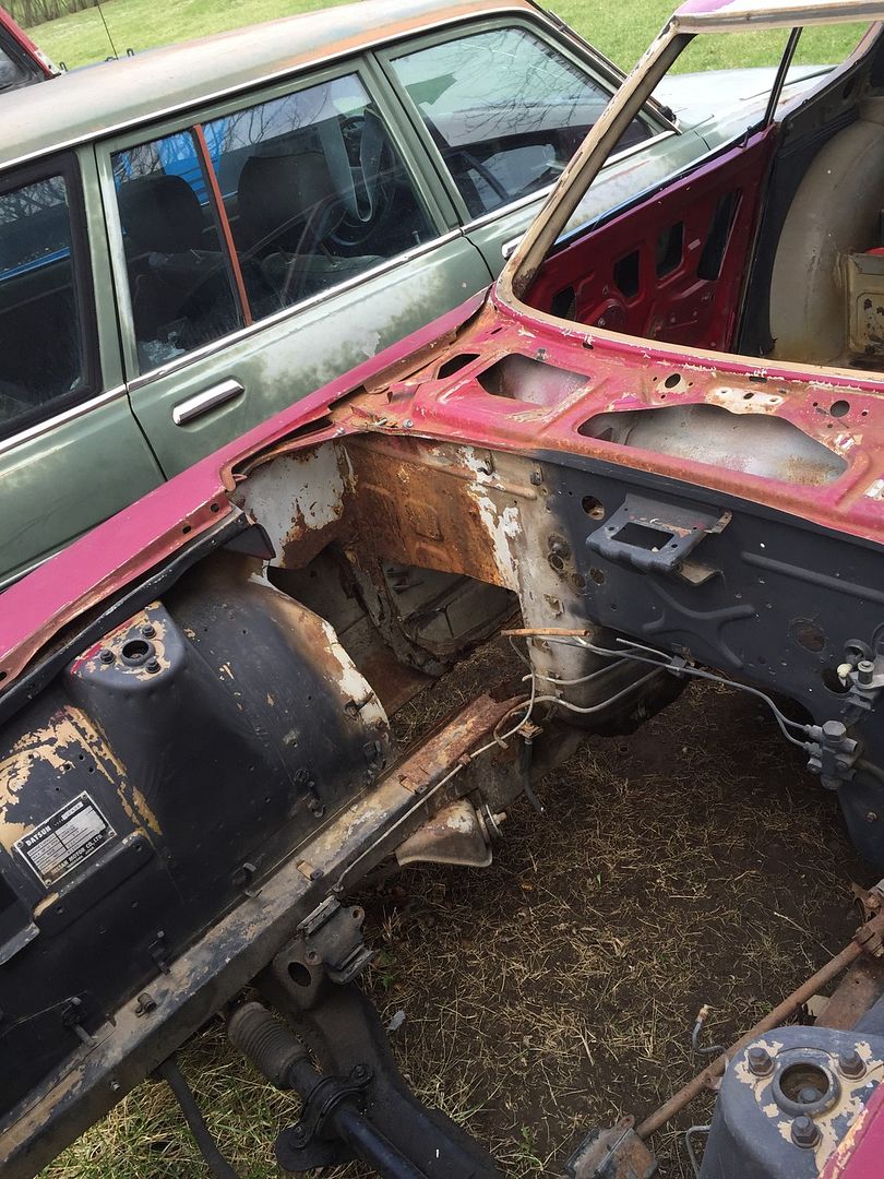

seanmac777 Posted April 8, 2015 Author Share Posted April 8, 2015 Engine bay pic Another Engine bay pic Close up showing the frame rail is rusting away from where it would have met the firewall interior, both floors are gone Passenger side floor/firewall Driver side Passenger side. (door does shut tightly and alignment all seems good on body) Quote Link to comment Share on other sites More sharing options...

seattlejester Posted April 9, 2015 Share Posted April 9, 2015 That would not be a good body. I think you may be thinking the panels are good, but that uni-body is pretty far gone. I don't think you will find many purist here, and especially with one so far gone, I doubt there is much outcry. A tube chassis with some of the panels on would be pretty neat. Although at that point it is going to be a pain to pass any type of certification to drive it on the road. If it is a track toy then might as well go with a full tube frame chassis with custom pickup points for whatever type of driveline/suspension you want to throw in it and then buy some fiberglass parts and graft on the rear fender and such. Much like project aardvark or the twin turbo z build on this forum (can not remember the builders name mark?) Quote Link to comment Share on other sites More sharing options...
rturbo 930 Posted April 9, 2015 Share Posted April 9, 2015 (edited) On 4/9/2015 at 8:24 PM, seattlejester said: That would not be a good body. I think you may be thinking the panels are good, but that uni-body is pretty far gone. It's nothing that hasn't been fixed many times before by members on here, and he welds for a living. For what he wants, I think the body is fine. Quote A tube chassis with some of the panels on would be pretty neat. Although at that point it is going to be a pain to pass any type of certification to drive it on the road. Do they check that sort of thing out there? I don't think they really bother out here, and NJ got rid of its safety inspection a few years ago. I don't really see that being an issue. I'm guessing Iowa isn't too strict on that sort of thing either. Edited April 9, 2015 by rturbo 930 Quote Link to comment Share on other sites More sharing options...
