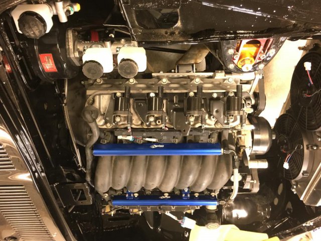

enforcercars Posted February 3, 2016 Share Posted February 3, 2016 (edited) Also, I looked at your photos of the motor mount position you used. Mine was basically reversed what you did, I have the second bolt from the firewall forward. I know that the ls1 has 6 bolts that can be used, but I used the 2 sets closed to the firewall like CX racing showed on their install video. Now Cx was using the last bolt hole not second, I bet that is why they tell you that you have to use a high mount alt bracket. Do you think your mounts being bolted forward will cause any issues, just curious. Edited February 3, 2016 by enforcercars Quote Link to comment Share on other sites More sharing options...
trackzpeed Posted February 3, 2016 Author Share Posted February 3, 2016 Not sure...,. I bolted it all up where it seemed to naturally land after numerous measurements and according to the fit on the trans brace. Cxr doesn't give any instructions so I just went with my gut after years of tinkering and racing cars. I'm happy with how it works as of now. It pretty close to firewall and it all sits behind the front axle..... A few more autoX races and I will check for stress issues along the way Jim Quote Link to comment Share on other sites More sharing options...
enforcercars Posted February 3, 2016 Share Posted February 3, 2016 (edited) Jim, thanks for getting back with me, I have studied your pics and mine, something is way different on my engine. I cant make mine bolt up like yours, it pulls the motor 4"s forward to the radiator. really looking at your pics vs mine, your mount is perfect on all most all 6 bolts. Man, I wonder what could be wrong with mine. I did the motor mounts just like yours Edited February 3, 2016 by enforcercars Quote Link to comment Share on other sites More sharing options...

trackzpeed Posted February 4, 2016 Author Share Posted February 4, 2016 Does this shot help. It's of the drivers side Quote Link to comment Share on other sites More sharing options...
enforcercars Posted February 4, 2016 Share Posted February 4, 2016 (edited) Ok, am i right?, we have the same bolting patten, it looks different than your last mount pics. Edited February 4, 2016 by enforcercars Quote Link to comment Share on other sites More sharing options...
trackzpeed Posted February 4, 2016 Author Share Posted February 4, 2016 Looking at your mounts..... Looks like same hole locations..... Not sure what the diff is? Keep at it my friend, you will figure it out. Your build looks great by the way. Feel free to keep asking questions. Jim Quote Link to comment Share on other sites More sharing options...
