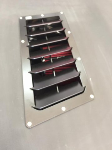

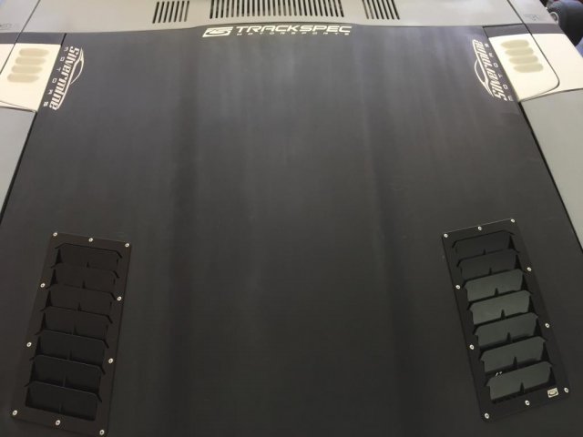

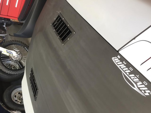

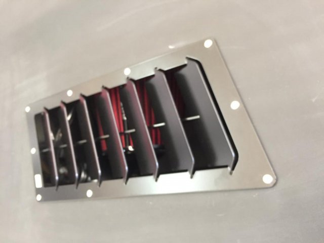

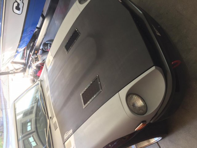

trackzpeed Posted June 24, 2017 Author Share Posted June 24, 2017 Installed a set of Trackspec hood vents. Car is running cooler even in 110 degree heat Quote Link to comment Share on other sites More sharing options...
alainburon Posted June 26, 2017 Share Posted June 26, 2017 Those look great, good choice. Quote Link to comment Share on other sites More sharing options...

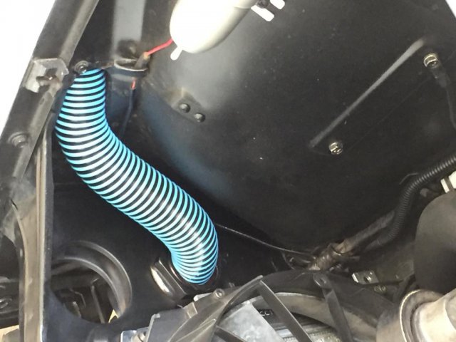

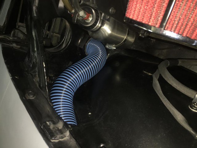

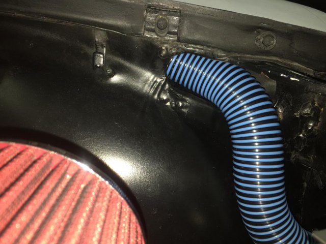

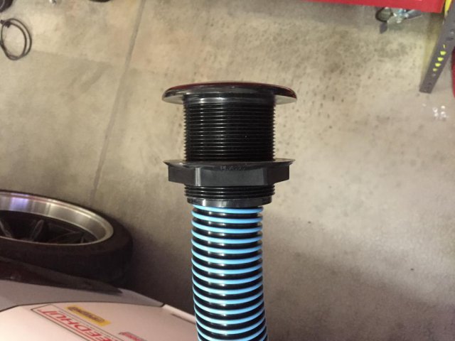

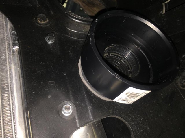

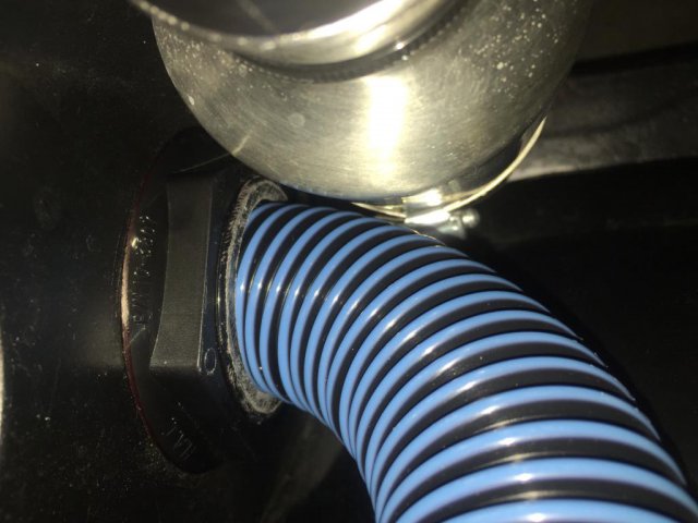

trackzpeed Posted June 29, 2017 Author Share Posted June 29, 2017 I'm working on a cold air intake, but didn't want to lose the fresh air venting. I used heavy duty 1 1/2 vacuum pipe Into a bulkhead fitting and some black ABS to create a ram funnel to re-route the "in" box. It turned out really clean and super functional. Now I have the upper 3.5 inch hole available to complete my CAI. Quote Link to comment Share on other sites More sharing options...

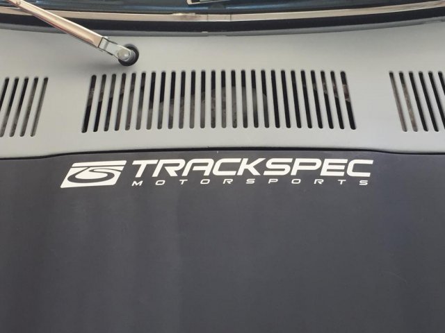

alainburon Posted June 30, 2017 Share Posted June 30, 2017 That looks really clean, I assume they only did these vents on the early model S30 because mine does not have that. Quote Link to comment Share on other sites More sharing options...
socorob Posted June 30, 2017 Share Posted June 30, 2017 The later Zs have a small hole in front of the frame horn, and the air goes through that into the vents under the dash that have the push/pull knobs to open and close. Someone told me if you leave those open, they help keep fumes coming into the car from the back, not sure if that's true though. Quote Link to comment Share on other sites More sharing options...
trackzpeed Posted June 30, 2017 Author Share Posted June 30, 2017 Matching set... Quote Link to comment Share on other sites More sharing options...

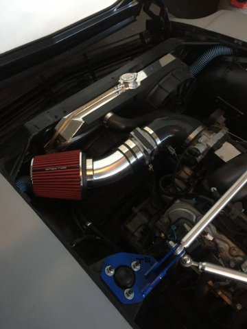

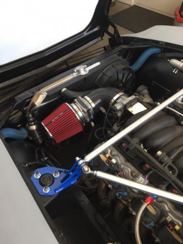

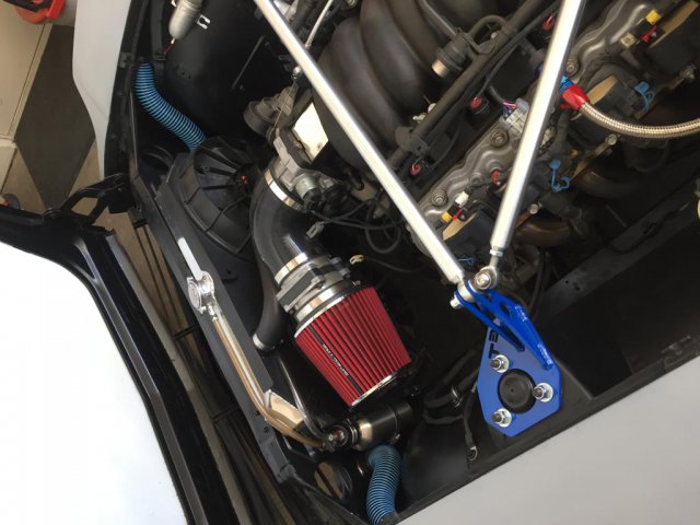

trackzpeed Posted July 7, 2017 Author Share Posted July 7, 2017 Cold air intake.... of sorts. I didn't want to cut up the bulkhead so I just ran the filter to the blast of air coming through the old fresh air vent location. Combined with the hood vents, I am getting a ton of cooler clean air to my intake now. Before and after pics. Jim Quote Link to comment Share on other sites More sharing options...
