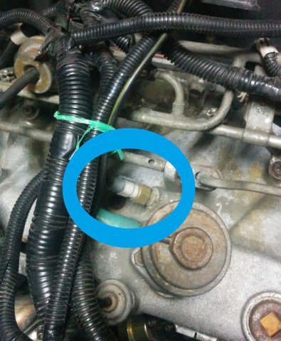

supernova_6969 Posted May 27, 2015 Share Posted May 27, 2015 (edited) Hi guys. I have a 1983 280zx, modified by the guy who sold it to me. Rebuilt engine, T3/T4 turbo, front mount intercooler, blow-off valve, megasquirt… The air filter was located behind the driver side headlight, which is good for protecting it from dust and rocks (and it gets fresh air through holes in the radiator mount for intercooler piping) but it breathes gross hot air when stopped or doing city driving (upwards from 120 degrees Farenheght)). See photo for details. It was supposed to need nothing but megasquirt tuning, but the more I play with it, the more I think there are other issues (I think not all the injectors work well amongst other things). I’m also new to the turbo thing, only having had stock NA engines before. The issue that brings me here today is that I am embarking on a cold air intake build (I plan on building a scoop that goes under the rad and maybe back up in front of it (no more room to go through the rad supports as the weird intercooler has both in and out on the same side, that side), with the filter in an isolated box between the rad and the engine. See upcoming post with air pressure and temperature tests...) and also am looking into isolating my intake piping (see other posts on that, with data too). I don’t want to build things that are useless, so I started taking data before so I can compare before and after. I’ve been measuring and comparing temperatures under various situations and came to the realisation that I might have a problem (not sure, thus the post). If I cruise on the highway at steady speed (say 75mph), I get steady temperature: today at ambient 82 degrees, I got 90 degrees at the air filter, and 120-130 degrees at the air intake temperature (AIT) sensor (I don’t actually know where the guy put that sensor. Any clues?). I’m not certain how good this is, but it does not seems too too bad (still not happy that I’m gaining 65-85 degrees WITH an intercooler under very little load and high air flow. Opinions?). The potential problem occurs as soon as I lift of the gas. If I lift off a little, say to slow down to 60mph(without de-clutching), the temperature climb real quick to 155-175 degrees AIT, while everything else stays the same (air filter temp, RPMs, air flow…). If I completely let go of the gas (without declutching), the AIT skyrockets to 190-215 degrees. In both cases, the temps stay high for a while and only then decrease slowly (unless I give it gas, at which point they go back down quick enough I guess). If I let go of the gas but immediately de-clutch and stay in neutral, the temperature goes up to 150-165, but then comes back down on its own quick enough. I thinking the really high temperature I see when I don’t de-clutch might be a combination of A) slower moving air that gets to take the time to absorb more heat and B ) the fact that, because the engine is working still, there is a significant amount of exhaust that might make the turbo work and thus heat up the air. But how come the intercooler wouldn’t be making up for that? So, is that temp spike normal(ish)? Should I be worried? Any explanations? Edited May 27, 2015 by supernova_6969 Quote Link to comment Share on other sites More sharing options...

supernova_6969 Posted May 29, 2015 Author Share Posted May 29, 2015 So I checked some things out and the only sensor that makes sense for the AIT sensor is this one: It's basically the only sensor anywhere on the intake, from filter to heads, si I'm guessing i'm right. the sensor is screwed in straight into the manifold, so heat probably does transfer and could explain part of the spike, but again, if that was the main cause, I'd have the exact same issue when I de-clutch... anyone else (with a turbo) get spikes in heat when they let the gas pedal go? if so, how high? Quote Link to comment Share on other sites More sharing options...
