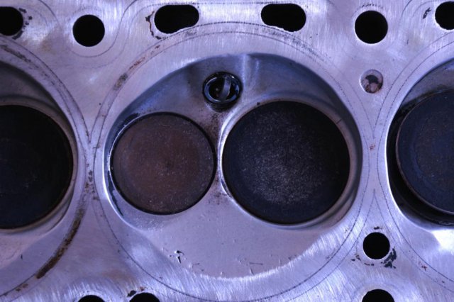

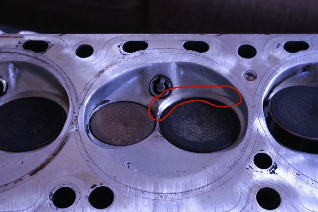

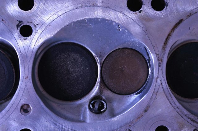

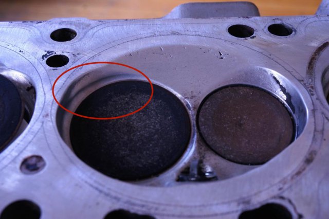

ryant67 Posted May 28, 2015 Share Posted May 28, 2015 (edited) Pulled this E31 off of my old stroker motor that I spun a bearing on. It's had a little work done, probably the better part of a couple of decades ago. No idea who did said work. It does have the larger L28 valve job done. Question is, what is the ideal for these heads when it comes to unshrouding valves? It looks like a decent bit of work has already been done, but I am questioning the areas highlighted and wondering if some simple touch up work that could better blend things could possibly improve flow further. Edited May 29, 2015 by ryant67 Quote Link to comment Share on other sites More sharing options...
JMortensen Posted May 29, 2015 Share Posted May 29, 2015 "Ideal" is a loaded term, but I notched or eyebrowed the block out to the headgasket (doesn't take much) and then put the same cut in the chamber so that there was a smooth transition from one to the other around the open valve. Don't take off enough metal to expose the top or bottom of the fire ring in the gasket. zredbaron's engine uses an E31 and he's documented quite a bit of it. Should be of some use. http://forums.hybridz.org/topic/24798-na-31lhead-camshaft-questions-no-shortcuts-max/ Quote Link to comment Share on other sites More sharing options...
ryant67 Posted May 29, 2015 Author Share Posted May 29, 2015 Agreed Jon, reckon I'll go ahead and change the title from "ideal headwork for E31" to "improving E31 flow". Less hyperbole is always better Yeah, there is still a little room left to open things up further. The heart shape could be smoothed a touch more in the process as well. I've read through Zredbaron's thread a few times now, it's loaded with great info. Only issue is almost all of the picture links are now broken... Were you running an e31, or was it a n42? I have an couple of old n42's laying here as well, so I might use one for practice before touching the e31. Quote Link to comment Share on other sites More sharing options...
madkaw Posted May 29, 2015 Share Posted May 29, 2015 Like Jon said, use the fire ring as a guide and give the valves some more room to breath. Looks like someone has taken a few thou off of there, might get it CC. Clean up the spark plug threads that are showing, make it all smooth with no sharp edges. Quote Link to comment Share on other sites More sharing options...

z-ya Posted June 23, 2015 Share Posted June 23, 2015 (edited) It looks like whoever did the work, did a decent job. You can unshroud more, but keep in mind that the largest bore gasket you can get is round 89mm, so have one on hand before doing anything. You don't want to unshroud into the gasket sealing area. My suggestion would be to unshroud to a Felpro gasket, which I believe is around 87mm. This way you can run inexpensive gaskets. I have two E31 heads, one an original Bob Sharp, another a reproduction I had done. Both require the use of an 89 mm MLS gasket. You can see the build I did here: http://forums.hybridz.org/topic/96584-road-race-enduro-l28-engine-build/page-8 Edited June 23, 2015 by z-ya Quote Link to comment Share on other sites More sharing options...
