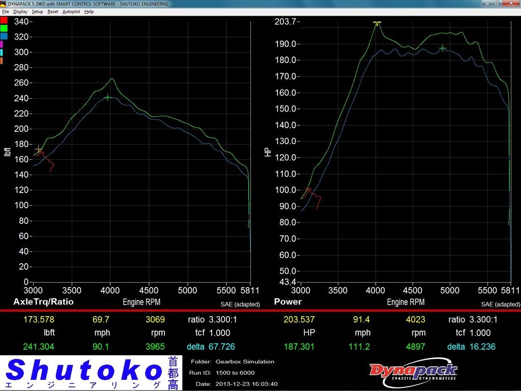

This is my first experience with a turbo charged engine  and the L28 and i was really unsure as to what to expect as a point of reference the tuned 350 Z's were producing 304 to 307 hp.
71' 240 Z, L28 280ZX turbo 5 speed drivetrain, with a Holley 4150 blowthrough , intercooled hybrid turbo 10lbs of boost with an internal wastegate. MSD 6 BTM with a 5,500 rpm limiter, locked distributor, aeromotive boost ref fuel regulator. petronix ignition. 92 octane gas.
Had the car for a year, bought as an abandoned project after being in storage for many years.
This was a test run to establish some sort of baseline figure, unfortunately the clutch was slipping badly under full load (smoke coming out of bellhousing, that's what happens when you teach a teenager to drive stick and SCCA autocross). It was a really hot day, my air intake is currently behind the radiator, and i had removed the turbo blanket to adjust wastegate linkage. Engine and oil temp 180. Engine runs rich at 11 to 1 off boost and 14 to 1 under full boost.

Definitely should have more. At 10lbs, you should be seeing 250HP depending on what turbo, what exhaust, and the tune. Stopping the pull at 5500RPM is DEFINITELY leaving power on the table, but if the clutch is slipping you know you've got work to do first.
It may have started slipping the clutch when you hit 200HP, after that it won't matter, the rest of your graph is meaningless.
Isn't it nice to find the limits of your driveline on the dyno?

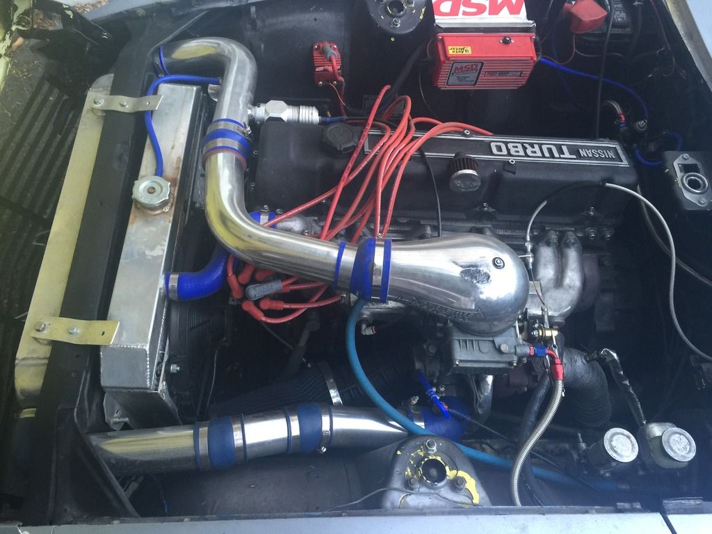

What intake are you using? Can you show pictures of the engine and your boost tubing in particular? Did you set it up yourself or have it done by a shop? Sorry for all the questions but it seems few and far between here for a blow thru setup like that and i will be building something similar with my atomic efi soon.

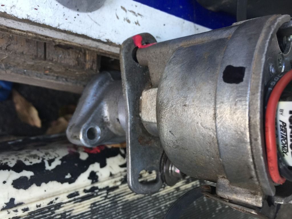

Before i start adjusting timing on my locked distributor , the clamp orientation shown in photo is not exactly factory and might have something to do with my timing readings of 42 degrees ?

Its an Arizona Z intake, but if i did not acquire the parts with the car I would not go the blowthrough route, especially after reading Maximum Boost. Intercooler piping was sourced from friends and online, I can't weld stainless steel , pipe was cut with the hose clamp method. Still need to move intake to in front of radiator.
Did you check that the timing tab on the timing cover lines with TDC mark on the damper when the engine is at TDC on cylinder #1? Just bolting the tab on the cover doesn't ensure this. You can use a piston stop to find exactly TDC.
As far as the timing adjustment, you may need to drop the oil pump and rotate the distributor shaft to get the timing adjustment correct. Are you using a locked L28 distributor?
You need to set the static timing. Rotate the engine so that that it is in the middle of the timing adjustment range you would like. So if you would like to adjust between 20 and 30 degrees, put the engine at 25. Then rotate the distributor so that it is in the middle of the adjustment range. Pull the distributor cap and verify that the rotor is pointing at the #1 plug wire in the cap. If it isn't, then you need to drop the oil pump and rotate the shaft in the correct  direction. You don't need to drop the pump all the way, just far enough that you can rotate the distributor shaft with a set of needle nose. You may have to do this a couple times before you get the rotor close. Then pull the rotor and look at the reluctor wheel, it should be aligned to the mag pickup. If not, then adjust the distributor so that it does. The start the engine and check the timing with a light and adjust dynamically.

Please do the checks for your timing and timing tab. Reset the distributor as was mentioned earlier. 42 degrees is way high when your in boost above 3,000rpm. Since your using a locked distributor I would set it to 17 - 20 degrees and leave it there.
